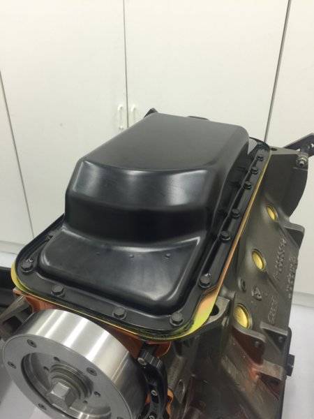

Update on my build. The pickup we used is a P4529567. It IS NOT a Plug & Play Fit. It needs modification to work in this install...
Tell me more. I'm needing that pan with the taypered rear section.
I'll have to update you when I get more info myself. The builder is a Journeyman Engine Tech, that has been doing this for his career. I'm sure he'll have pics, and details of this op. I will pass those on to you when available...
Any updates on these pans and oil pick up ? I am ready to buy
Vans has pan for 300.00 and pick-up is 90.00
It's 3/8 and they fit great. Joe Suchy sell them also
They are correct for max wedge clone. I have it on a 440 block
And do not have to notch or cut cross member
