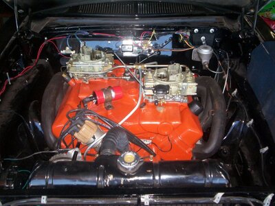

Here's a pic of mine I was originally going to use max wedge heads but it turned out they were cracked so I ran a 500 with eddy victor max heads a stage 2 manifold and 2 holley 600 instead of carters repro max exhaust and TTI max wedge exhaust 3200 stall converter 4.30 sure grip with cheater slicks ran really well and turned many a head and grew crowds of old guys when I went to car shows
Wow squid, that is Mopar Heaven!

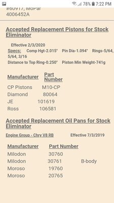

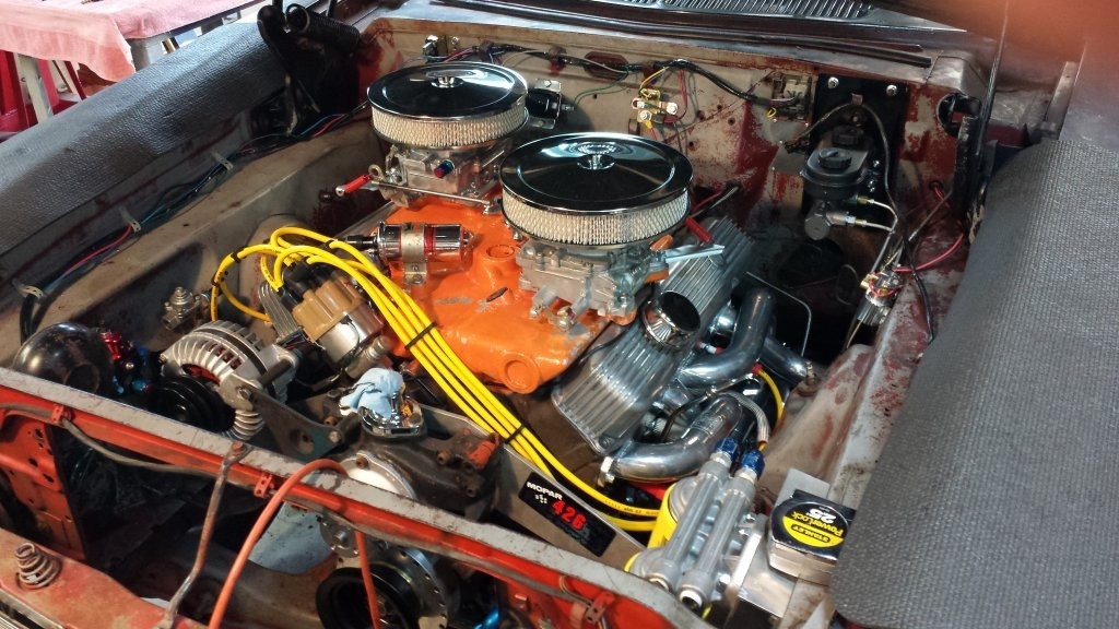

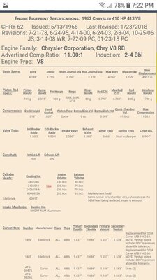

carrillo rods n pistons make a 426 piston and race tec can make any size piston you can buy rings for . oh ya we ran 660 center squirters on my stage 2 package , and plan on running afb's on the 4spd car . i've got the correct plugs and nos linkage for the carter afb setup . happydayz is the auto 63 .
as you can see by my avatar photo I id the same ran twin holleys worked really well had a guy named rick walker do them very smart guy when it comes to carbs
carrillo rods n pistons make a 426 piston and race tec can make any size piston you can buy rings for . oh ya we ran 660 center squirters on my stage 2 package , and plan on running afb's on the 4spd car . i've got the correct plugs and nos linkage for the carter afb setup . happydayz is the auto 63 .View attachment 1038376 View attachment 1038378 View attachment 1038370 View attachment 1038371
Looks like the 4.1875 bore for a 413, is the same as a 401 buick, or a 428 pontiac. Rings shouldn't be a problem.
