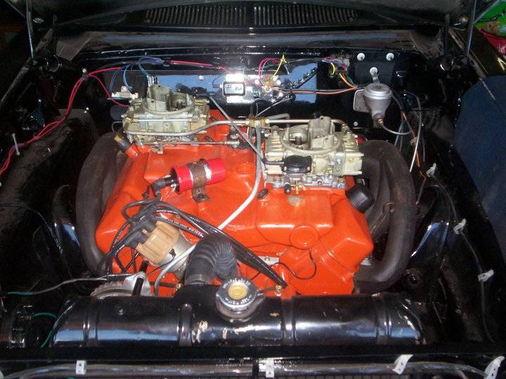

  5. moparsquid
    moparsquid FBBO Gold Member FBBO Gold Member
    Messages:
    341
    Likes Received:
    138
    Joined:
    Sep 9, 2010
    Location:
    spring valley ,ca.
    Local Time:
    11:01 AM
    Here's a pic of mine I was originally going to use max wedge heads but it turned out they were cracked so I ran a 500 with eddy victor max heads a stage 2 manifold and 2 holley 600 instead of carters repro max exhaust and TTI max wedge exhaust 3200 stall converter 4.30 sure grip with cheater slicks ran really well and turned many a head and grew crowds of old guys when I went to car shows
  6. PolyJon
    PolyJon Active Member
    Messages:
    43
    Likes Received:
    20
    Joined:
    Jan 14, 2016
    Location:
    Sheppey
    Local Time:
    1:01 PM
    Wow squid, that is Mopar Heaven!
    I had the same plan myself and bought the Eddy MW heads but lucked into some real nice 62 heads.
    The factory intakes had many gremlins I hear, but outta my price range anyways, so got a modern Indy slab!

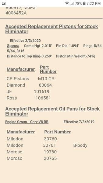

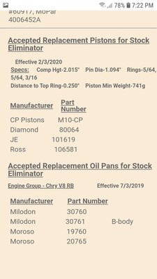

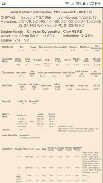

      • 4spphil
        4spphil Active Member
        Messages:
        44
        Likes Received:
        42
        Joined:
        Dec 6, 2018
        Location:
        Iowa
        Local Time:
        1:01 PM
        Up to date list of 62 413/410hp nhra accepted stock pistons. Not sure on availability. Screenshot_20201210-192212_Samsung Internet.jpg Screenshot_20201210-192250_Samsung Internet.jpg
        • Like Like x 1
        • Agree Agree x 1

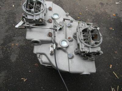

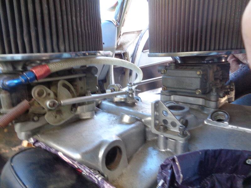

        • POMONAMISSEL
          POMONAMISSEL Well-Known Member
          Messages:
          1,423
          Likes Received:
          1932
          Joined:
          Apr 29, 2017
          Location:
          san jose ca 95126
          Local Time:
          11:01 AM
          carrillo rods n pistons make a 426 piston and race tec can make any size piston you can buy rings for . oh ya we ran 660 center squirters on my stage 2 package , and plan on running afb's on the 4spd car . i've got the correct plugs and nos linkage for the carter afb setup . happydayz is the auto 63 . Fury.png DCP01160.JPG DSC00979.JPG 887891-1adf459f827d7d82148e3713ead280d4.jpg
          • Like Like x 2
