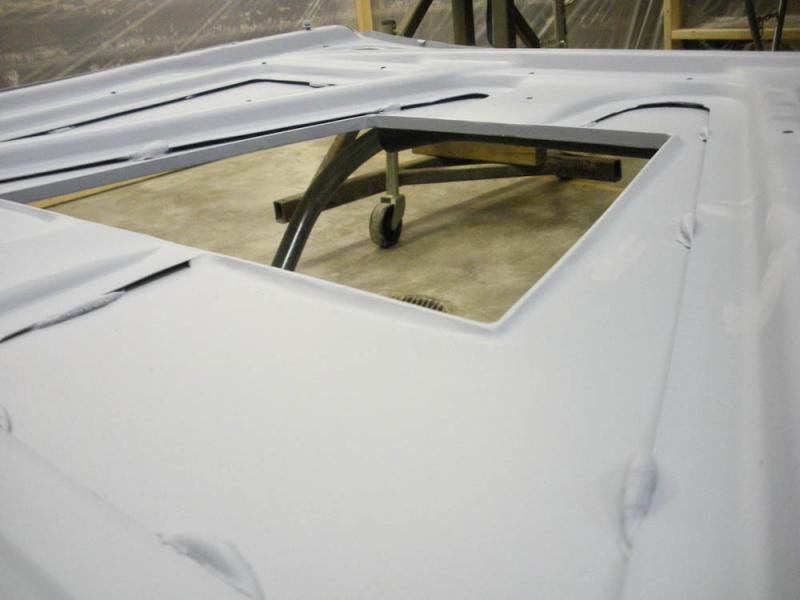

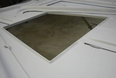

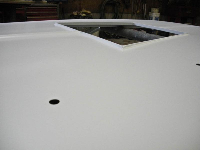

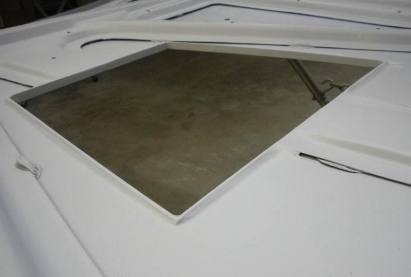

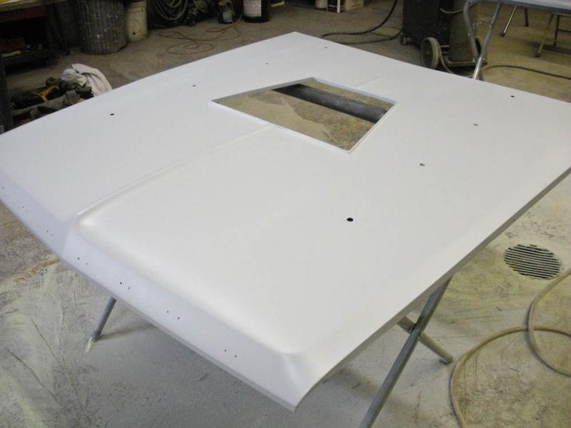

Here is what i did. I made a small lip. same with the under side. then the center frame is sloped into this lip.

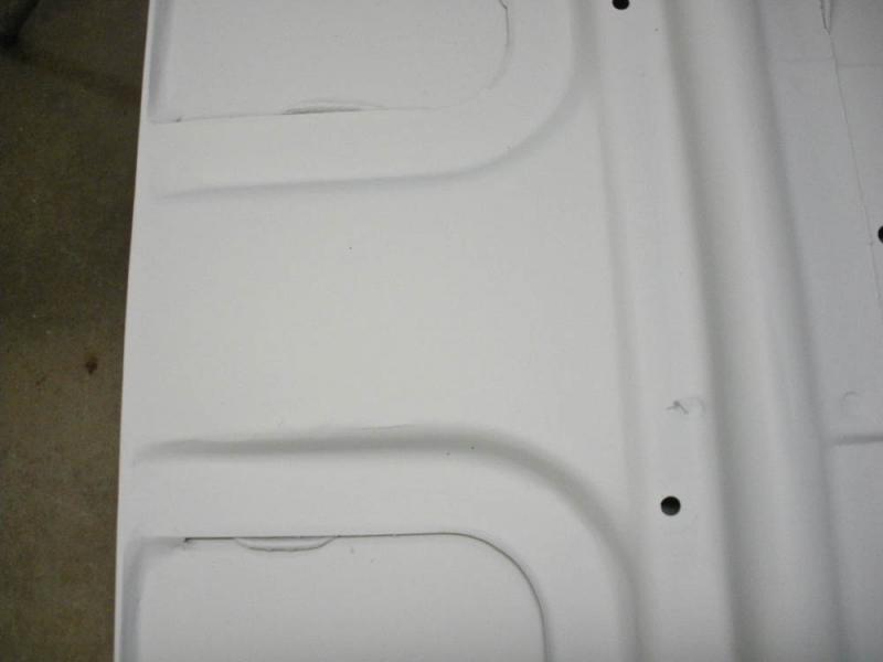

Thanks. Is that a steel hood, got a pic of underside

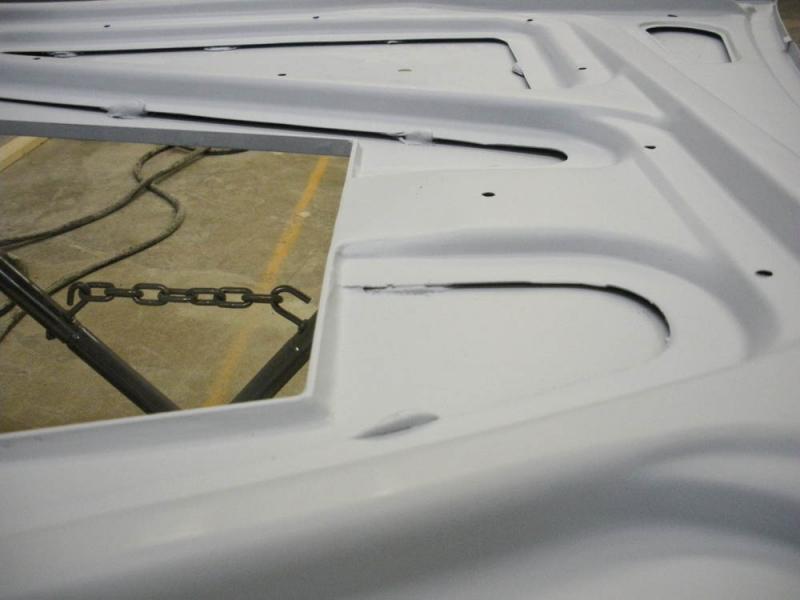

Its a Steel hood. I will get pix of the under side this weekend if you can wait.
Thanks that would be great
That is a nice solid job, looks great and thanks for the pics, Terry

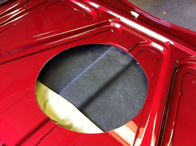

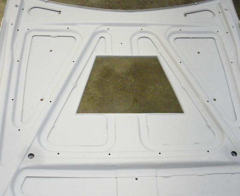

Heres the bottom side of one I just finished up. I dont have any pics of the top yet. This car will just have the std 14" air cleaner.
In the future if it is changed to a crossram I'll make a flate "air pan" that fits to the bottom of the hood and openings for the carbs like the factory did. This came out pretty good though.

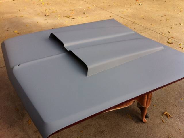

Top pic of the one above.
For the bolts I use body hardware I get at the local body shop. Napa also sells small bags or misc. boxes of similar things. I think Balkamp is one of the names and of course Gardner-Westcott.
I used a small number 10 bolt and speed nut assembly. I like them because the head on the bolt is very small but they use a big thick washer and look like something the factory would use rather than a hardware bolt and often thin body washer.
