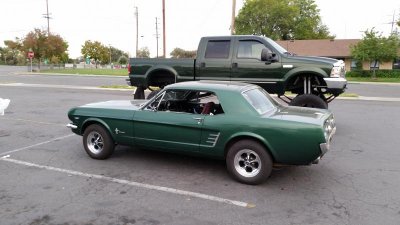

My Grandparents bought a 66 mustang brand new. Grandma drove it.
She only went to 3 places. 1 hospital, where she worked 1.5 miles away. 2 grocery store, 1 mi. Away. 3 my uncle-cousins house 3.5 miles away.
By 1986 she only had 60,000 miles on it. Car ran good and looked good! My Grandparents did keep the oil changed but still, the engine NEVER reached operating temp on her drives. So mayonaise in the crank case. They rebuilt the motor due to the goo in crank case. I still have the car. Mayo was due to condensation never evaporating off from normal engine temps.
