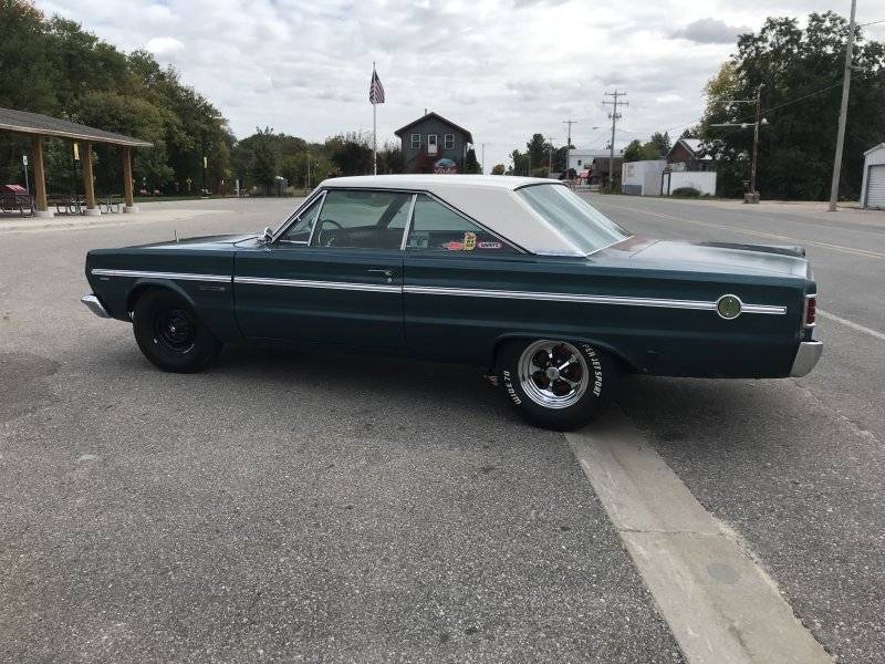

I’m using I custom grind Mr. Six Pack Cam ground by Engle with NOS Johnson hydraulic lifters and vintage 1967 915 heads with street hemi valve springs I can’t wait to drop the hammer on the 383 !!!!
Like this..
This car is just awesome and takes me back to a time when it was OK to just have fun and try to scrape up some cash for the next upgrade over the weekend. Thank you for your time and effort to post pictures and updates on your project. B bodies rock and you will get lots of smiles cruising around in this time capsule.
Thank you I appreciate it this car is a Time Machine for sure .

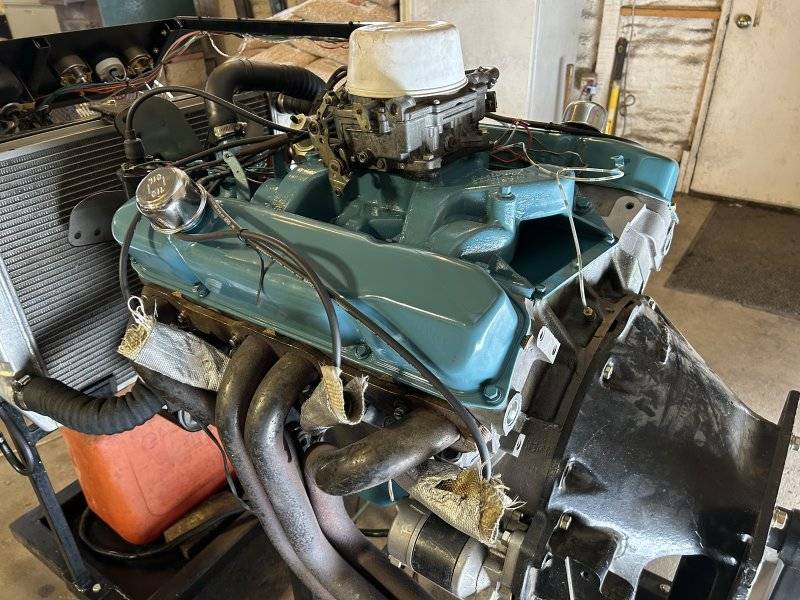

Ok so the next step is I’m going to rebuild the engine and see if I can get this thing to go faster I’m not doing a stoker or anything like that no MSD box I’m going old school factory parts I will balance and blueprint but no aftermarket carburetor or intake let’s see what a stock appearing car can do.
I'm going to be doing some mods to my engine as well after I get my racecar up and running. The car was originally my Dad's, he bought it in 1976, he restomoded it and rebuilt the engine. It's stock with '62 heads, stock 440 cam, iron intake and '69 HP manifolds. It runs great but is a pig out of the hole. I'm going to pull it, reseal it, install a Comp 280H cam, advance 4 degrees, a DP4B intake and block the exhaust crossovers. I may even put 440 Source heads on it (if I can find a good deal on a set) and switching out the stock 12inch converter for a 1800-2000 stall unit. it should sound and run pretty good . . .

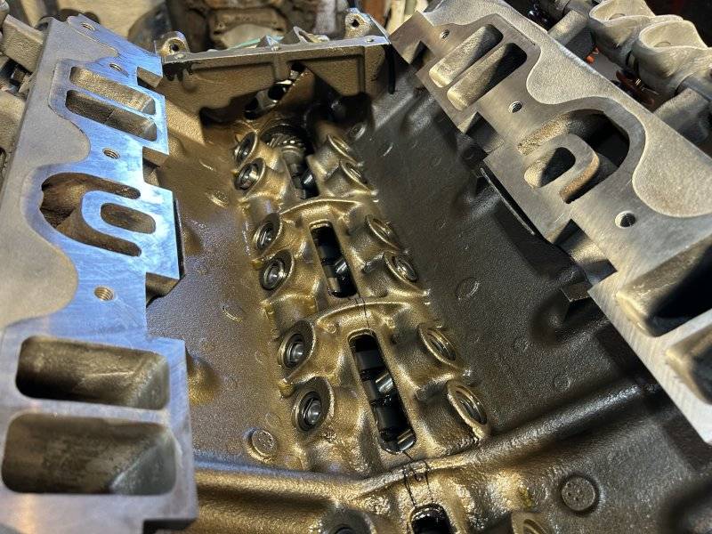

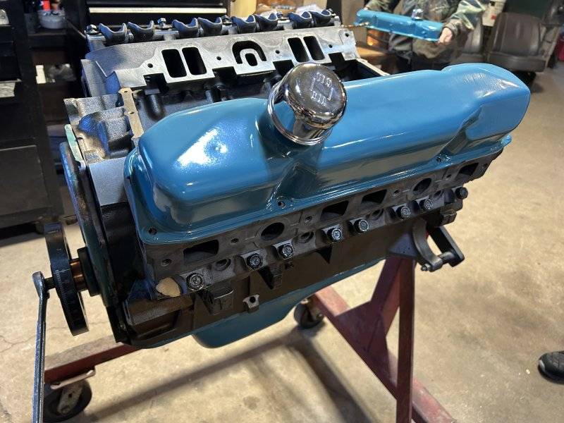

The engine is done did the break in and everything went smoothly no leaks . Sounds like a beast next step is to put the Hemi valve springs in we used weak springs for the break in and no worries with the American Made NOS Johnson Lifters that our speed shop sells “Big Bills “ has only the best…
Thanks but we are not done still need to do some paint work and put some other goodies on stay tuned ….."…
The engine is done changed out the break in springs have the Hemi ones installed at the correct height , had to do a little shimming but they are all real close to each other intake is 1.875 exhaust is 1.868 . Now Finnish painting the block and install in the car stay tuned…..

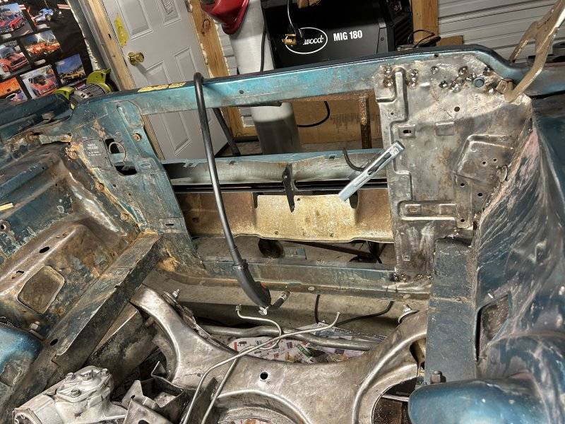

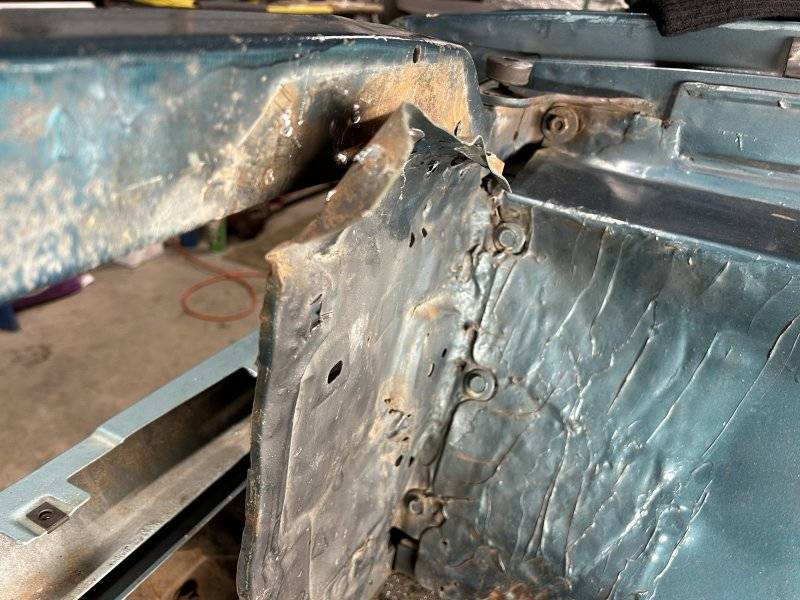

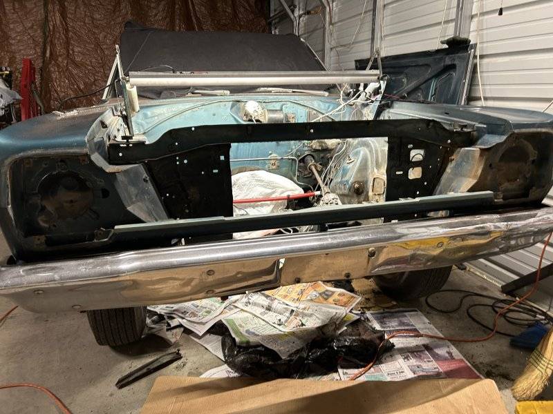

I guess I’m going to try and repair this mess the car was wrecked at one point out running the cops after robbing a Liquor store .
