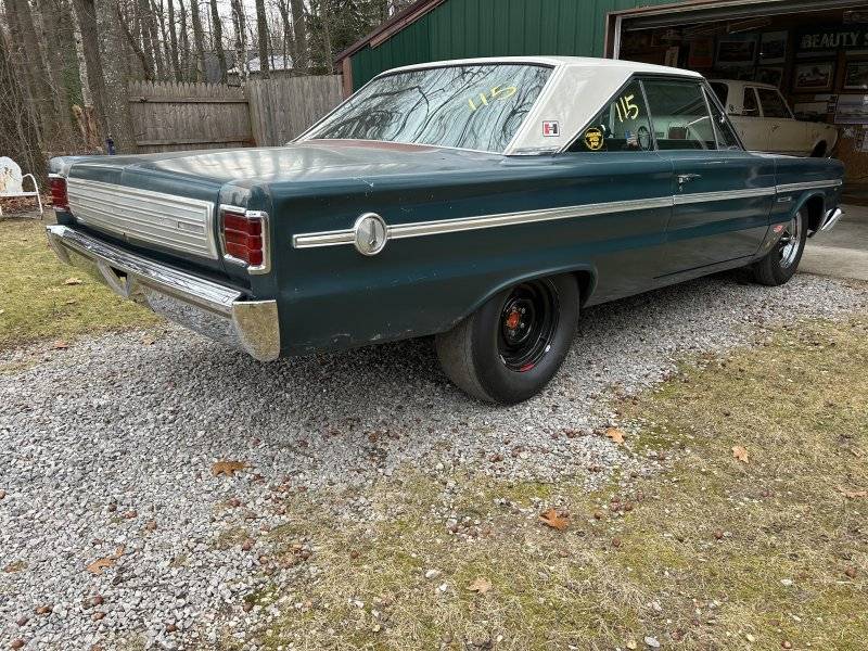

Mean Green the Time Machine

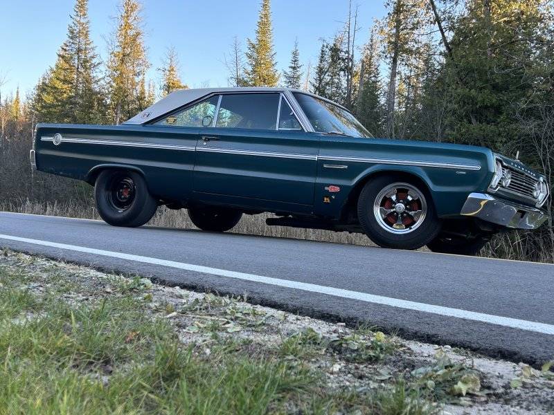

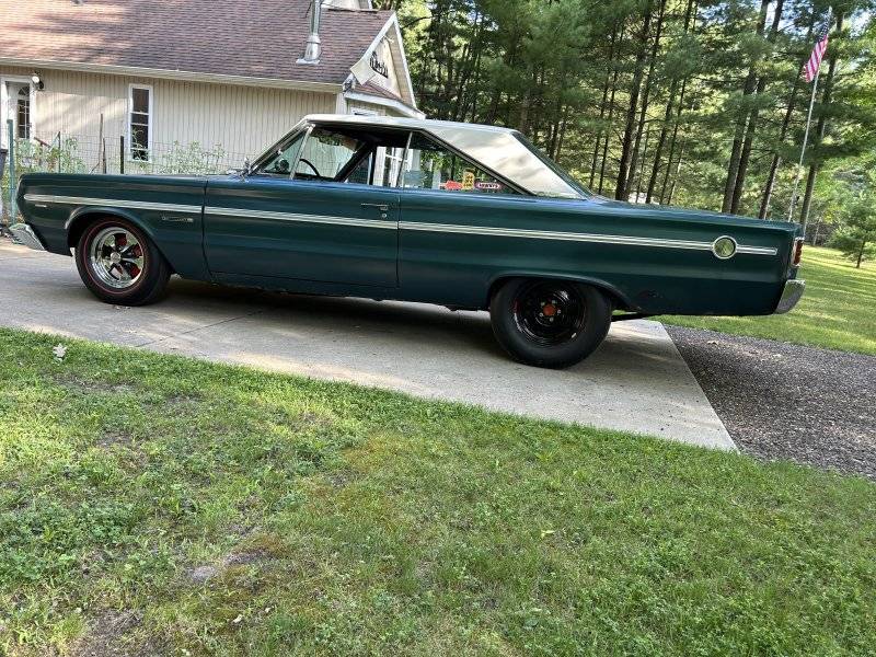

Getting close to putting it away for winter. We have a Few tricks in the works for this winter.

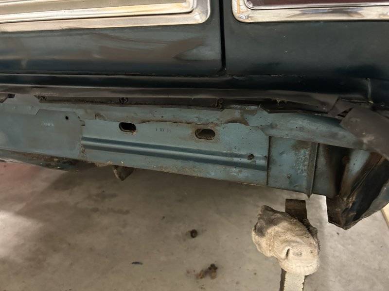

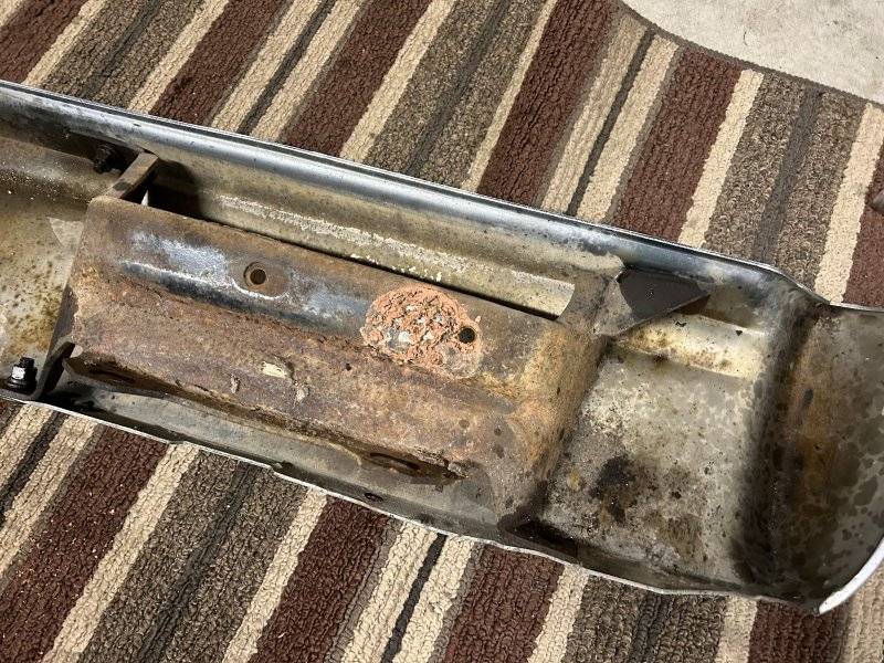

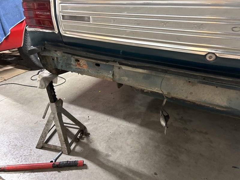

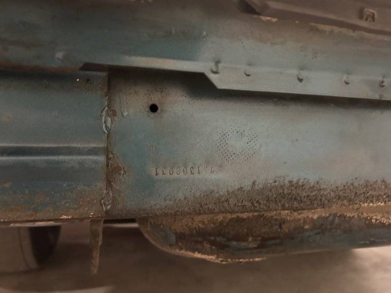

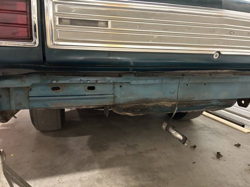

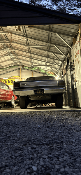

Today I put a new rear bumper on and got a pic of the s o number on the rear . The red on the bracket is mud wasps nest.

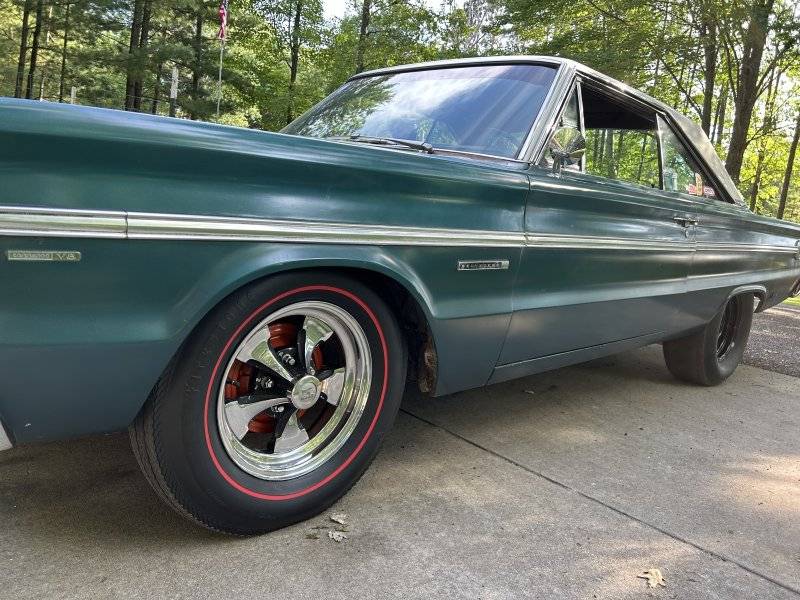

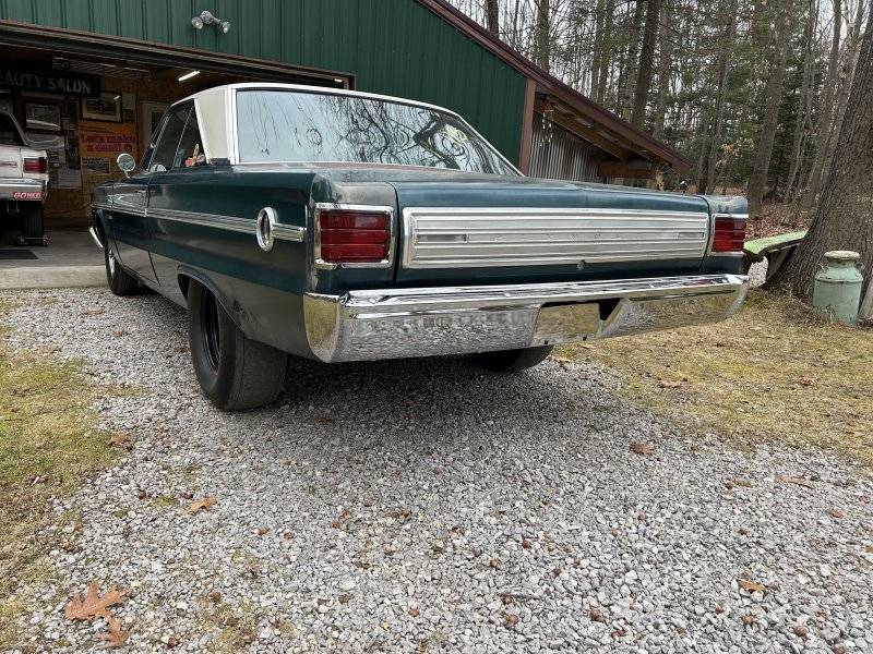

My bad, driving mine sooner than later, see I told you I enjoy seeing pic of Green Machine!
Post a pic I would love to see it and thank you i enjoy theses cars and talking to people about them .

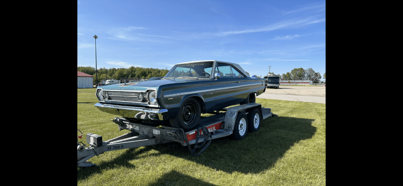

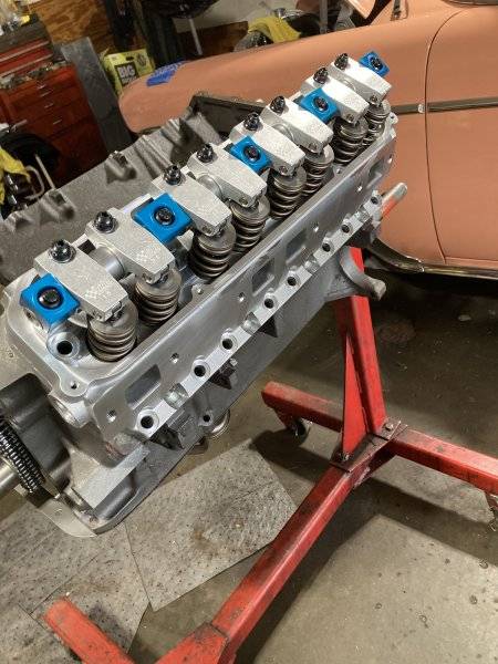

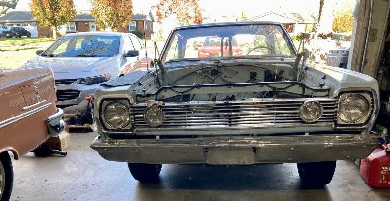

Bought the car in February, had small engine fire, soot was everywhere. Factory BB car, 361. Haven’t had a Plymouth since 1989-90. Beginning intentions was to get car mechanically reliable, rebuild front & rear suspension. That all changed when the 361, developed a burnt valve, less than 150 miles. From there the car has been a case study, lol. Front suspension done. A 400 engine almost done. Pulled trans out two weekends ago. Like you, the car is put up for winter, logistics is the cause for that. I don’t have many pictures of car.

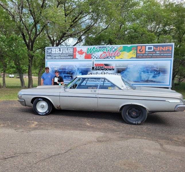

64 polara stock, 3.91/ now 4.56
12.50s 106.5

That is very impressive times I really love your 64 dodge you should post more pics of it on here .
