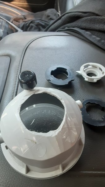

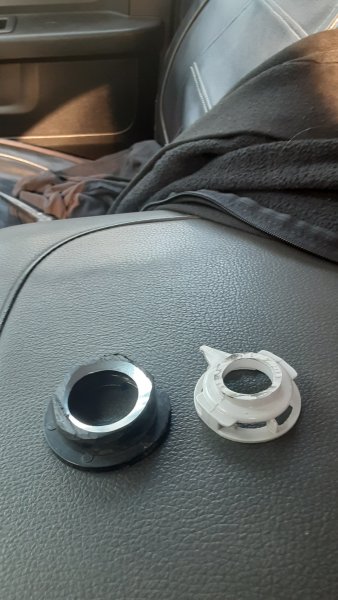

I cut the fog light socket off with a cutout whee,as close to the light bezel as possible. Do not discard the cut off sockets. They get glued into the center headlight pods to receive the fog light bulbs and sockets. Then the Dodge truck sockets get glued into the fog light pods after the holes are opened up wide enough to recieve them. Extend the wires as needed,job done.

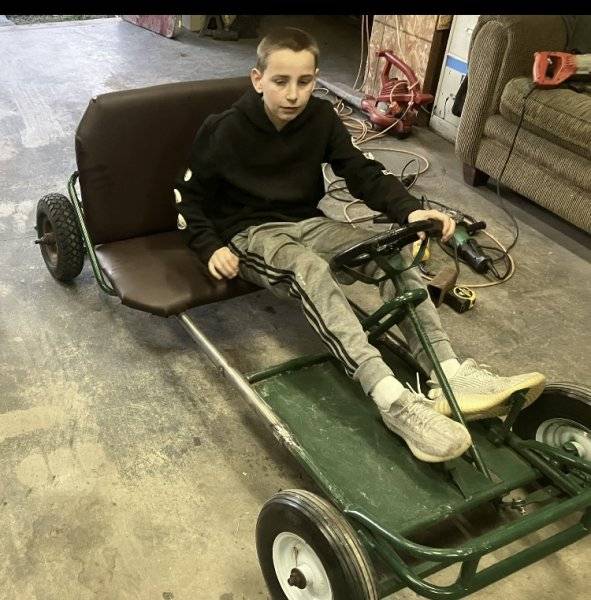

Just this year I have been helping my nephew build a go cart, rebuilt two engines for two Darts, swapped back to a front mounted battery while switching to a 7 lb lithium unit and more…

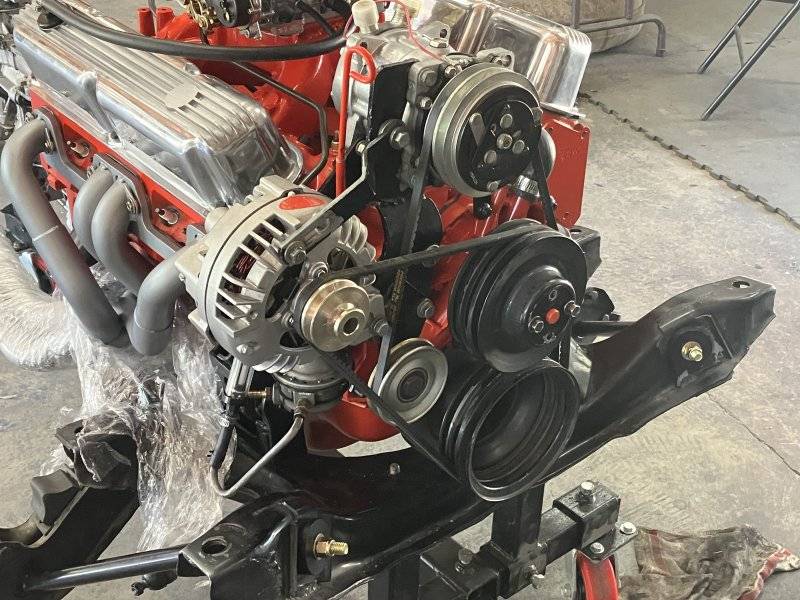

360 build…

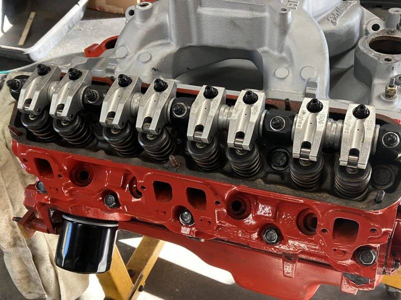

408 build…

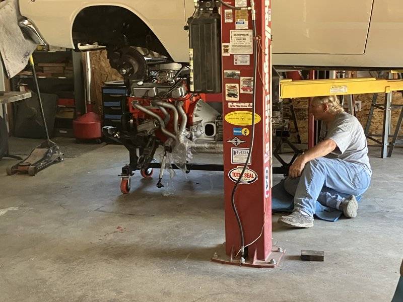

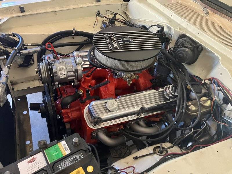

Installation after engine rebuild, new clutch, torsion bars, PST UCAs, strut rods…

360 build…
408 build…

The fog light housings are now converted. Have to glue all four pieces and let them dry completely, then modify the wiring to finish the job. Soon I will be rolling 1970 style in my modern Challenger.
