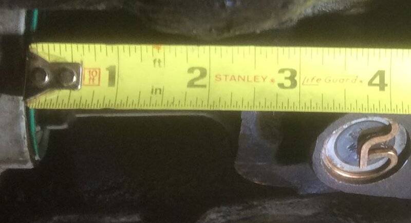

Howdy,
So I need a new driveshaft and I've read around about pushing the yoke in all the way and pulling out an inch. I can't bottom mine. I noticed some folks have a yoke seal that's about flush with the end of the tailshaft, but mine protrudes about an inch and starts to squish before I hit anything. Am I going to need to pull the seal to measure then replace? Or is there a distance from end of tailshaft to flat surface of yoke that works? Before I started I notice that the yoke already stuck out from the seal about 2 inches which could explain my death wobble at about 70mph.

I just had one made for me as I didn't have one. The guys at A-1 driveshaft in Baltimore made it. They told me to push the trans yoke all the way in and measure from the CL of the axle yoke to the CL of the trans yoke.
Did that and brought them the trans yoke couple days it was done.

If I understand your question, you measure from the end of the tailshaft to the bottom of the U-joint sadel. The seal doesn't matter.
That tool is to pull the bushing without removing the tailshaft the installation tool is the smaller piece . Had a driveshaft that was to short, rattled at 3200 rpm and up. Picture 2 this is my car with weight on rear end. The trans shaft sticks out 1"or 1 1/8" from tailshaft with no seal. If you change bushing it needs to be in the right position for lubrication.
There are different yokes for a 727 with different length snouts that slide into the trans. You need to use the one that will go on the new driveshaft. The large dust cover usually compresses enough to get that measurement, if not, consider replacing the dust boot/seal.

The instructions on the Doctor Diff site are to measure from the Center line of the rear pinion yoke to the transmission housing
and then to measure from the transmission housing to see how far the shaft stands out from the Transmission
The end result fit wonderfully (even with my over thinking it)
From the Doctor Diff website:
Please provide the following dimensions. Vehicle's full weight must be resting on it's suspension while measuring.
A. Measure from the center of the rear U-joint to the end of the transmission tail-housing (A dimension, Figure 1)
B. Measure from the end of the transmission tail-housing to the end of the output shaft (B dimension, Figure 1)
