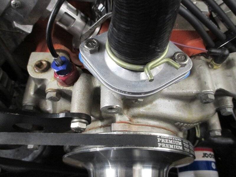

Picture of your temp probe in the motor might help

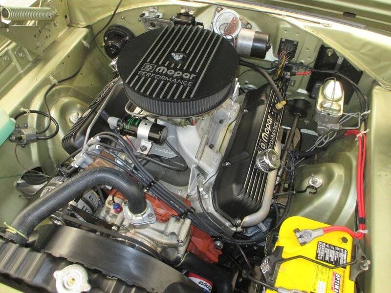

I provided a picture which shows the cable and probe on water pump housing passenger side and factory sender and wire on driver side.
Ron
I see a picture of a very nice engine bay but how about a close up of the temp probe.
As in; it looks like the probe might not be in the coolant passage properly.
Are you sure with that fitting the probe is not in an air pocket?

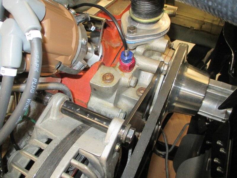

Close-up of the red bushing Auto Meter provides with the gauge and the probe. This is how Previous owner installed and i just followed suit when I replaced the gauge.
Is this not how it's supposed to be???? Explain.

My concern was that the temp probe wasn't far enough in the coolant port, and maybe hiding an air bubble in it.
You could try loosening the the probe until coolant leaks out and then tightening up.

The other day when I swapped the stat. I took a real good look at the probe to make sure it was in all the way or not too much and bottoming but all seems correct. The red bushing will only go so far into the housing and then the probe goes into it and seats nicely.
Your idea about backing the probe out a little (basically burping the system) is a good one incase air pocket is there in the corner of housing. I'm working on the rearend right now so once that's done I'll have the nipples to test
