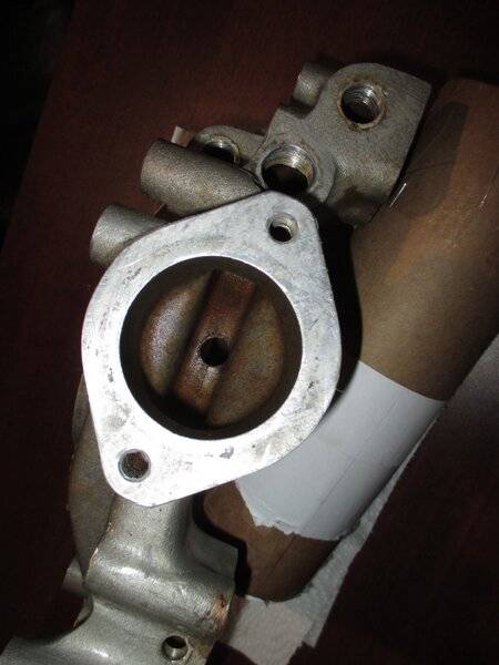

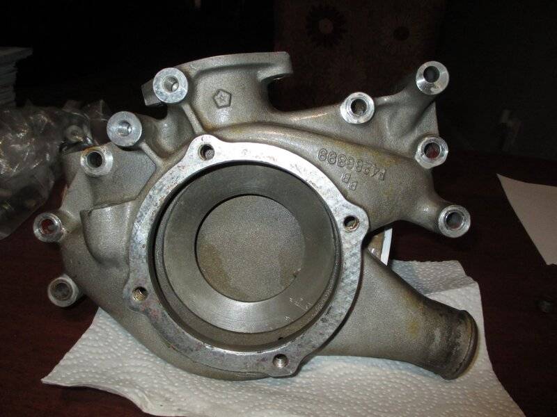

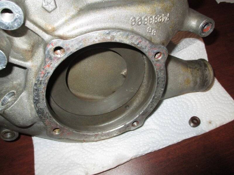

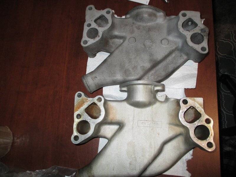

I took all the accessories off the engine to paint it and in doing so I decided to take the water pump housing off and the pump and thermostat off of it.
I found this "TRICK of the WEEK" under my thermostat:
1st. pic is a stock cast iron with factory hole.
2nd.pic. shows the aluminum Mopar Performance housing I'm using.
3rd. pic. shows the aluminum housing with the plug out of the hole.
4th. picture shows the housing with little metal plug sitting next to it.
Why would anyone plug the hole under the thermostat??? Where does that hole lead? I'm now 99% sure this was the cause of that hot-spot I had in the right corner of the W.P. housing.
Any thoughts theories??
Thanks Ron

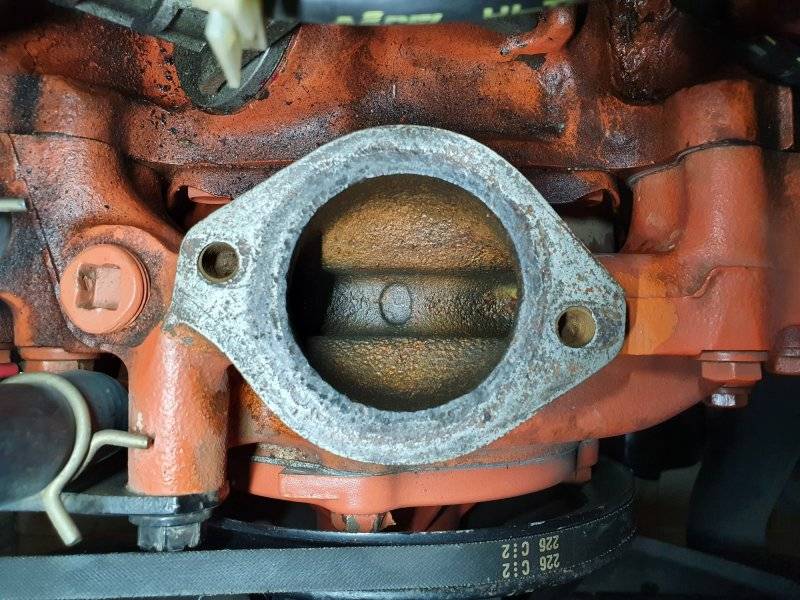

Not good to plug the bypass hole. It is there to prevent total cavitation when the car is cold/ thermostat closed completely. Small blocks have the bypass hose, big blocks have the hole. Most likely it would cause bubbles in the system from cavitation at the impeller.
Now, having said that. A mechanical gauge with a 180* sweep or better has good resolution, you may see the thermostat cycling in cooler weather with a high capacity radiator. I have a Buick V6 with a mechanical sender at the water pump inlet - same as radiator outlet, coolest there is - shows 20* colder or more in winter driving.

I've read that plugging that bypass is usually for drag cars NOT running a thermostat, also when cold the gauge will do weird things because there can/will be cavitation.
It is meant to push all of the water through the radiator and no warm water into engine when still cold and usually makes it harder/longer to warm-up.
Ron

The purpose of the by-pass is to allow some water to circulate when the thermostat is closed.
It will make the engine take a little longer to warm up.
But - what it does is it warms gently the whole coolant system as the engine heats up.
If you do not have a bypass when the thermostat opens the hot engine will be hit with dead cold water from the radiator and this can cause damage.
As stated if you run no thermostat or a restrictor plate you could remove it.

Ive read a LOT of not so good comments on these aluminum water pump hsgs . Most have to do with cavitation or down right drastic over heating issues

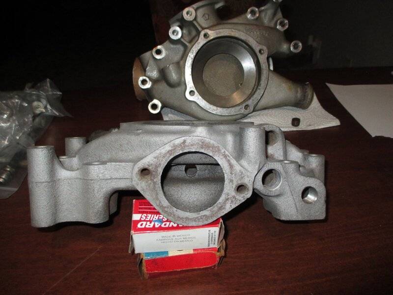

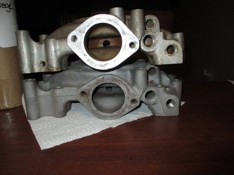

Bill the problem housings should have been sorted by now. That was a 440 Source sold housing about 15-20 years ago that were made with smaller ports for some reason.
This MP housing is laying on my desk with a cast iron one and port wise are the same. The only difference with this particular one is it will sit the thermostat about an inch higher and the factory temp. sender is drilled on the left side not passenger side.
Having the factory sender on the left and the mechanical on the right actually confirmed to me that it was a gauge fluctuation and not an actual temperature fluctuation.
Ron
