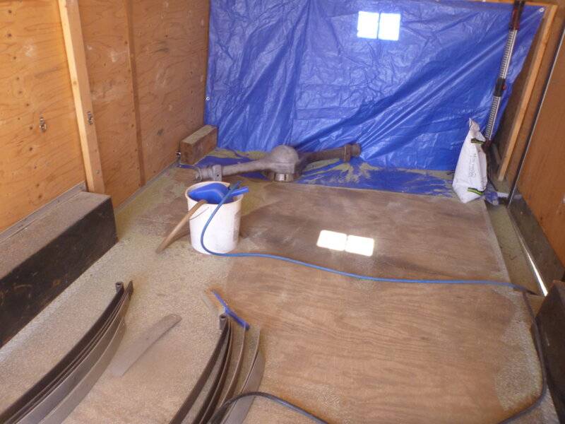

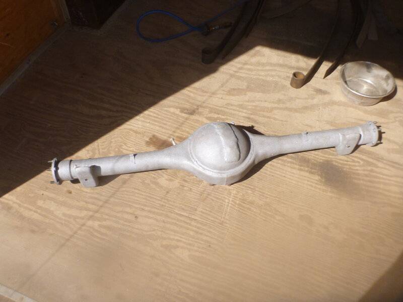

I like glass.. but wear a fresh air hood and borrow your f-in-laws enclosed trailer when he's not looking!
Get some coarse stuff, blast, sweep it up and use it again. Then seperate the finer stuff into a bucket of it's own for small detail stuff like aluminum steering boxes.

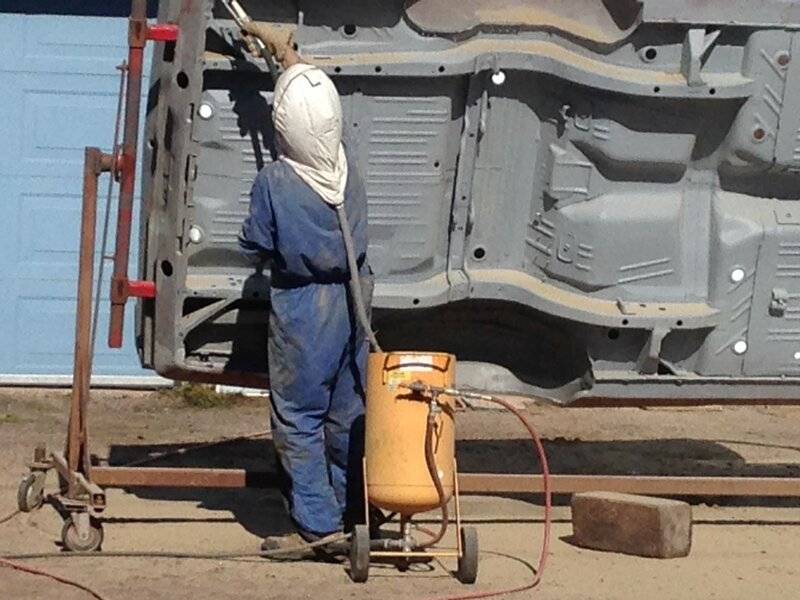

Did my 65 Dodge underneath, by tilting it so it was balanced. Rented diesel compressor and blasting equipment and 6-50lb bags of sand for blasting. Cost $350 for Saturday / Sunday rental and they delivered the compressor. Laid a large piece of plastic to recycle sand.

Safe for underside/interior/firewall and trunk area though. I used over 30 bags to do my entire Charger.
