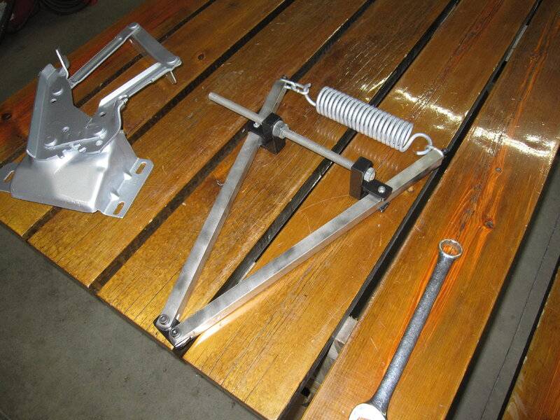

Every external body panel was sanded clean. Mostly with a DA. Yes I've used glass beads extensively, but only on "hard parts" like hinges, brackets, nuts and bolts. Yes leaves a slight "texture". On a side note... high build primer does wonders.
View attachment 1216835 View attachment 1216836
I like your spring spreaders. They match well with my spreader tool.

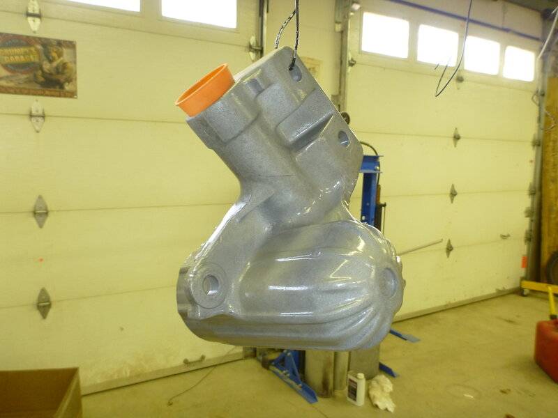

Glass on the aluminum steering box and nothing but a tarnish preventor clear coat.

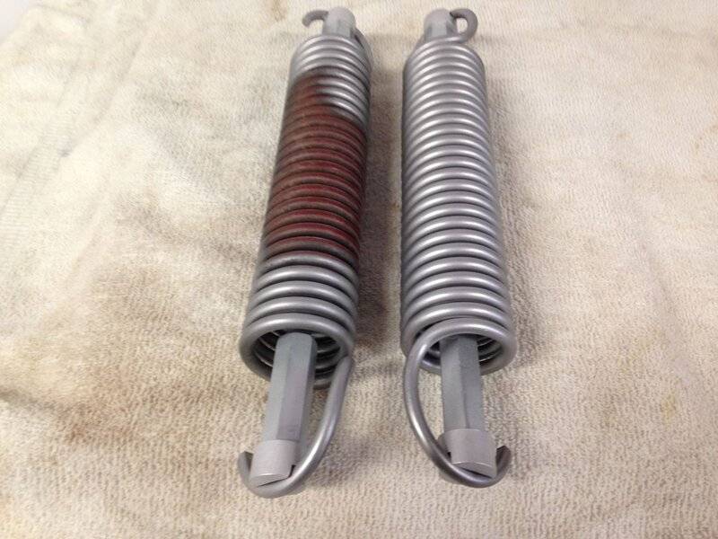

Again, glass blast, but a coat of my mixed Semi Gloss Tremclad. Springs are glass blasted and T9'd.
