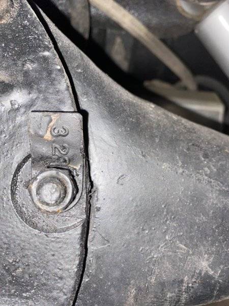

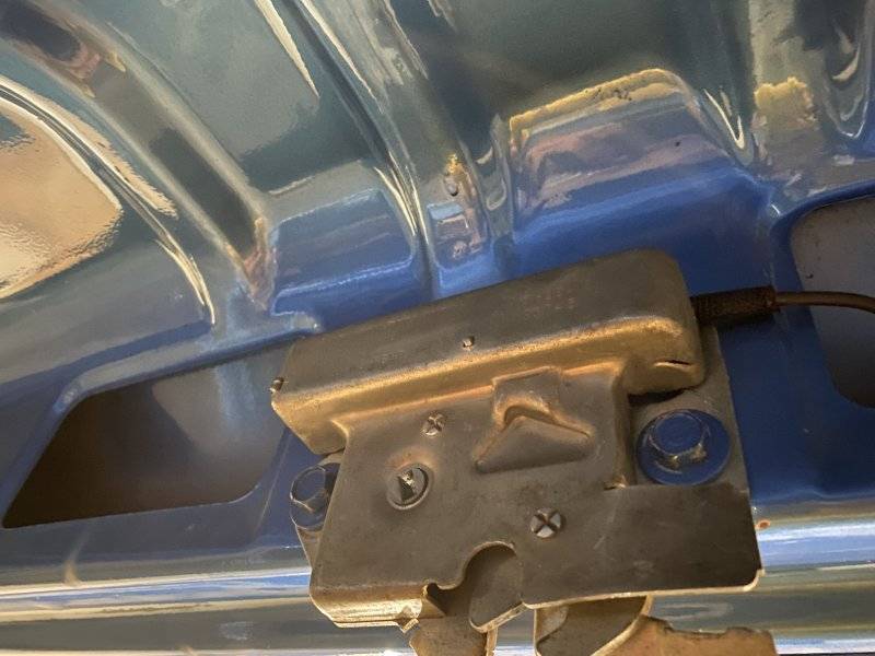

I got the the latch mounted and wired. I still need to make a mount for the release cable and with the trunk seal being new, the trunk sits a bit proud of the quarters but I’ll live with it this way for a while. I crawled underneath and found a “3.23” tag on the axle and confirmed that is the ratio. 3.55’s should improve the acceleration a bit and still maintain reasonable cruising RPM with a 0.67 overdrive in the transmission. In a fantasy world, a supercharger would fix my acceleration cravings but that will be down the road a ways.

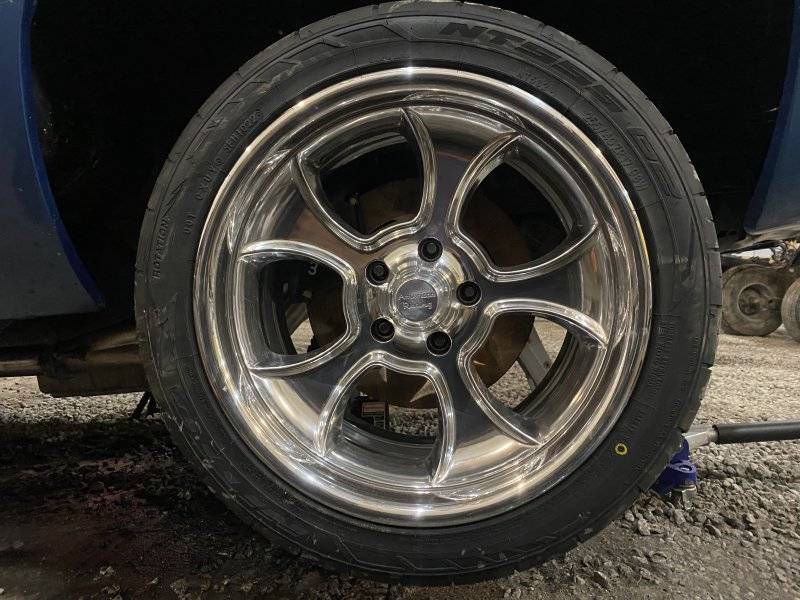

Disgustingly dusty but got the wing painted and mounted. New 255/40/17 tires for the front on 17x9 rims that the P.O. ordered for the back but had the wrong backspacing are going on this week after I swap the front brakes. I have a Wilwood 12.19” 4 piston setup that’s on a car without an engine right now. The front tires currently are 225/50/17 on 17x7 and are old enough that they have some dry cracking.

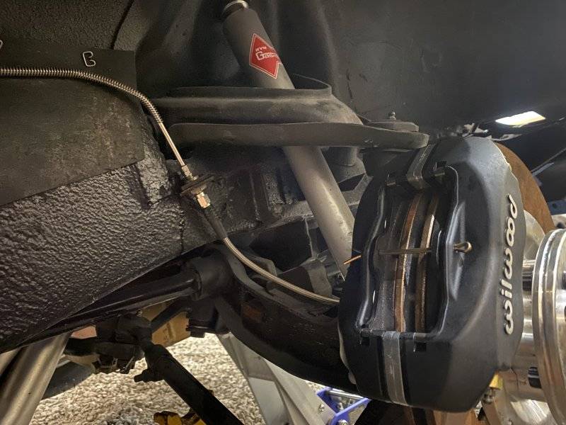

Wilwood 12.19” 4 piston brakes on drum spindles with SS braided lines. The hydroboost system should be here in a week or two. I had to reseal the trans pan while I had it jacked up. Hopefully I’ll get the brakes bled and the transmission refilled tomorrow night.
