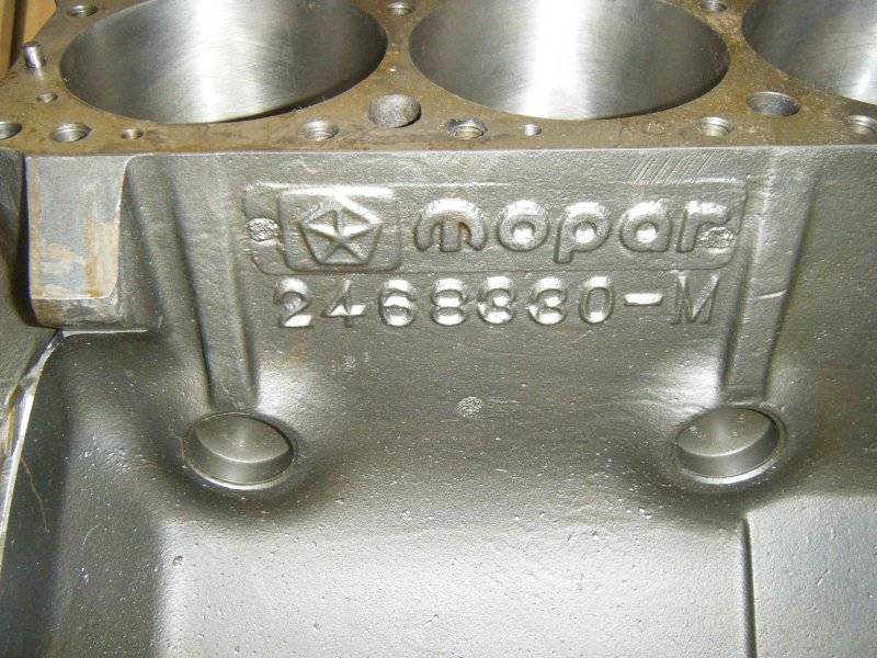

picked up new mega Siamese block was told this block was set up for a high lift roller lifters ???
want to use for street any harm
thanks

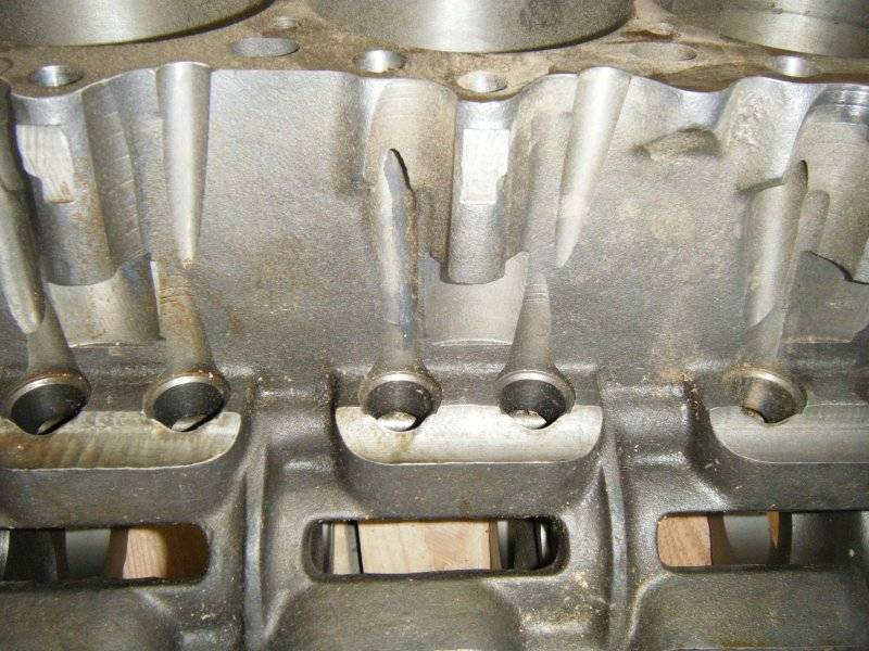

The lifter bosses are taller to support the lifter better. If you use a roller lifter make sure the tie bar doesn't contact the block when the lifter is on base circle at the bottom of cam lift. Most current roller tappets clear. If using at flat tappet cam you won't have an issue.
Doug
The bosses were machined for tie bar clearance. (for a smaller base circle).
Whatever cam and lifter you want to use, just make sure it doesn't uncover the oil gallery at any point. (from base circle to max lift).
If so, they will need to be bushed.
thanks for the reassurance will only be using a isky solid 520 lift cam on street
thanks all
