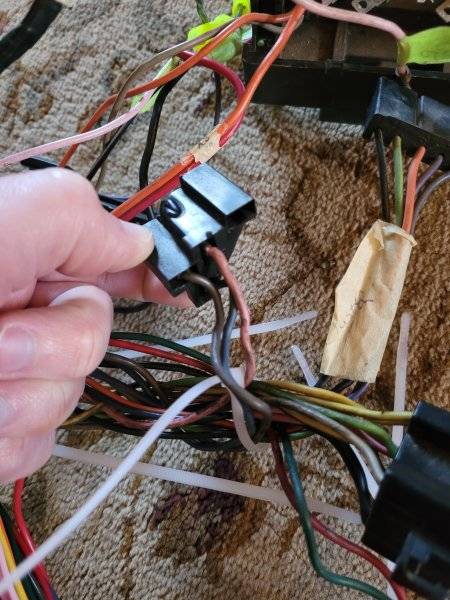

Does anyone know of a source for this connector? I'm going through my dash harness and fixing some issues, I'd like to replace with the same connector rather than individual connectors if possible. I believe it is for the wiper motor switch.

Are you sure thats for the wipers? 3 wires does not seem right. Is that a pink wire? Is so its a dome light/interior light circuit

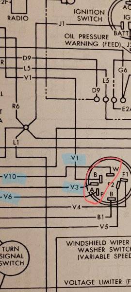

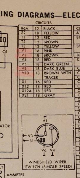

Not 100% sure. I didn't remove the harness from the car, it came in a box with the car, but it looks to match the wiring diagram in the fsm.
What kind of car is it?
So it still should have 4 wires and what are the color of the wires.
Correct, it should have a brown with tracer in the open spot, assuming that is the correct connector. The 3 wires that are there do match the diagram for color (pink, brown, and dark blue). The missing wire may well be loose in the harness as it's a bit of a rats nest at the moment.

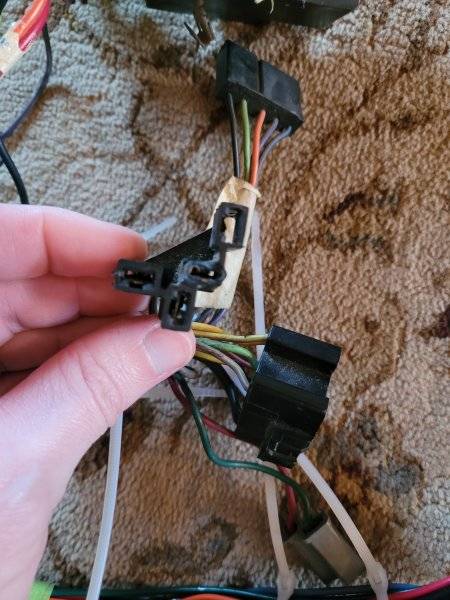

Looks like a tight gap between the pink and the brown. I wonder if @eldubb440 can help out with that?
1/4 inch +/- 1/16 is sufficient.......as long as it's consistent
in this case, it tain't
I have one you can have. Do you want the wires/terminals cut off a few inches back or just the plastic connector itself? There are 4 wires to it. it’s out of a 66 Sat.
You can PM me if you want it.
