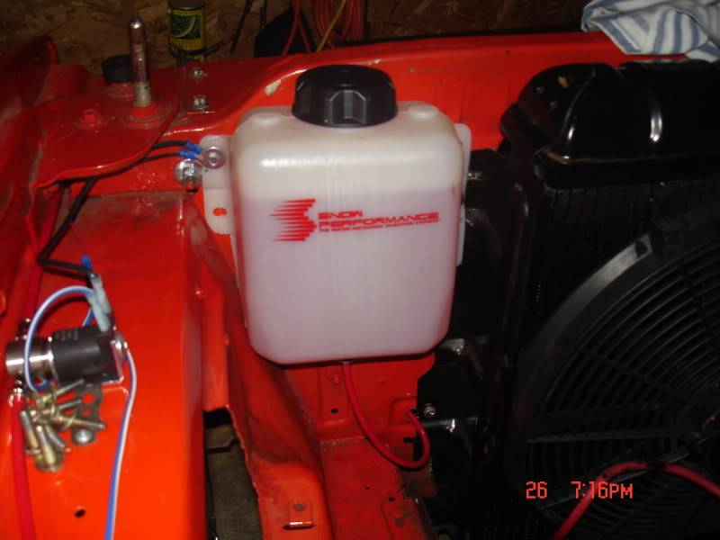

Start you off with the 3 qt reservior which I mounted on the left hand side of my rad support

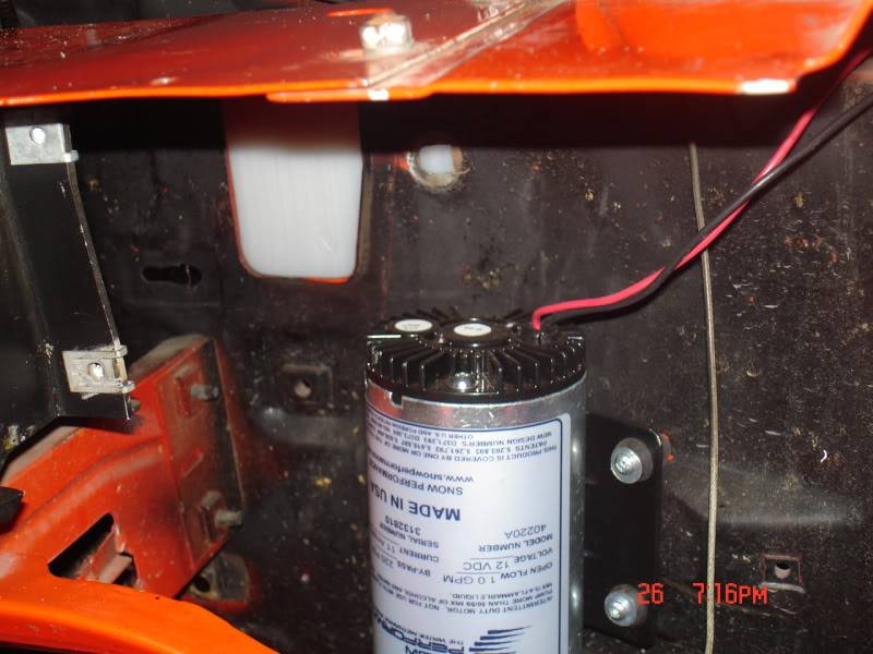

Then gravity fed to 150 PSI pump

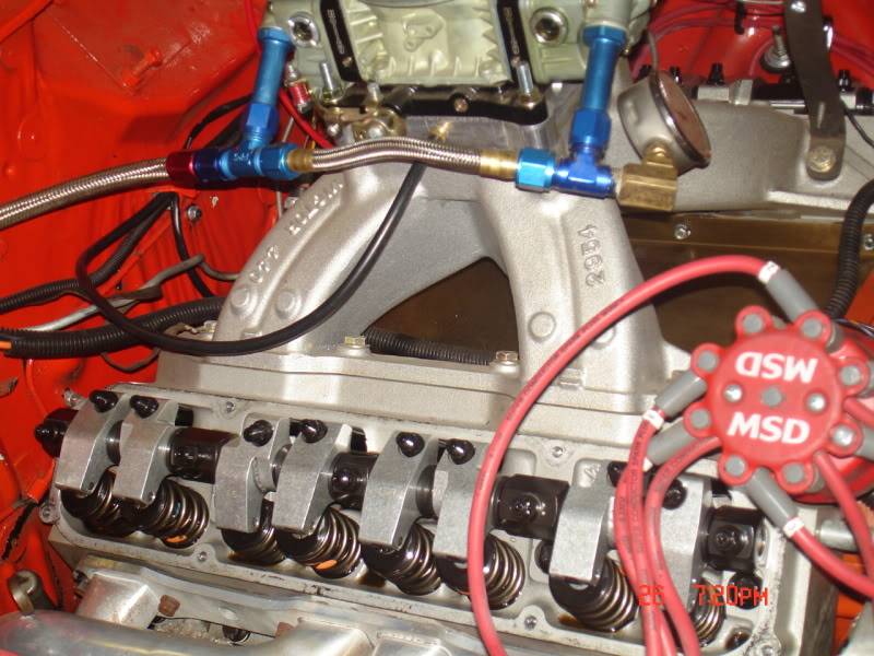

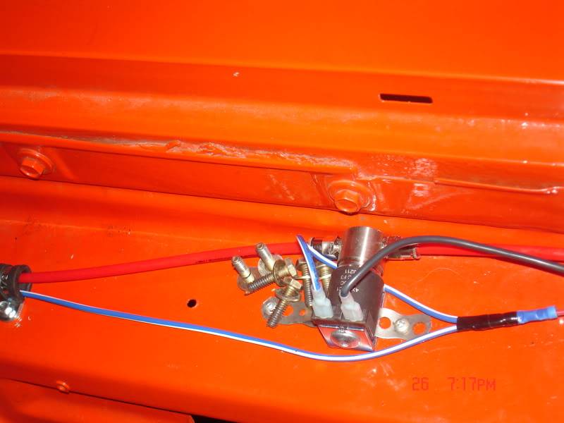

Then run tubing to the anti syphening solinode

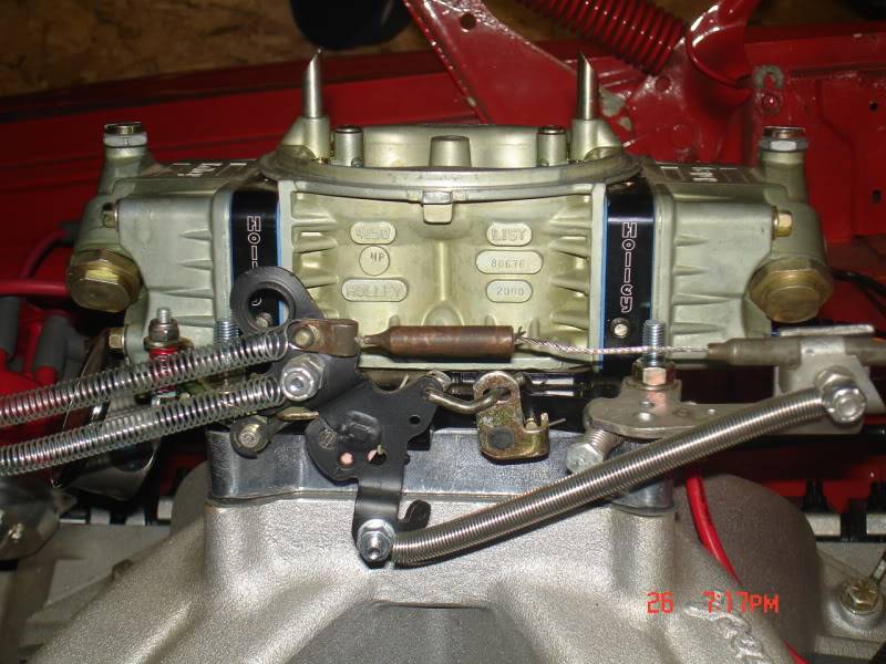

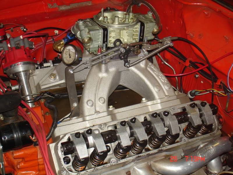

then ran the tubing to the carguretor plate

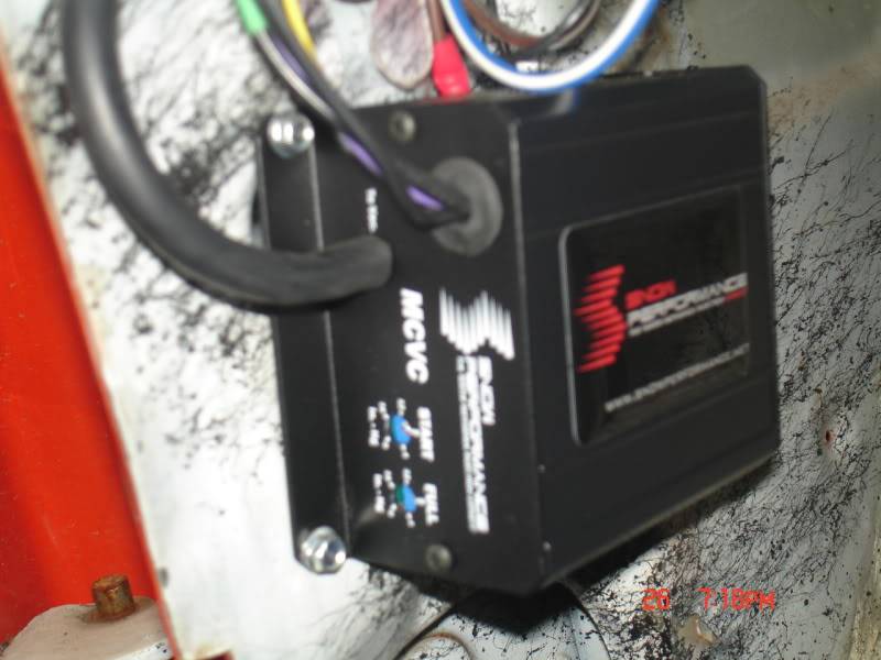

I mounted the mcvc controller kick panel drivers side

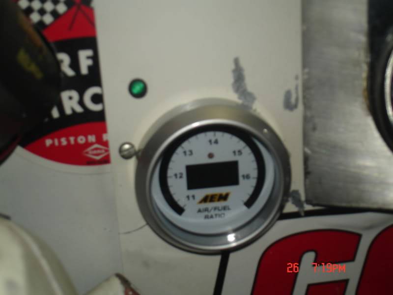

I also installed air fuel ratio gauge
The little green lite above the gauge is to let me know when starts spraying

So I set my controler to start at 4 inches of vacum so my pump will operate 10% and set minimum rpm at 4000 to avoid any bogging and finish off at 0 vacum to get 100% injection pressure. I hope makes sense to guys.Cause I have to wait a whole month to do my first run.
