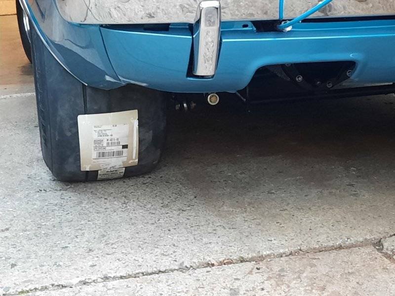

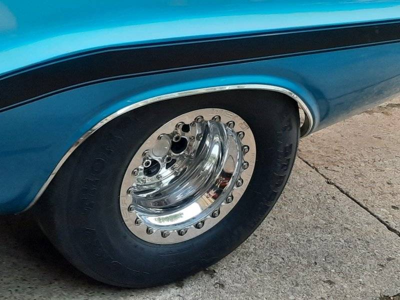

I measured, I have 13" of room best I can tell. 345's would be a no go. The current 275/60/15's are on 8.5" torque thrusts with only 3" backspace it seems. On a big bump they will rub a little on the weird inner fender bump out that chargers have. 2" of space to the leaf springs with this setup.
If you have 275s now, on 8.5s (really 9,5 wide), and you have two inches to the spring, ( and 3" backspace?!? Really? I'd measure to make SURE of what you have now!), anything from 4" to 4.5" backspace on the 17x9 will be an improvement.
Yes that's what it is. These rims were not bought for this car, just had them in the shop.
