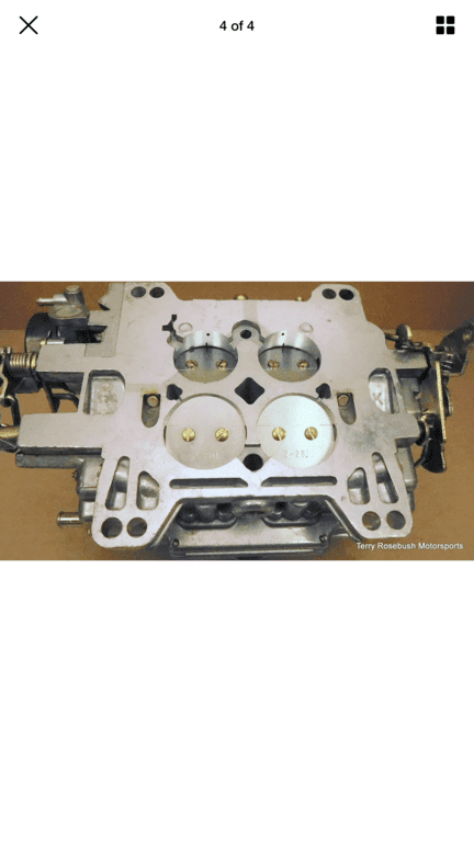

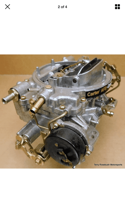

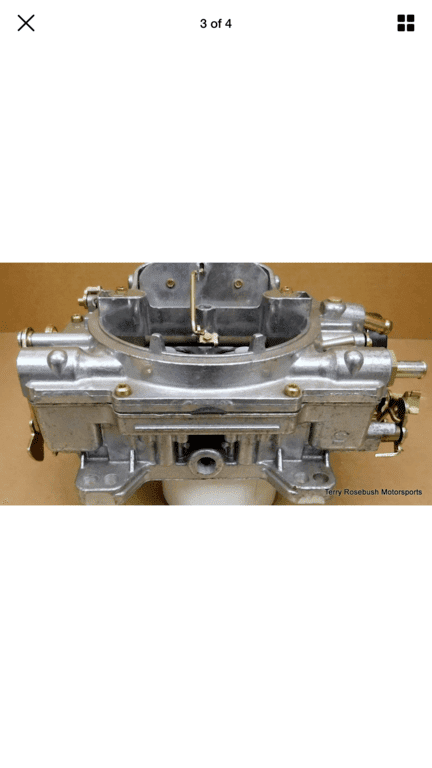

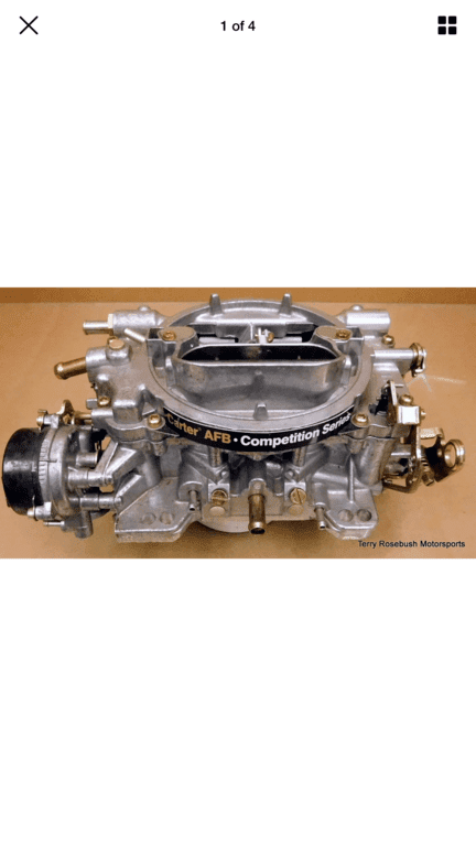

Thanks Vic I appreciate that, I picked up a shelfed AFB comp 9000 series over month ago and it looks perfect but it's stuck in an APO the last 3 weeks so I wait patiently for it to be released ... as does my charger
