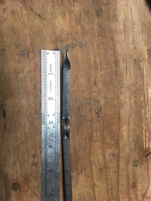

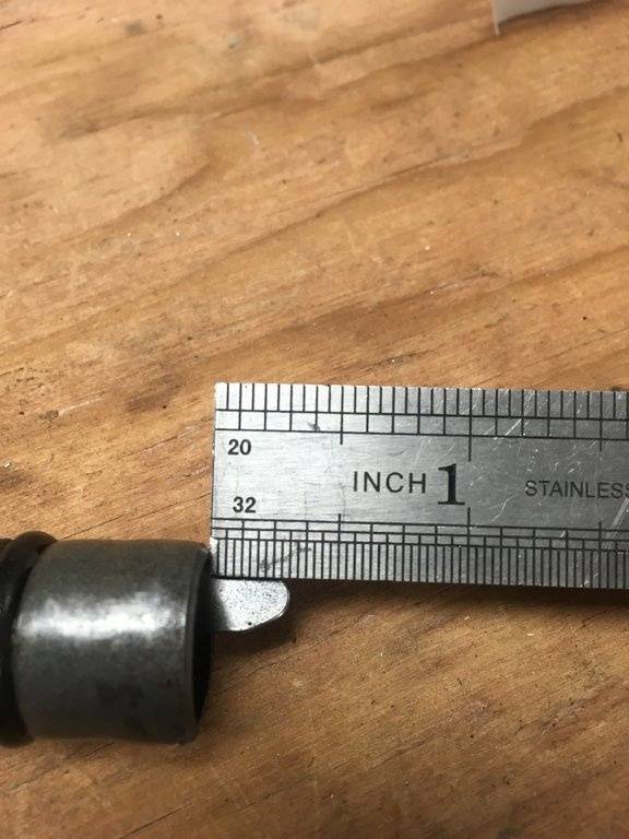

That said, I have an OEM 727 dipstick on my bench (decided to try the lokar). Later today I'll check how far the stick penetrates into the trans case... and post some pix.

Now, regarding the dip stick, looks like mine is a Delco unit, not OEM, and says the same thing as yours.
That said, here are my dimensions... all said and done, full hot is from 1/4" below hole on the trans case to 3/8" *above* the hole (range is 5/8" on the dip stick).
From the looks of it, the tube penetrated 1-1/16" into case, but that seems like a lot... can anyone confirm this?
Stick extends 5/16" past tube...
Full hot mark is 1-3/4" up from bottom of stick...
