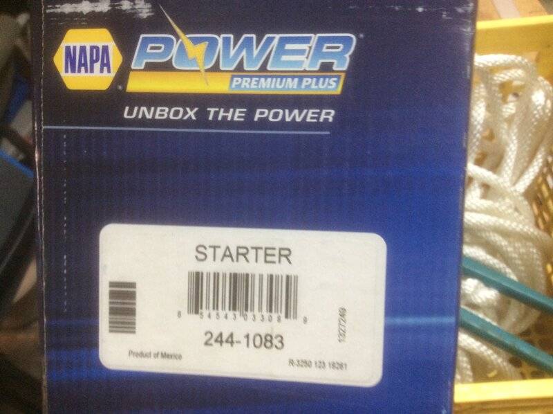

Late with this. Put this $60 NAPA mini starter in my Hemi Satellite. Fit perfect but removed the stud extension first.
