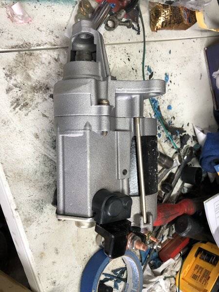

Would using the adapter terminals help any? It looks like they put the terminals close to the same position as with the original style starters.
This is what came on my starter…
I'd run a new 0 gauge cable from the battery as needed. No old cables, splices, etc. Just asking for starting issues. New cables = low resistance = easier starting.
