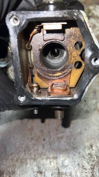

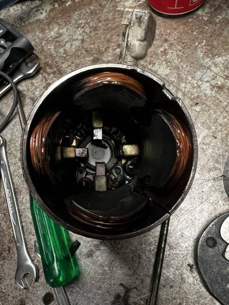

Ichanged all my wires to a 0awg cable from the battery to the starter and up to the starter relay. Still had the issue, took the starter appart and it was very dirty and black on the cupper connectors, the commutator was also very black and had some oil on it, also only found that 3 of the brushes sprung out when i pulled the rotor out, the 4th i had to pry on to get it to spring out, but not sure how it was when the rotor was in the stator. The wires in the stator also looked abit dark and had a "funny" smell when i stuck my nose in it :lol: . I´ve ordered a new "Pro torque" (summits own brand) starter from summit racing and i will see if that´s the solution. i had this problem coming to me over night engine was new built last year and it have been working flawless for over a year.

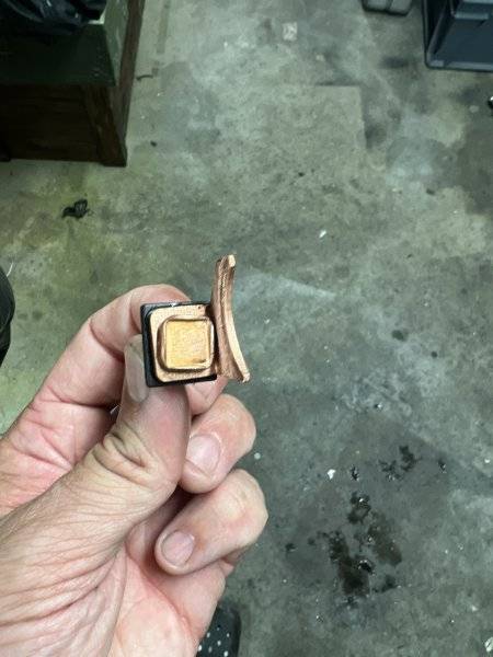

I have the same problem except that min will turnover but very slowly, after it has been cooled down it works fine.. And in my setup it can´t be heatsoak to the starter since i run fenderwell headers and it has been working for over a year then all of a sudden. Got a new starter in the mail yesterday ( Summitracing Protorque part#SUM-820337) I´ll try it on today and then give some feedback. For now i´ll post pics of the old starter, 7 years of duty and came from a Chrysler Voyager V6.
The "missing" brush is just stuck, it sprung out when i poked it after i took the picture
Cleaned the contact but it´has been sitting in an angle
