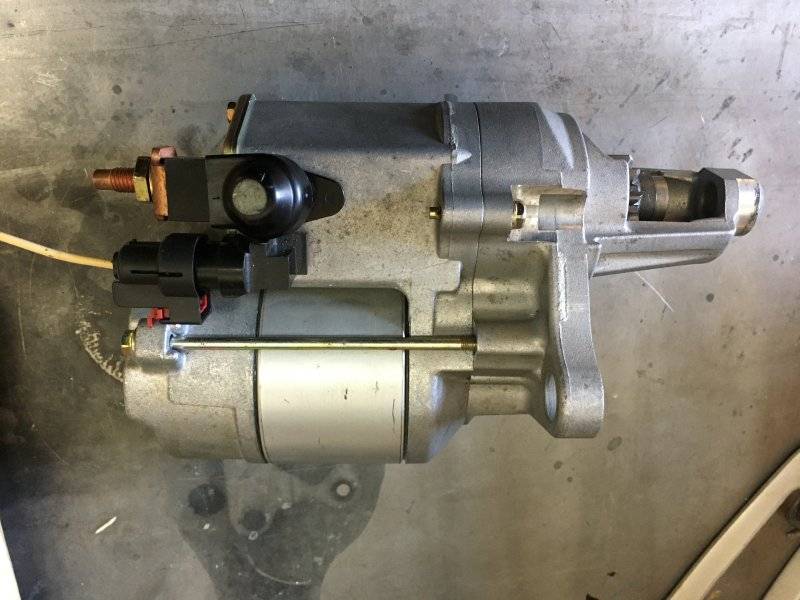

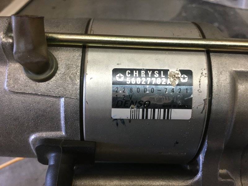

A Dakota or ram magnum starter is about as good as it gets for torque and reliability.
