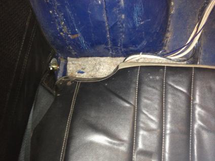

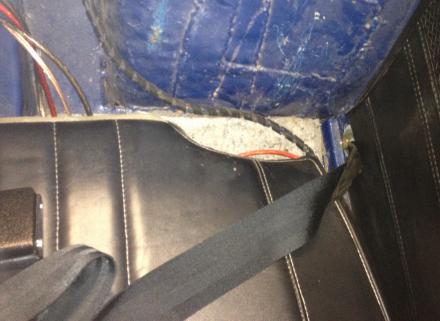

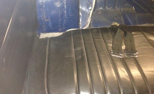

There won't be a problem with the seat - just some minor alterations to the lower corners, as was mentioned. My 69 belvedere was mini tubbed and 4 linked by a previous owner and my 3 kids fit in there just fine. The guy who did mine did a decent job, but he did get a little more 'creative' with the wheel wells than I would have liked. :) good news is I can fit probably damn near a 15" x 33" tire in there if I felt like it.
Here's a link that I posted a few years ago when I first bought the car. Car is parked for a motor transplant, tonight I'll pull the back seat and post some pix of the seat.

Now that I'm looking at it again, I'm not sure any mods are required at all. The previous owner went a little bit hog wild reshaping the front of the wheel house, and still there is plenty of room. One thing I always wondered though, is if he moved the rear seat bottom forward a bit?
