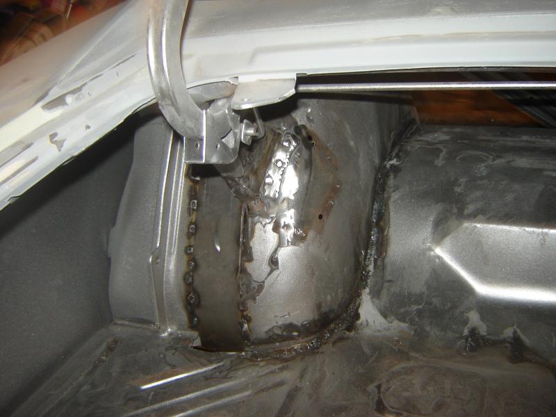

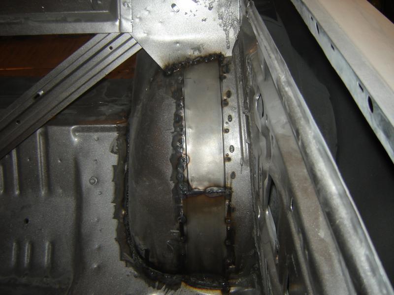

When I did the mini tub on mine there was only a small amount of rear seat modification that needed to be done. There are a couple of bars in the lower corners on each side that will need to be cut and re welded but its not hard.The top frame where the foam and upholstery sit does not need to be modified just the back structure.
I haven't decided on suspension yet, just have the trunk and outter wheel houses cut out and figured that's now is the time. Joe, did you make your own or buy the kit?
I made my own. They didn't have the kits available at the time.
In the lower corners There is a tab that holds the upper seat in place just make sure you get that back in the correct spot.Mine were a little off and I had to do a little more modification to the back section to hook in.
That looks to be about 3" or so? What size tire?
It is 3". I run a 315 35 18 the tire is 13" wide and the rims are 12". I had to have custom offsets.
