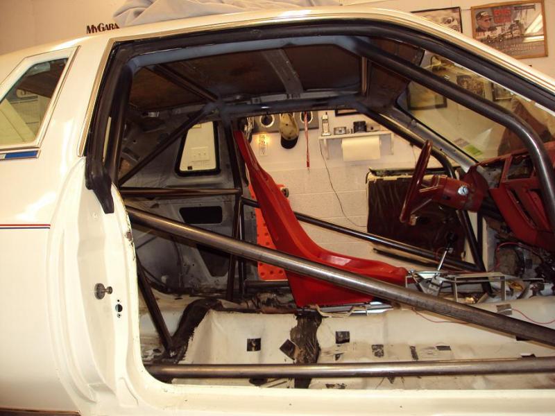

Why I went with an 8 point cage. When I started to run mid 10's, I started to see wrinkles in my rear body panels near the B pillar. Actually added a longitudinal bar near the floor between the front down bars and hoop. Made a nice stuff box between the front and rear frame sections. No more wrinkles.cagey.jpg

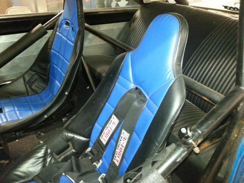

I have a 8.5 certified 8 pt and breakaway door bars. The cert expired in 2010 and the car is going back to the street. I want to remove my shoulder bar to make it safer for the kids in the back seat, they will be getting 4 pt harnesses in the rear....20141108_192253.jpgFB_IMG_1430761740248.jpg

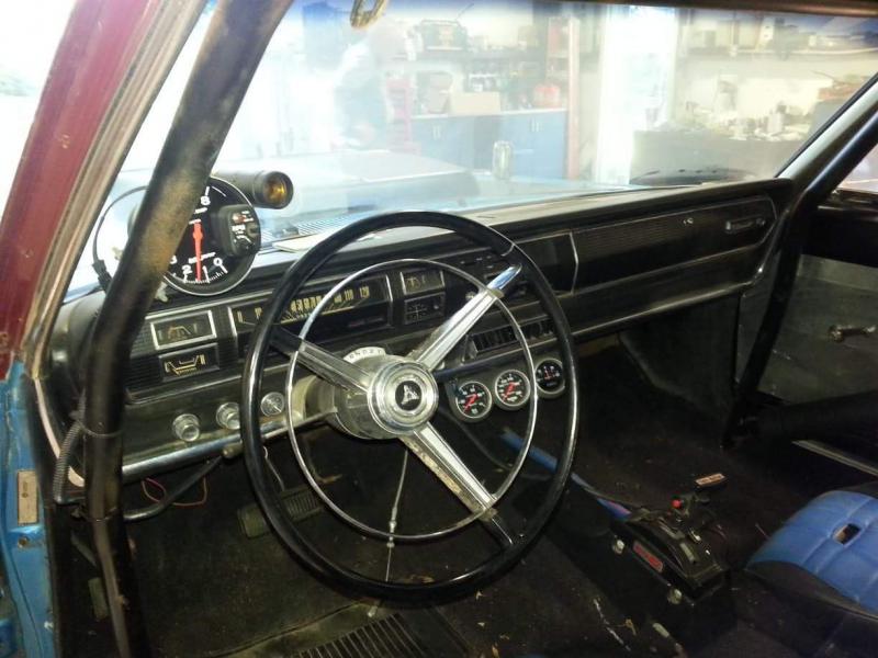

My bar is an S & W kit and I installed it myself. Its a nice kit they make. I thought about going throught the pagage tray but since I installed it myself and have seen them with the rear bars at the seat back and cushion I knew that would be easier for me doing it myself.
Crizila do you drive your car on the street any with your rollcage setup and if you do is it close to your head at all ? Ron

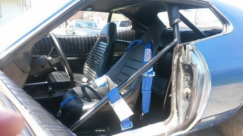

rollbar.jpgI went a the S&W kit & just ran the rear bars thru the back seat. Now i won't get dirty looks running low 11s with no roll bar. lol
I thought about putting a swing out bar, but i can actually get in fairly easy.
I just put my right leg in, hold the pillar & slide over the bar.
Looks real good Wookie. I was going to go with a swingout but I wanted to keep the bar as solid as I could as I thought it may be more solid without the swingout but it may not. The swingout is nice for a street car as you can just remove it when driving on the street as my buddy does. Ron
