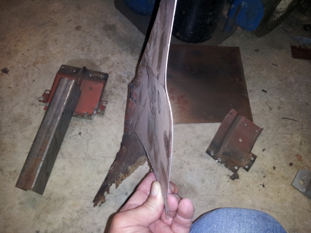

Dehump . . . here's my understanding . . .
When I looked at the shape of the wheel wells in my car, I wondered WHY would they make them the way that they did . . . but they did.
Here's a piece of metal that I cut out of the "hump" area - the outer wheel well above the wheel opening of the quarter panel.
On the left, would be inside the wheel well, on the right is your quarter panel. What doesn't make sense is that the tire would clear at the bottom of the well, but as it moved higher inside, the metal bends inward ( "the hump" ) and the tire would hit it. I cut most of this outer wheel well out of my car and replaced it with a flatter piece of steel so that if the tire cleared at the bottom, it would also clear at the top.
Hope that makes a little more sense on the de-humping of the wheel wells - it gains spacing on the outboard side of the tire in the well.

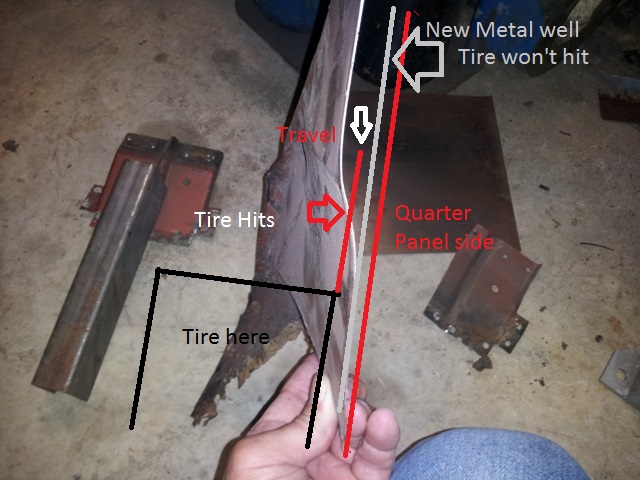

Added some lines on the picture to try and better show you the details . . . hope this helps . . .
I've got a bunch of pictures in my build thread that shows me cutting and moving the inner wheel well against the frame rail to add additional space for the nice big fat tires on the inboard side of the tire.
Thanks Kahn, The pictures defiantly help! thank-you.

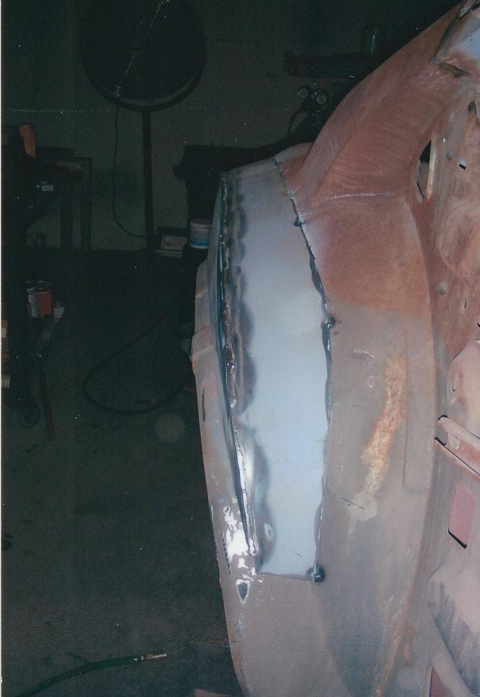

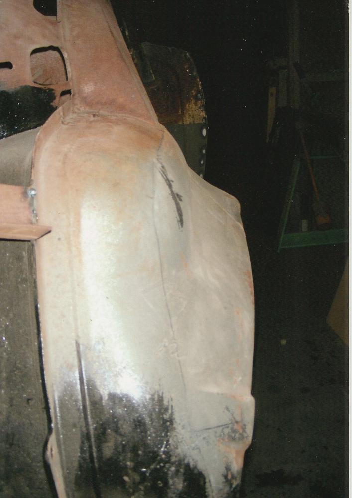

Here's a before and after pic for you (not fully welded in the pic yet), keep in mind all the media blasting and priming took place afterward. You can see the extra room gained.
Wow . . . that looks a whole lot easier then what I did, my quarters were still in place and I welded the patches from inside the wheel wells . . .
( hope you're not claustrophobic )
Sure is easier to see "what" needs to be done with your pics 747 ! ! !

Did you mock up the dehump with the quarter panel to be sure there was no interference?
You know I can't remember if I did or not. There's about a 1/2" clearance at the top corner though.
