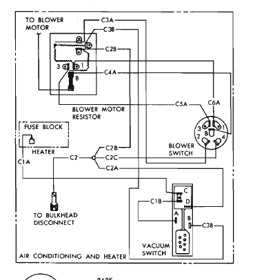

I have a 1965 Satellite non AC car. Is there supposed to be wires hooked to the top of the heater control? There aren’t any wires or harnesses that would hook to this. There are 3 empty tabs with no wires then the vacuum tubes below. Thanks
Doing a quick read it looks like that year did use the same style controls with either heat or a/c. Here is a wiring diagram.
