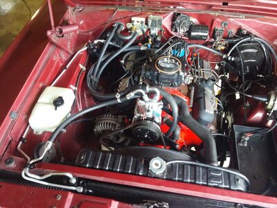

The individual parts start adding up pretty fast. By nature, I am often looking for a way to do something myself for less than just buying a kit. I've never bought a crate engine, I've always built them myself. I've only bought one brake kit, a rear disc setup from Dr Diff. With my limited experience with A/C stuff, I just went with a complete kit.
I could see that the 68-70 B body kit would be about 70 % correct for use in a 66-67 model, the remaining 30 % being the interior controls and the dash ducting. I made a few changes to my setup in the interest of a cleaner appearance.
We would like to keep the interior controls and dash ducting original and not mess with them.
I can understand that.
My heater and A/C didn't work when I bought the car and it wasn't until last year that I drove it in cold weather with a real heater. I never developed an opinion on the stock controls but the mere idea of vacuum and electric controls didn't sit well with me. My control panel looks a lot different than stock but fits in the same spot. That was enough for me.
Are you using the stock fan from the engine or putting on a electric one. I don't see it in the kit?. Do you have a evac pump once it's installed to get a good vacuum and get the moisture out. Kits can be great but most folks run the lines different ways other than what the kit says to do. Ask alot of questions before you buy one just to make sure you get what you want.
Also remember that the factory fan speed is different because it ran r12 in it. You will be running 134a which you most likely will have the fan speed on high most of the time. Also when you wire the clutch and pressure switches that your input power is a steady 12volts or you will get clutch slippage. Not to mention make a good ground also.

Kd, you install looks great

I went with Classic Auto Air's engine compartment upgrade kit in 2016 for my 67 Coronet (with Charger grill). I too wanted to use the stock interior heater box and controls. I've messed with retrofitting AC into other cars and I was glad to be able to get a kit for this car. There were a few minor fitment issue, and the guys were great at helping me work thru them, including sending me a replacement hard line that was slightly different, a known issue with Chargers I was told. I ended up getting a new heater core from them also, and their Original Air Group rebuilt my OEM heater control valve. I am very happy with the build quality of all their components and the system has been working flawlessly these past few years. Along with the excellent heater box rebuilt gasket kit from Detroit Muscle Technologies, I would highly recommend this kit.
