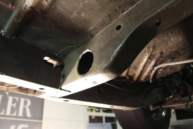

I de-torsion bar the charger, as I’m going to use RMS coilover front suspension.

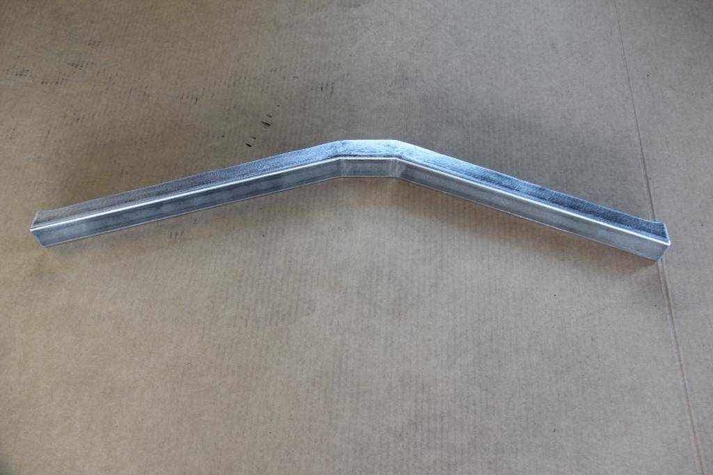

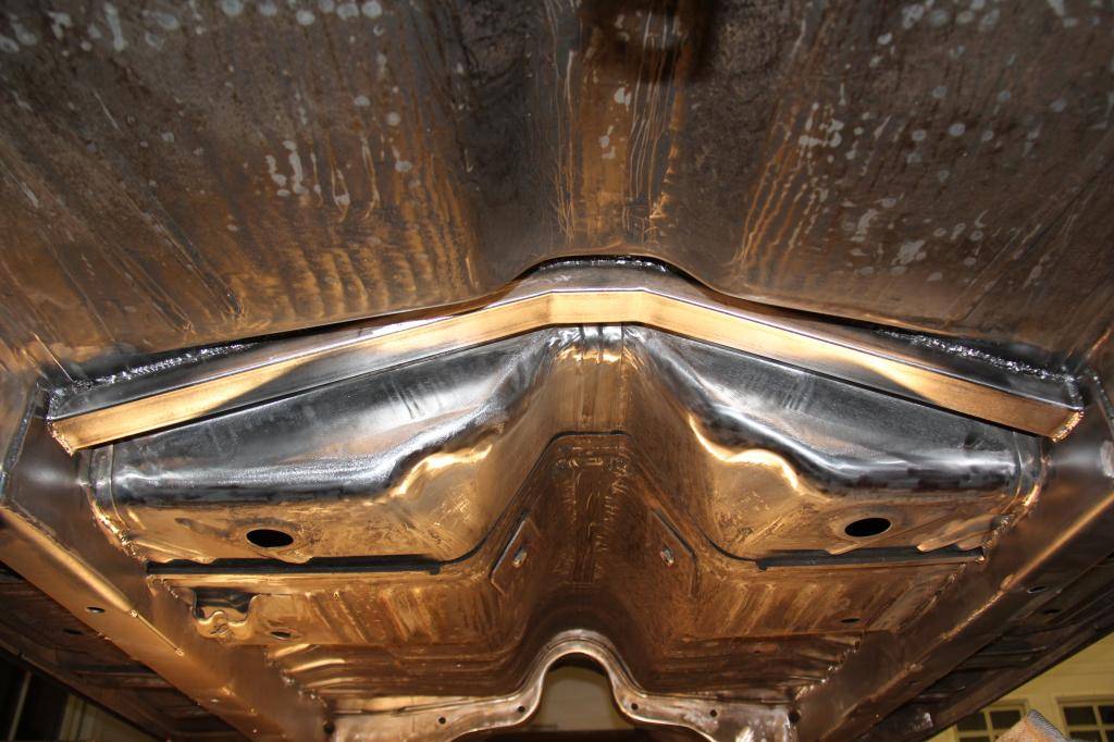

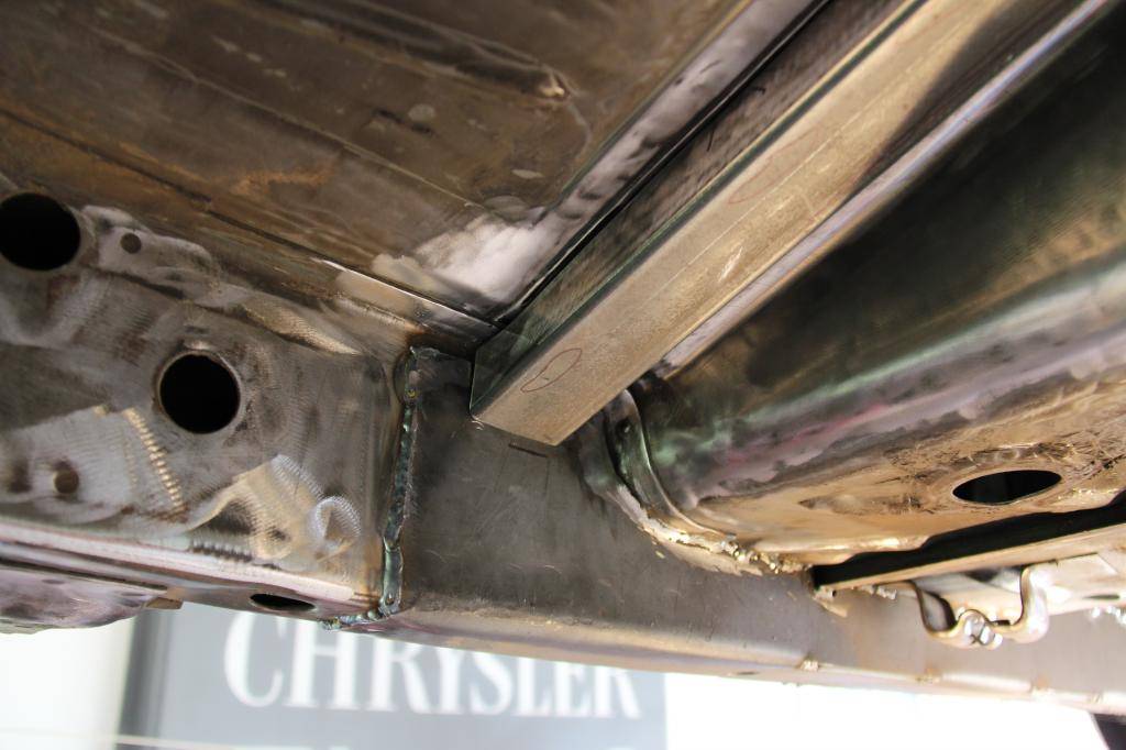

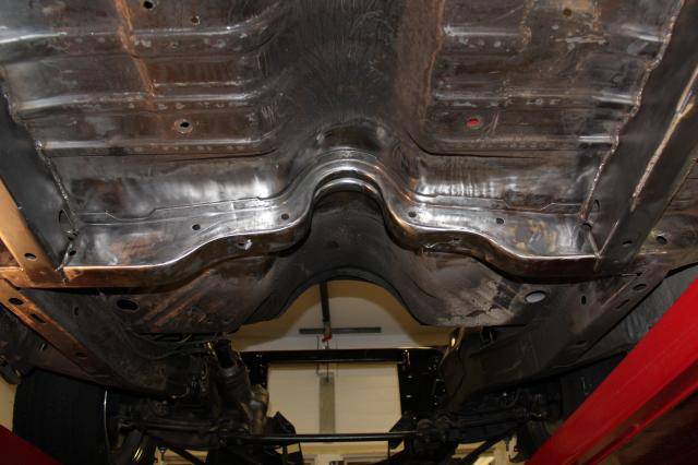

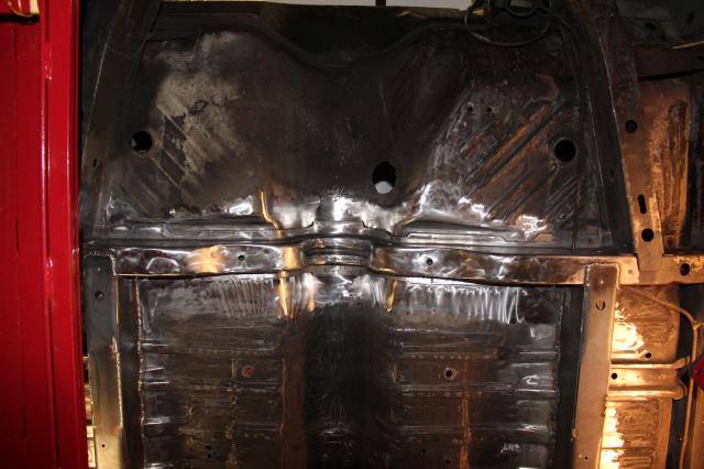

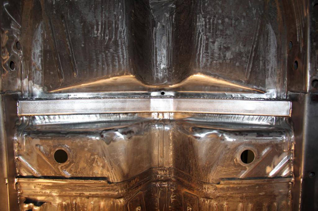

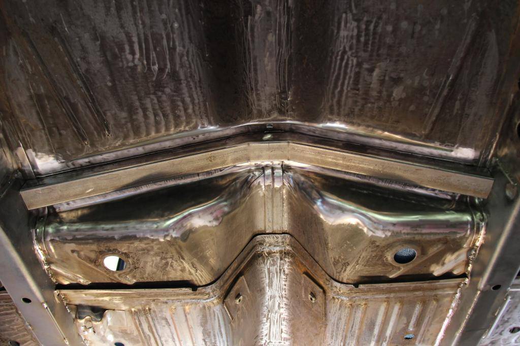

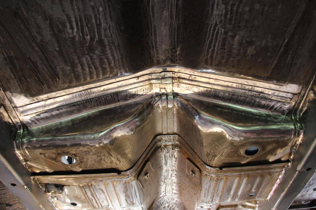

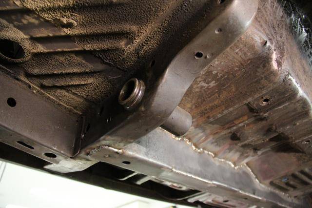

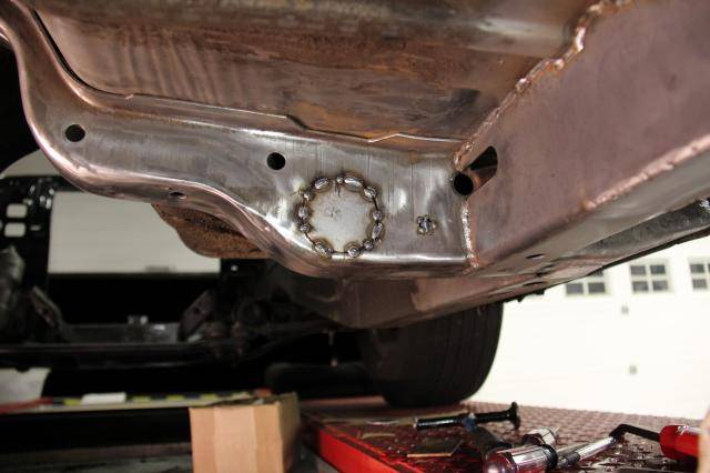

Added a cross member just forward of the leaf spring mounts.Used a 2” x 1 ¼” “C” channel cut and welded to fit in the floor tunnel underthe rear seat. This should add additional rigidity to the chassis withoutimpeding the driveshaft. Torque boxes are next.
Thanks
Pat

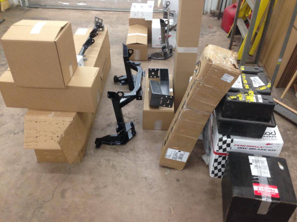

Drove to Reilly Motorsports yesterday to pick up thefront and rear suspension for the charger. Bill Reilly is a great guy and hehad everything ready for pickup! Also stopped in Hazleton PA for the best chilidogs at Jimmy’s! I will post a few more picture of the RMS part when I get themout of the boxes.

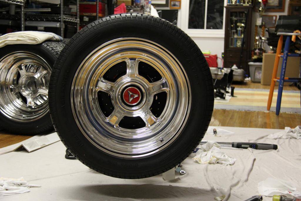

Very nice work! Who did the wheels for you?
EVOD industries built the wheels and they were great to work with! They did about a half a dozen renderings and allowed me to critique them and make changes along the way. I will use them again on the next project.

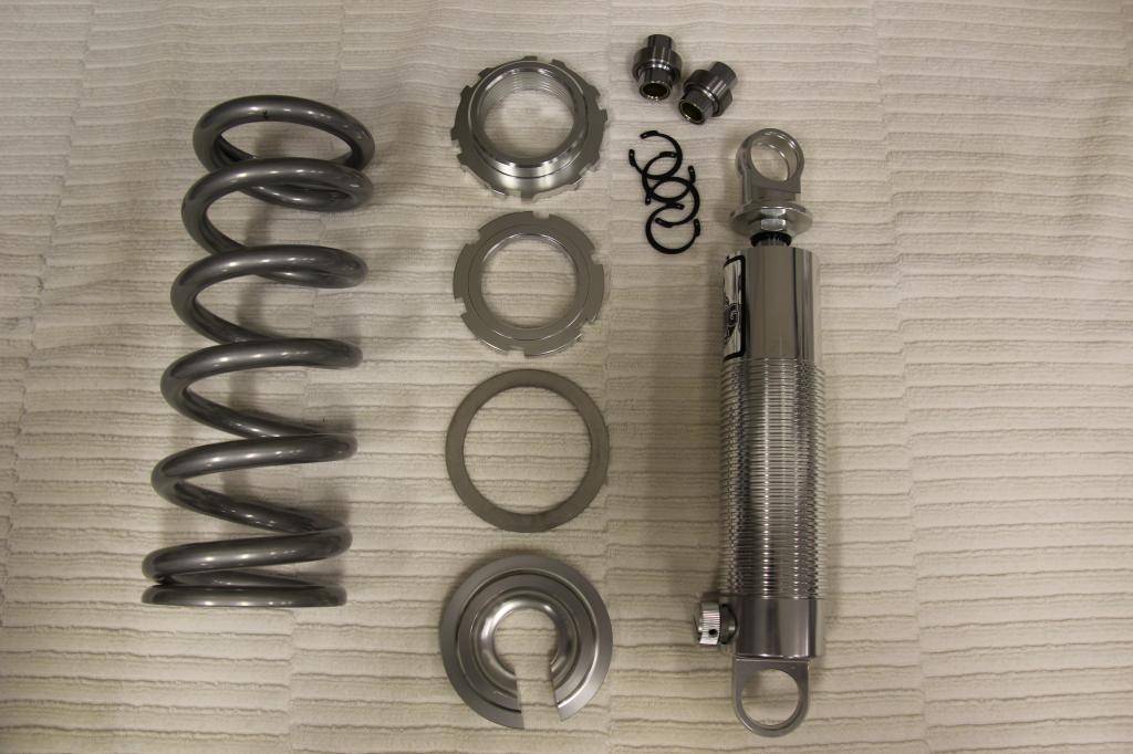

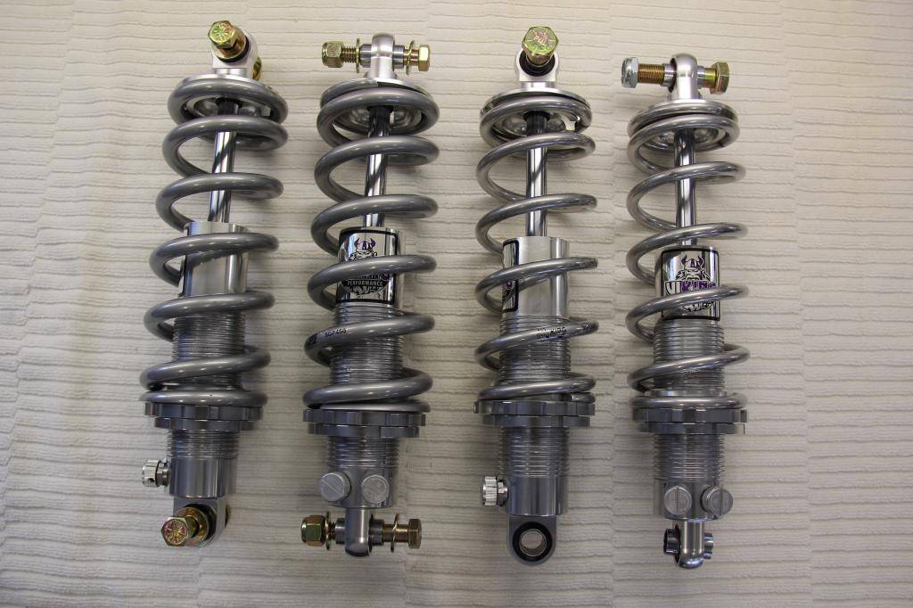

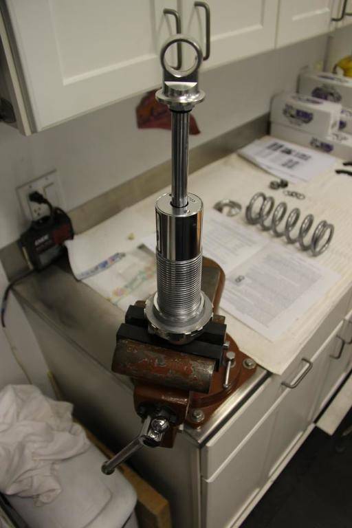

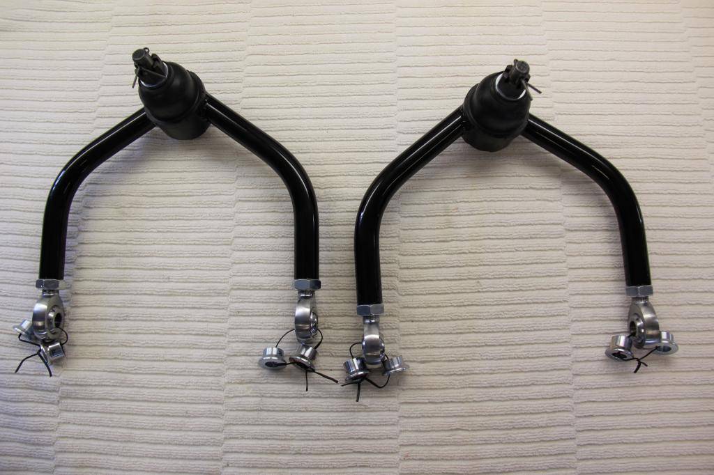

Assembled the shocks using anti-seize and chased the threadson the upper control arms. Nice working on clean new stuff instead of old rustystuff.
Thanks
Pat

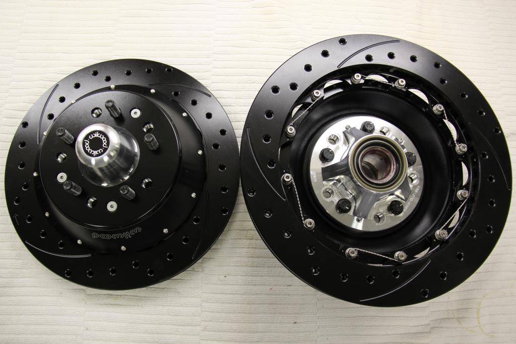

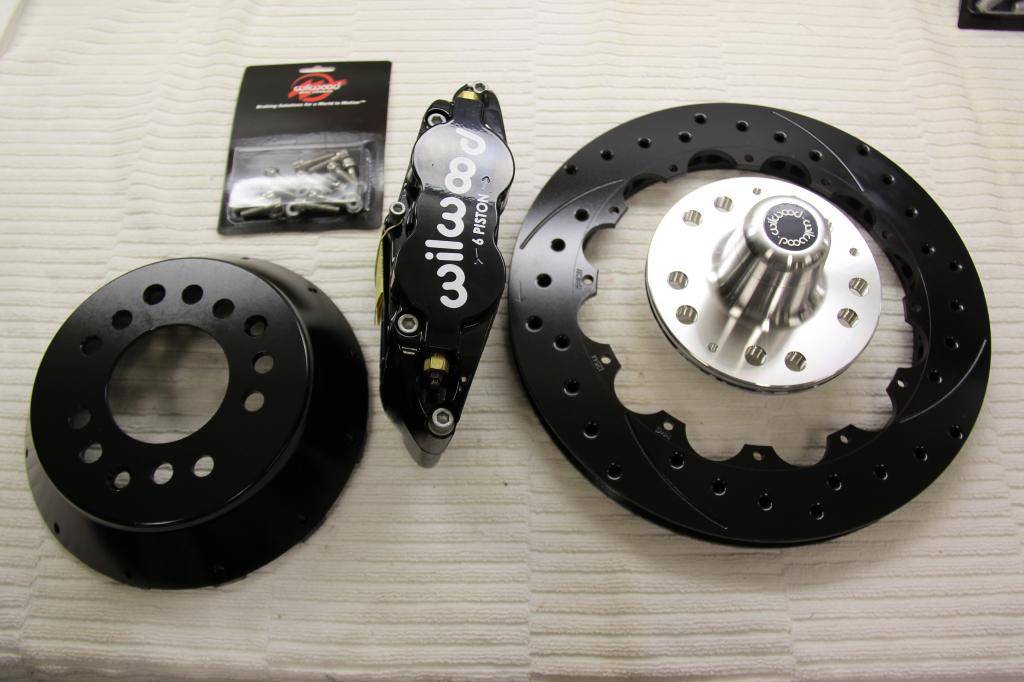

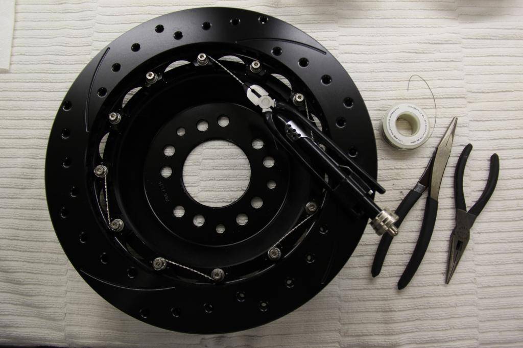

I assemble the new front wheel hubs, hats and the rotors. Iused the same Wilwood 13” 6 piston brakes on my last 68 Chargers and theyworked great!
Thanks
Pat

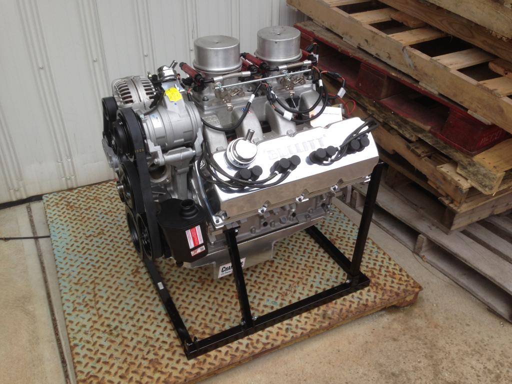

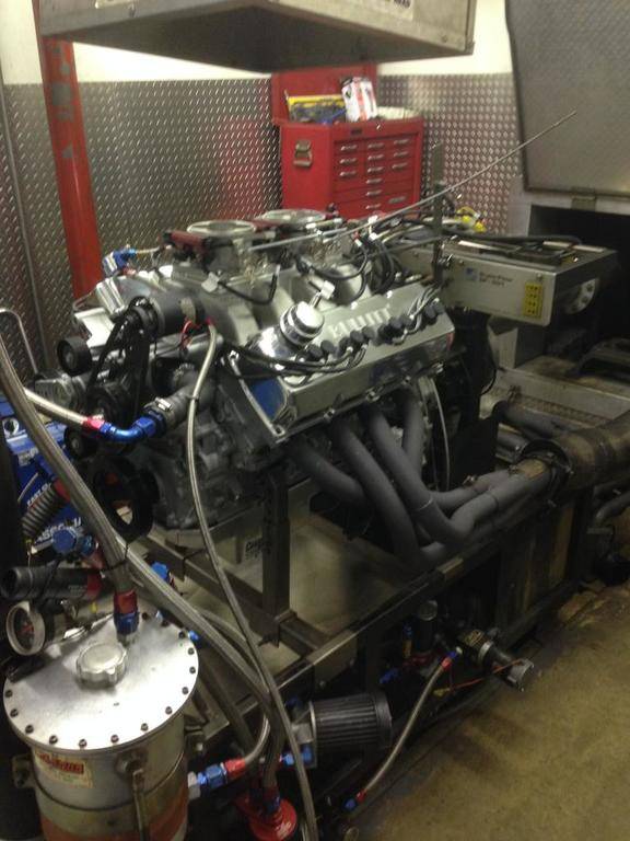

Picked up the new motor for the charger and watched a few pulls on the dyno yesterday at Indy Cylinder Head. The folks at Indy were great accommodating our dyno session and pick up on a Saturday.
The motor spec are, Aluminum 6.1 GEN 3 block that has a 4.125 bore and a 4.050 stroke, which makes it 433 ci. The crankshaft and H-beam rods are from Comstar. Diamond pistons are 10.5 to 1 and the 6.1 heads are fully CNC. Comp cam Hydraulic roller cam .572/.576 with .240/.244. MSD ignition and Fast EFI dual throttle bodies.
On 92 octane she had an average of 635 hp and 536 Lb ft of torque.
I'll post a few pictures later today
Thanks
Pat
That is one sick ride Pat! Keep those pics coming!!!

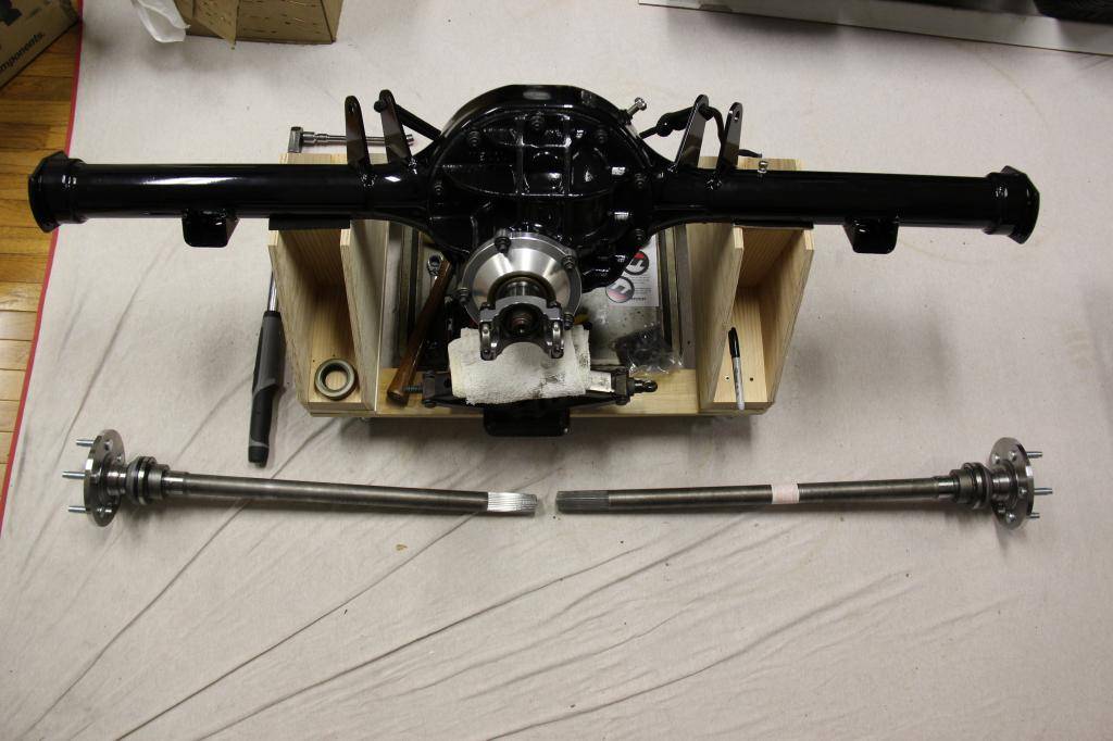

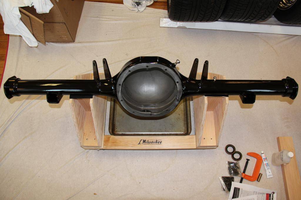

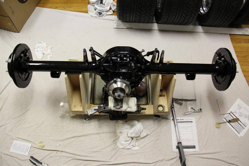

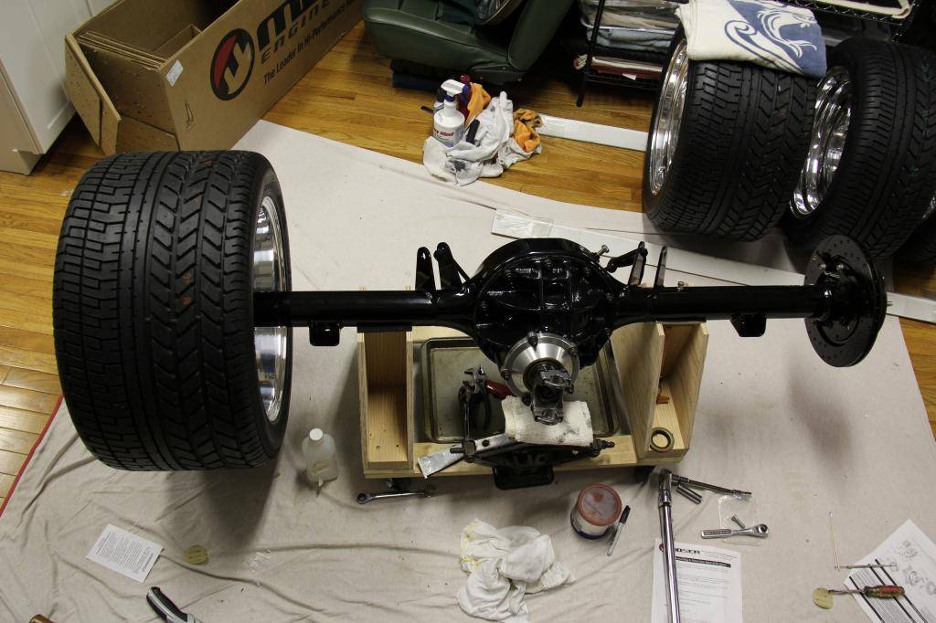

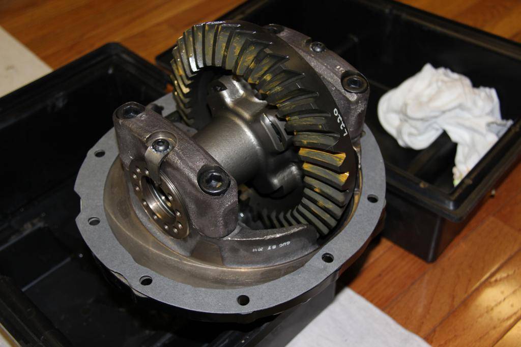

I put the Moser 9” rear together, I ordered 3.70 gears and aDetroit Truetrac differential.
Thanks
Pat

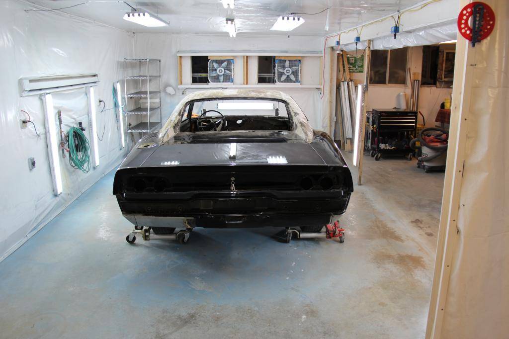

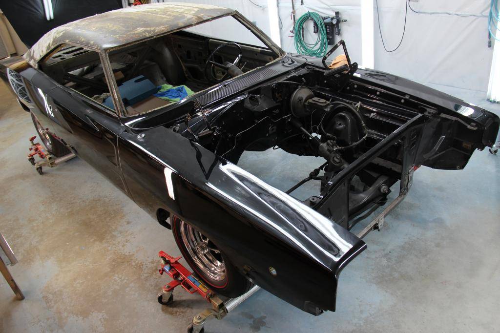

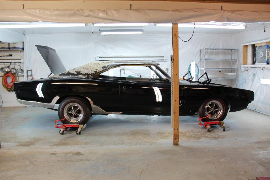

I move the Charger to Kurt’s Hot Rod shop to start thereally dirty part of the restoration. I will do the body work and paint here aswe did on my son’s Mustang.
Thanks
Pat
