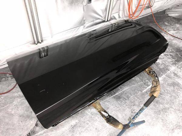

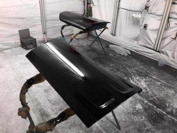

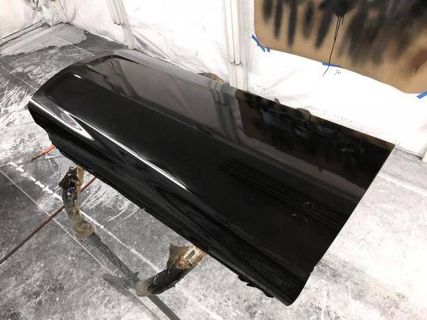

After block/wet sanding the 1st coats of clear with 800 grit I sprayed the final 2 coats of clear on the doors this weekend.

You've got me interested in this whole wet sand and re clear the clear coat idea. I'm assuming this cuts down on buffing since you sand any orange peel and dirt out allowing the final coats to go on smoother?? Interested to hear the benefits since I always paint start to finish all in the same day.

This process really doesn’t save any time on the final color sanding and buffing. It does allow you to flatten the multiple layers of paint that can be a little irregular, prior to the last two coats of clear giving you a much flatter surface.
Not trying to hijack or turn this into "painting 107" but the only reason I do is to have more material to cut. I spray two coats of clear. Let it set above 70 for three to four days then 800 and reclear three coats. then cut and buff. Again. Sorry for speaking out of turn.

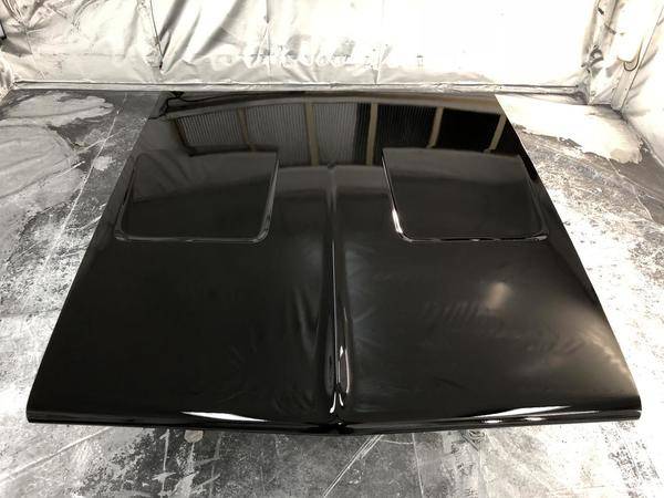

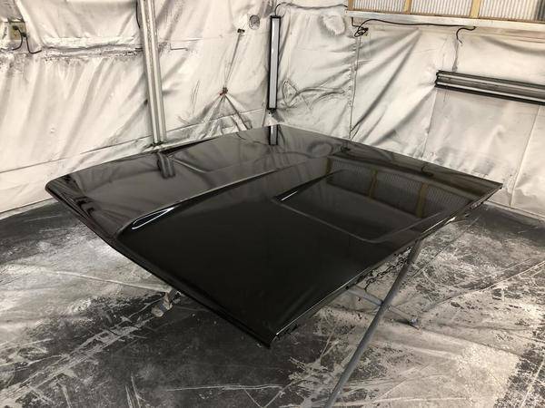

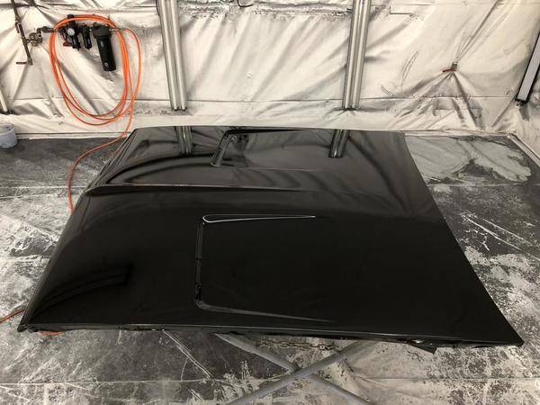

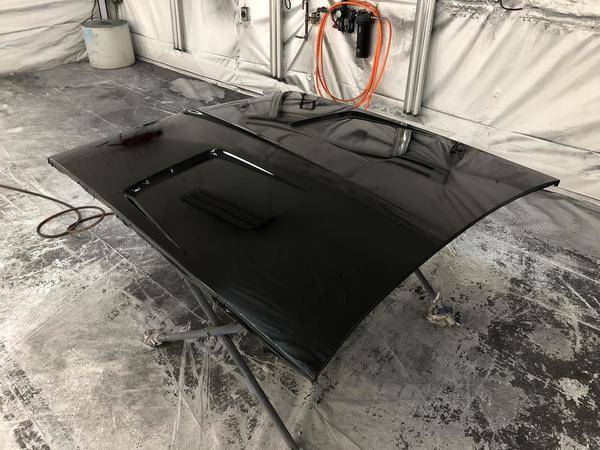

This hood has been a pain in the a$$! First time I tried to paint it I found a bodywork blemish that I missed. After fixing the bodywork, I tried for the 2nd time to paint the hood only to have reaction between the sealer and basecoat that crinkled paint. So once again I blocked sanded, primed and blocked sanded again :-( The 3rd time turn out to be the charm as the hood sprayed out great. The body is next!

I wish I knew what caused that problem?? But it was the only panel I had any issues with. I have my fingers crossed as I still have yet to paint the body, wish me luck :-)
