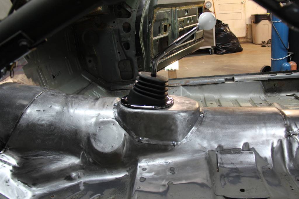

I'll check tonight but it's tucked in there pretty tight, I know you can't see the tranny past the 3" exhaust. Plan on cutting the tunnel tonight and getting it opened up and probably should mention that the vibration was from incorrect angles, once I tilted the pinion to match the tranny everything cleared up but now need more room for the shaft.

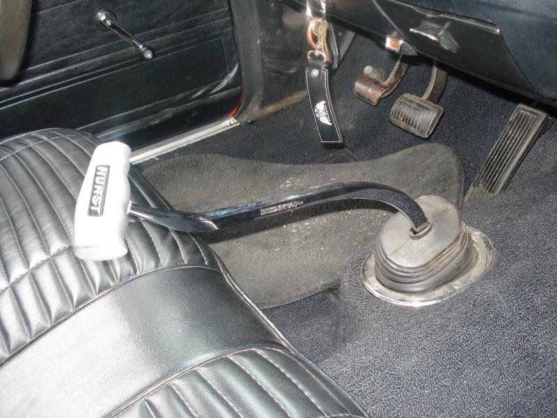

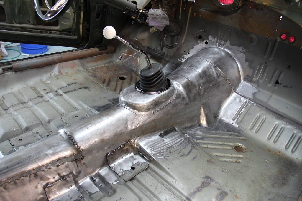

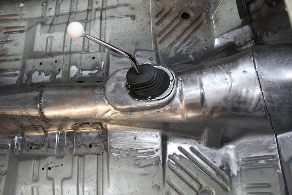

This is the shifter that came with the T56 and I would liketo find an original 1968 T handle shifter that I can modified the T handle totrigger a relay for the reverse lockout on the new trans. If anyone has one orknows where to get one please let me know. I’ll check at Carlisle in a fewweeks.

Any chance you mean one of these Tee Handles?
If you saw what 747Mopar did I plan to do the same wiring in the reverse lockout to the brake light. (only going into reverse when brakes applied)

No not the shifter knob. On the original 1968 non console shifter as used on the Bullitt Charger it had a round brown knob with "t" trigger 1" below that open a gate to reverse by a cable inside the shifter. Similar to a lot of older Corvettes. I think it would be cool to set it up to have the cable trigger a relay for the reverse lockout on the T56. The brake peddle as set up by 747 mopar is my plan #2 if the I can't find and make the t shifter work.

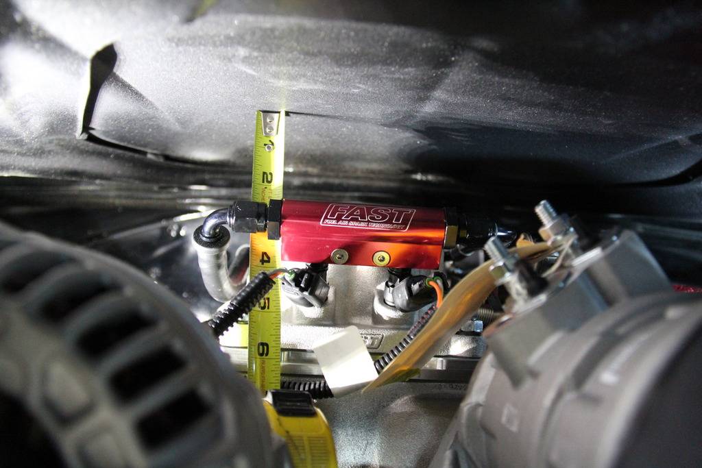

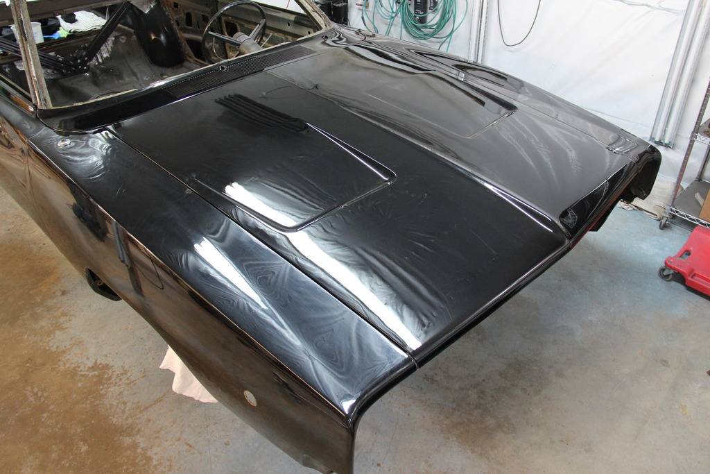

Test fit the hood today to check the clearance for the aircleaner and was happy to see there is 2 ½” at the front throttlebody and 3 ½” atthe rear throttlebody. My earlier estimates were at about 2 3/8” and where an 1/8”more may not sound like much, it is a lot! Before ordering the modern-man Indy intake Icould not find any info on the hood clearance other than the folks at Indysaying it will fit. Not sure it if would be the same with the stock K member?

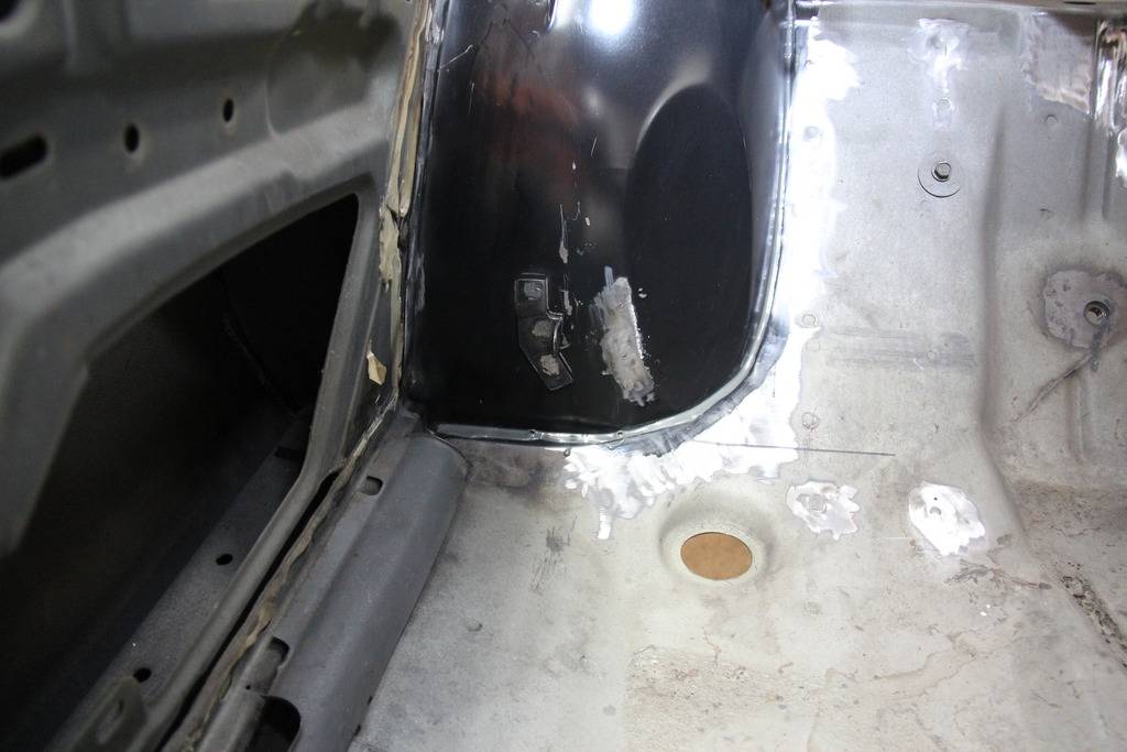

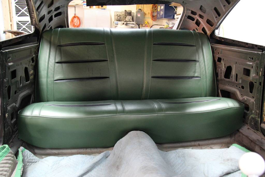

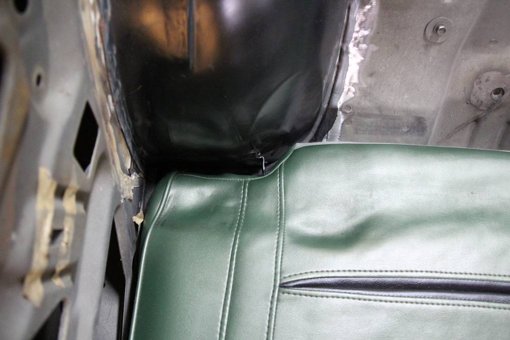

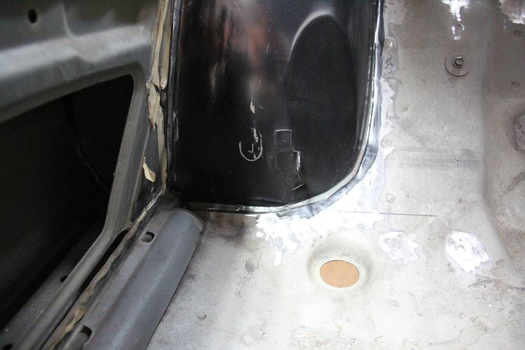

Today I started fitting the backseat to see what modificationswould be needed to fit the min-tubs. Both inter wheel wells have been movedinboard about 2 ½” each. After the 1[SUP]st[/SUP] test fit I was pleasantlysurprised to find very little modifications would be required, and mostimportantly the stock seat cover could be used!

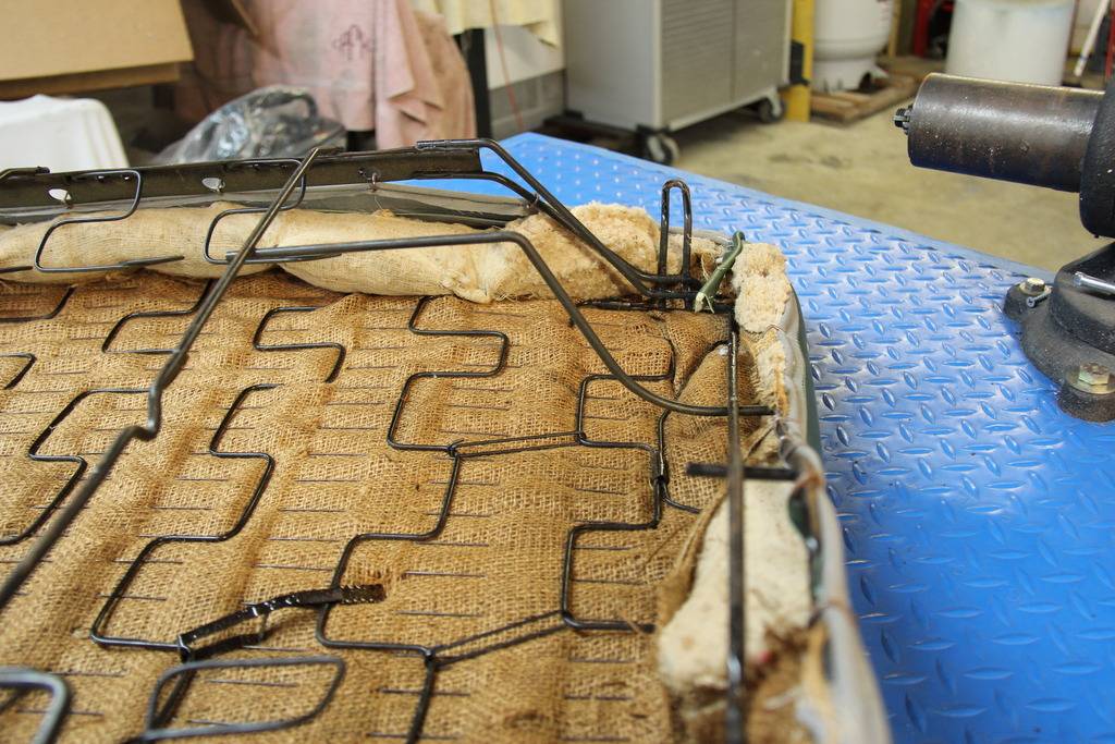

The seat needed no modification as the seat frame clearedthe wheel well.
The two tabs at the bottom of each wheel well needed to bemoved to their original location. The tabs hold the seat back down.

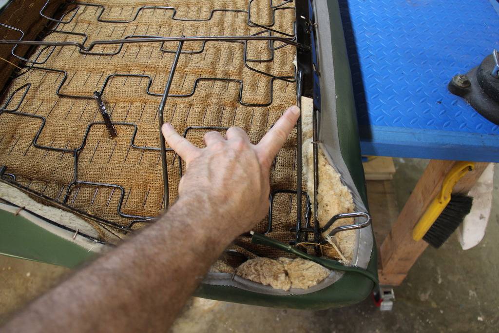

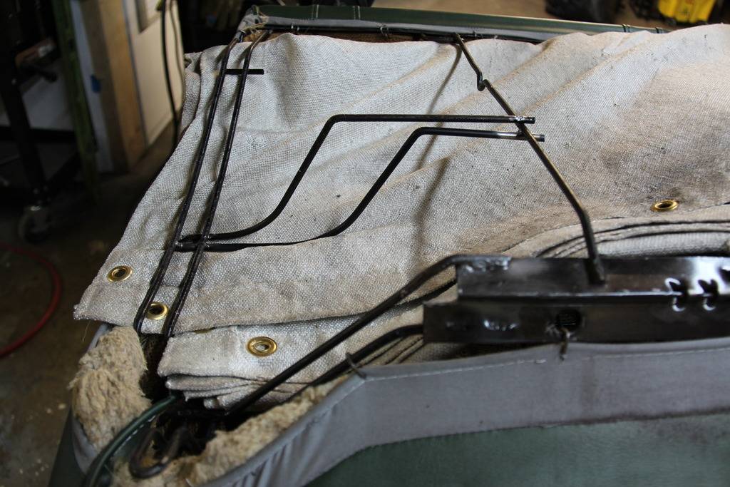

These two metal rods need to be moved in about 1 ½” on eachside to clear the wheel well.
Here you can see the 2 rods moved and the original rod toshow the difference.
Fits great just need new black seat covers.
