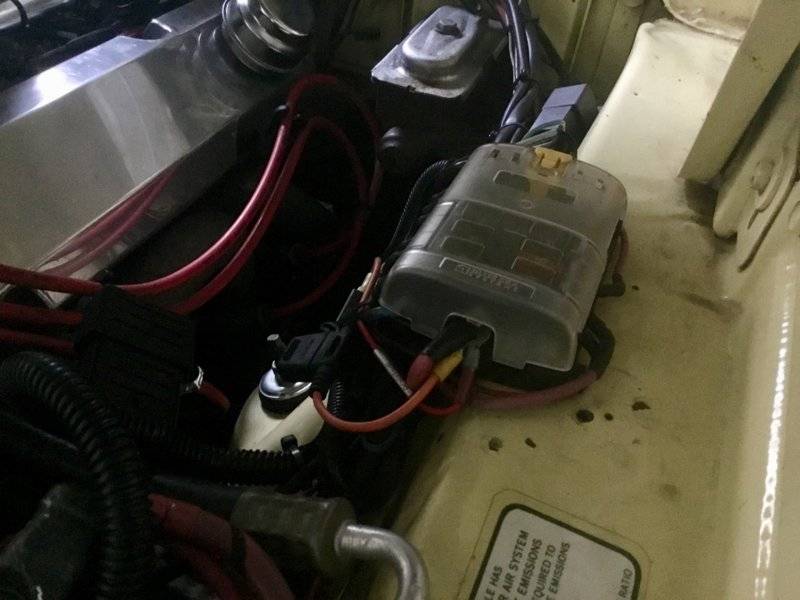

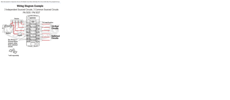

The one from YO is on the shelf. This from West Marine was a marine-grade add on. Now supporting efi, ac, pwr windows, Alpine, and a host of other electronics. Valentine One, Navigation, dash cam and on.
