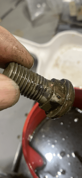

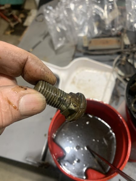

Molasses as a rust remover is awesome
Got 2 sets off wiper linkage (under dash), another set of clutch/brake pedals, and a few other misc parts in the mix right now. Been in for a week, probably give them another week before i take them out. Did 2 sets off headliner bows a few weeks ago. After hitting them with soap, water, and scotchbrite they look like brand new shiny steel.
