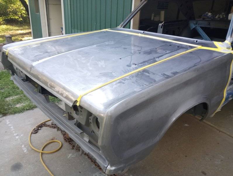

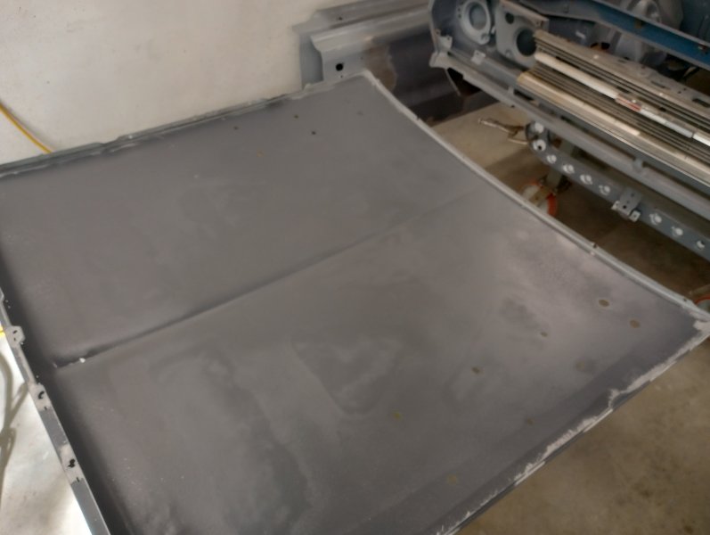

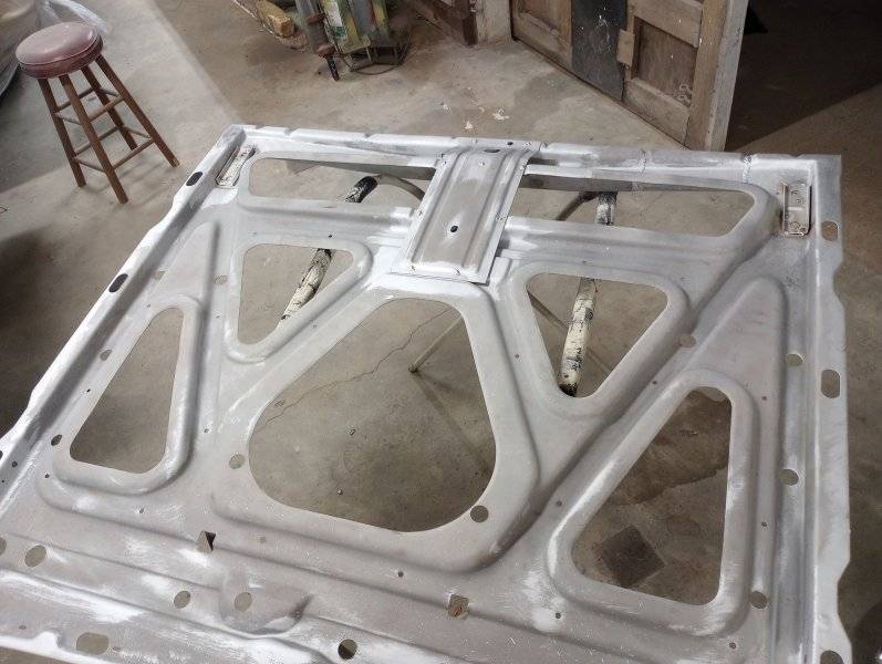

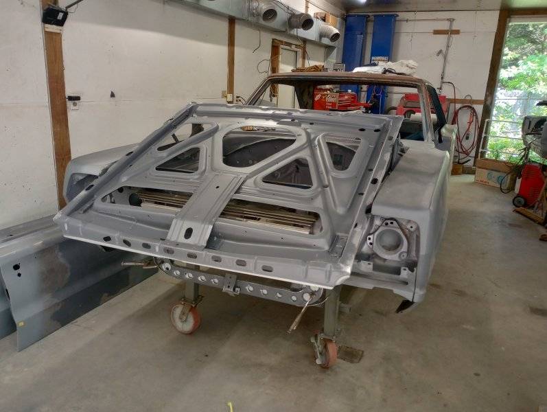

the hood is back in one piece, I sand blasted the frame and epoxied everything........ I also used ospho to clean up the topside of the hood and fenders

You really went after that rust on the hood, it looks fantastic!

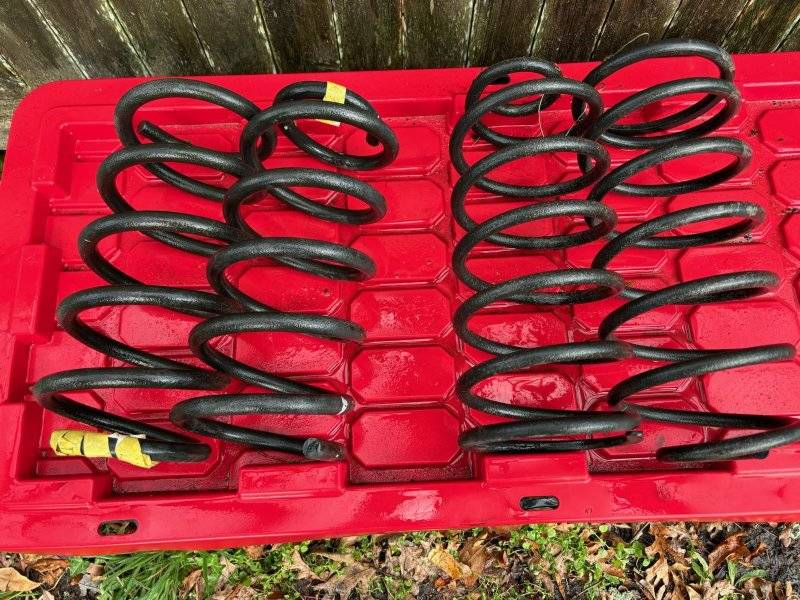

I put 4 coil springs in 3 days ago, I just popped the lid and the bubbles are back!
pulled these out today, they were crusty as balls when I put them in...... simply amazing, set it and forget it
