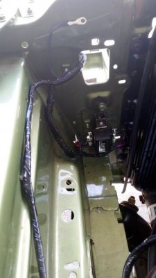

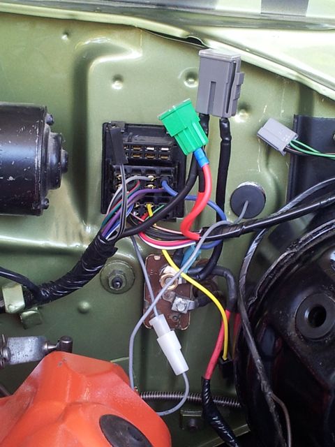

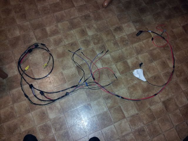

Well finally my young bloke is home on leave, so I have someone giving me a bit of a push to get out and do some more on the car. We got the new headlight wiring loom and added the extra bits for the headlight relay. Also added the wire from the alternator to the starter relay.Thanks to kiwigtx for the how to on this upgrade. :icon_thumright: Need to tidy up the wiring a bit before going anywhere though. But at least it's done now.

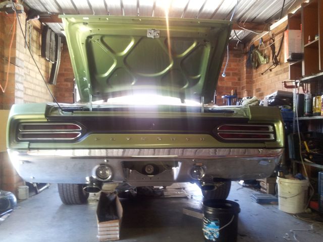

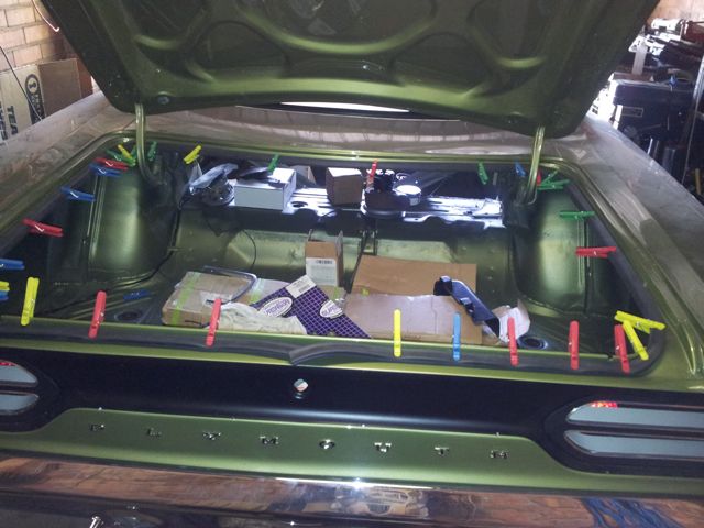

Put on some letters on the back panel and installed the trunk rubber. I'll wait till nice and dry and then cut and join up the base of it. Also put the bonnet back on, just because we wanted to see it on again. Also easier to do when there's an extra pair of hands here.

Nice work on the wiring...and thanks for the props on the upgrade (looks just like mine apart from the body colour) :headbang:
Looking great Glenn. Nice use of the pegs, take you didn't have any washing to hang on this day.
That is one tight opening to your garage, you be careful with that nice paint job . Bonnet looks fantastic mate.

I have to do my trunk weather stripping soon too, so I may be PMing you for some tips on doing it well. I hate the gluey stuff because it is so easy to do wrong and there are no chances for do overs!

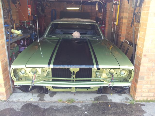

Do you plan to black out the front of your car? Chrysler blacked out lighter colors (like my Limelight, for example), but I am not sure if yours would have received it. On my car, we went overboard a bit and "over restored" the black, but I really didn't want any green showing through the grill.
Funny you should say that Tony. I actually had a couple of things hanging with the auto spring clamps I used on the roof lining. They were too tight for the rubber so I swapped over for a couple of pegs. Should have taken a photo of that. LOL

Thanks Hawk. I saw the black on your thread and I did read somewhere that the area behind the lights should be black. I'm kind of a bit toey at the moment in wanting to get the thing on the road, so I won't be changing it yet. But I will come back to it later on. A mate of mine asked me the other day what am I gonna do when it's finished? I told him I'd probably bring it back in and tackle the things that I wasn't happy with. Sometimes tinkering in the garage is just as much fun as driving.

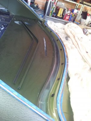

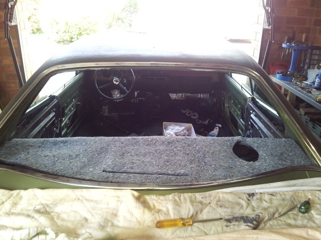

Getting ready to put the back window in. Had to install the trim clips and do a test run on the trim. Does anyone know how tight to screw the clips down. I found it almost impossible to get the trim on with the clips tight. I had to loosen them off a bit to get the trim to snap on. Is this normal? Ended up putting a couple of dings in the trim with the palm of my hand because they wouldn't click in.

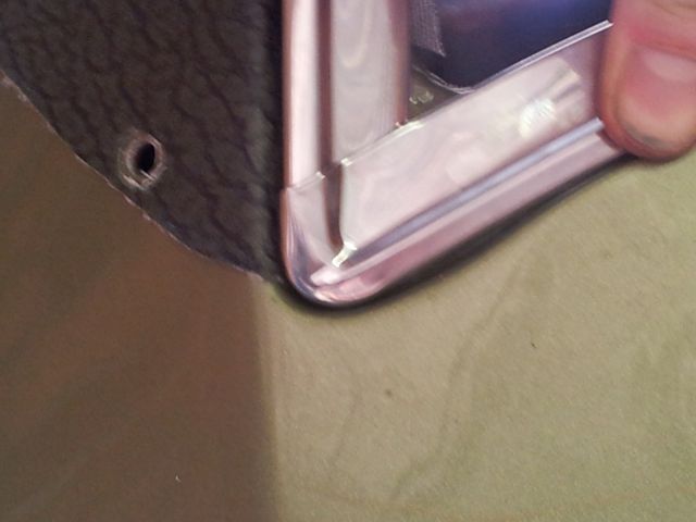

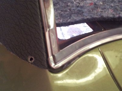

Trim clips.jpg Trim test.jpg Is there supposed to be a clip in the very bottom corner? The bottom trim sits up a bit and I was thinking that maybe it needs a clip in each corner as well to keep it down.
