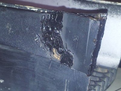

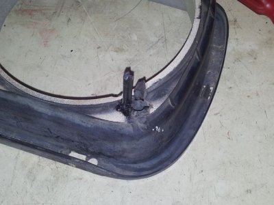

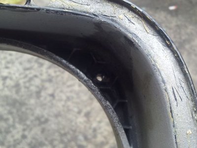

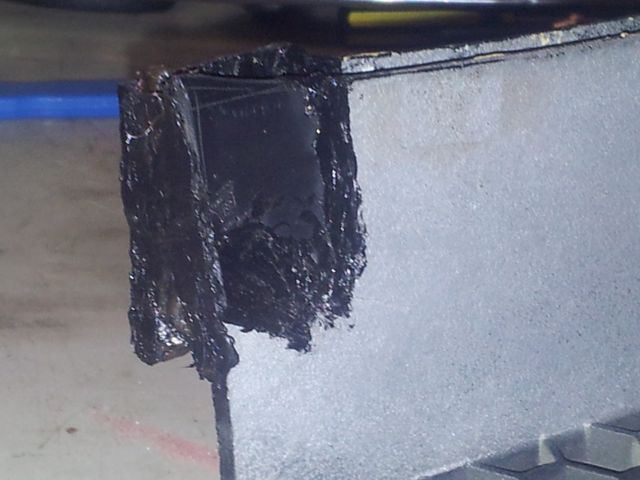

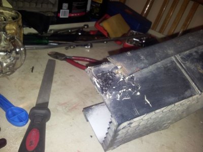

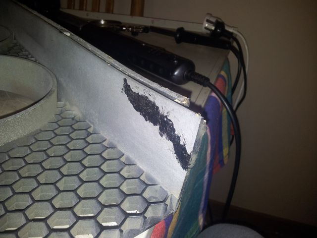

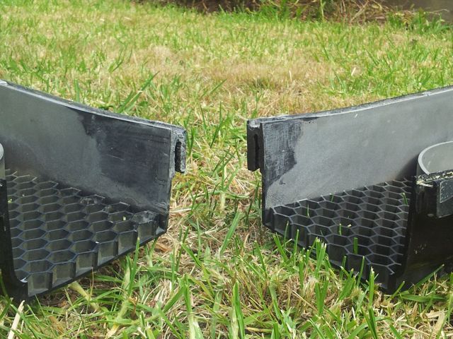

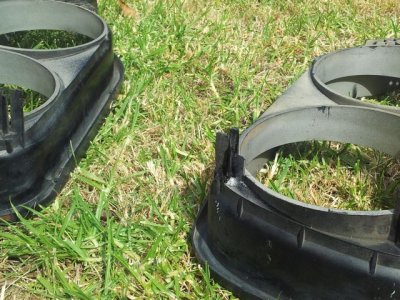

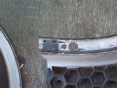

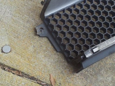

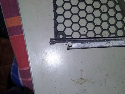

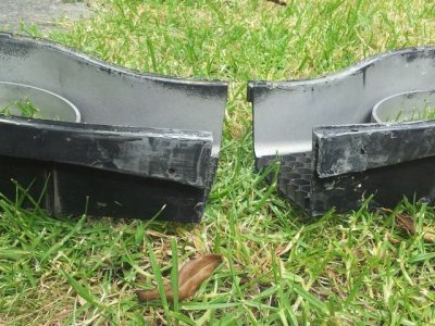

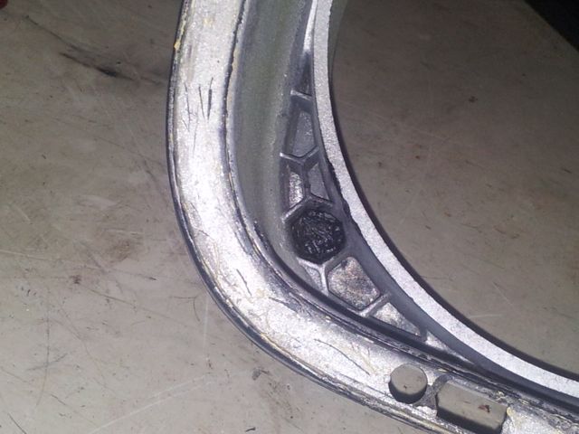

Been doing some repairs to the grille this weekend as it has suffered a bit of mistreatment in its past life. The two headlight pieces both had one of the ends broken off, one worse than the other, and one had the depth and screw guides broken on the rear as well. (I don't know what they're actually called but that'll do for now). G8.jpg G5.jpg g4.jpg G3.jpg
Cut some pieces off an old bit of car grille that I picked up from a smash repair joint. Cut them into shape and melted them together with the grille. Made sure that I got right in with the soldering iron and bonded heaps of plastic in so that I could grind and file down without taking out the repair plastic. Had to fill in the screw mount hole as the plastic there had been pulled right out at some stage. Just drilled a new hole into the repair for the screw. After cutting the end grooves with a dremel and then sanding down, they came up fairly good. Not very pretty but good enough to do the job, and I think once I repaint them they should look pretty good.

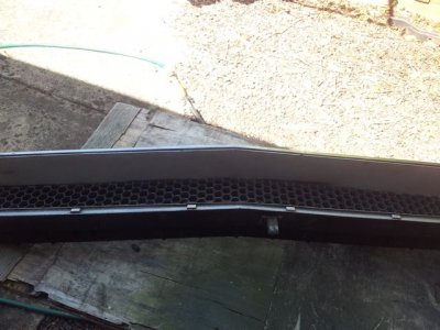

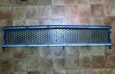

Still have to do the centre piece which has one tab at each end broken off. All pieces have a few of the stainless trim mount clips broken off so I'll have to work out what to do there. Can always silastic them on but I'd rather try to find a solution first.

Nice work so far. Good luck with that grille repair....I don't envy you with that task. The older plastics can be very difficult to 'match' to modern plastics. Lots of practice and you'll be an expert in no time. :icon_thumright:
Great job Glenn. I think your repair job looks very good.
I have a little bit of grille repair to do as well, so this is great to check out. I tried some repairs on my dash bezel, but it took me several tries to get it looking decent. To be honest, I am scared to try the plastic repairs, but maybe I just have to dive in and go for it.
Thanks for posting the detailed pictures!

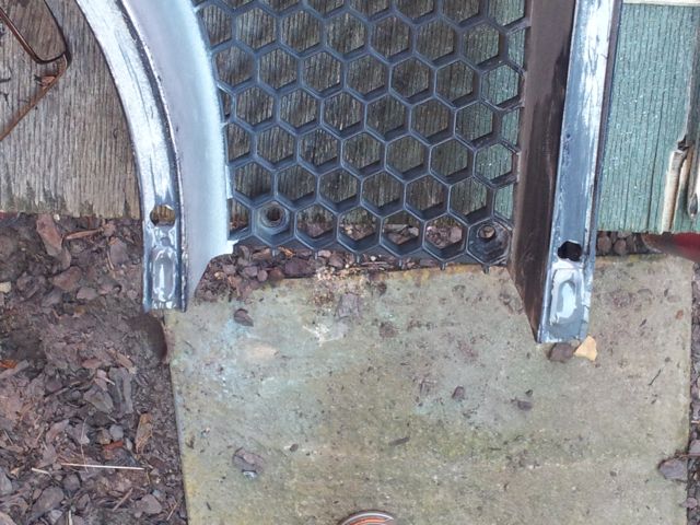

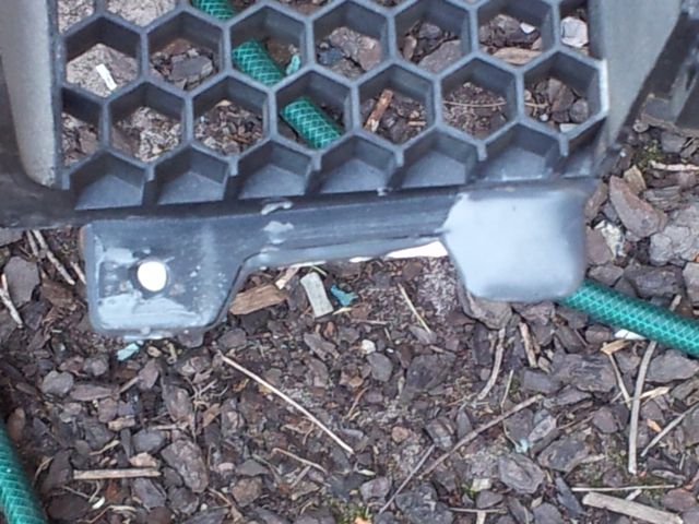

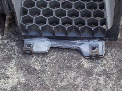

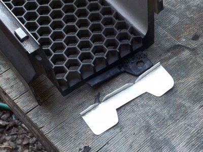

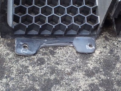

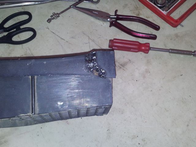

The last couple of days I've been repairing the tabs on the grill centre piece. Took mikeyfrano's lead and used some JB Weld on some metal pieces I had laying around. That stuff works pretty good. I bonded the metal to the plastic after mixing the compounds and then let the paste sit for 10 minutes or so and built up the tab section. Leaving it to cure for a bit leaves it not so runny, and easier to shape.
I went off the position of the existing tab instead of placing the outer grille pieces on and measuring from them. The hole on the bottom tab is a bit further in than the top one. I should have made the tab sit a bit further toward the edge. But luckily after drilling the hole, it still connects up ok. Even though the hole is close to the edge it should still be strong enough because of the metal backing plate.
Once I give it a final clean up it'll be ready for painting. But before that I'm going to see if I can do something about the moulding clips that are broken.

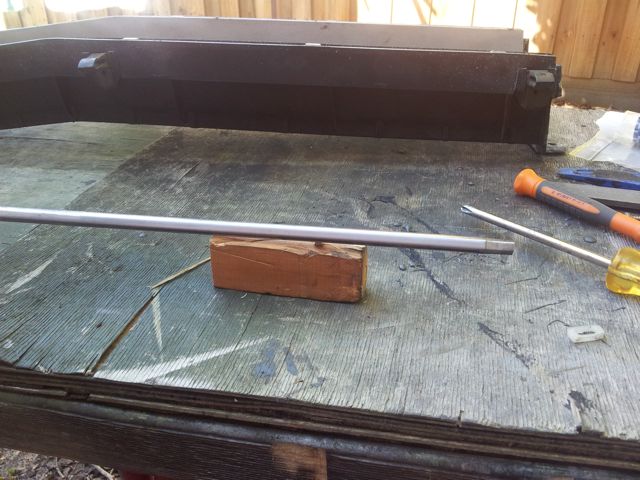

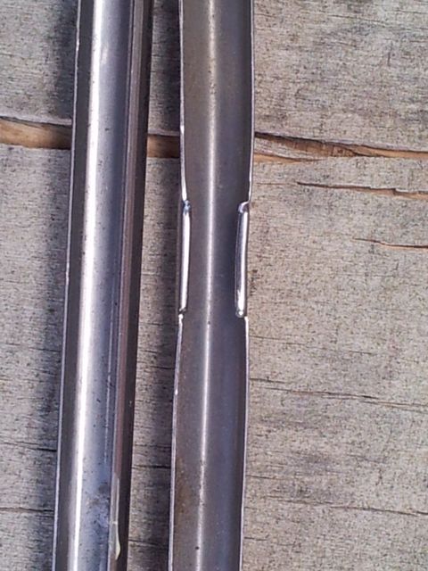

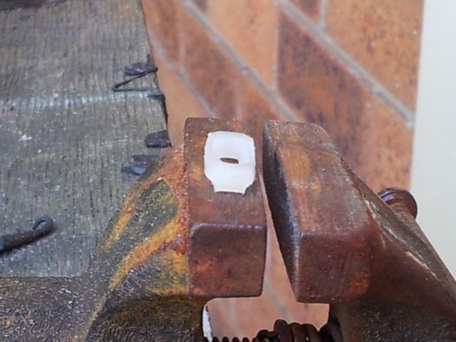

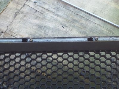

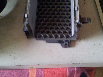

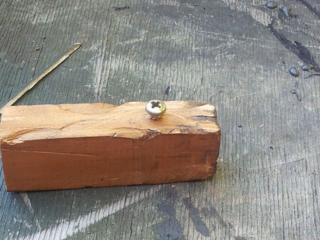

Little bit further into the grille repairs. The centre piece had two of the trim clips broken that needed replacing. Because it still had good anchor points either side of the broken ones, I decided to just put a couple of screws into it. I placed a screw into a piece of timber and then filed the sides and filed an angle underneath until the trim clicked firmly over the screw. Once it clicked on firmly, but not hard enough to distort the moulding, I screwed it into the grille. Sits pretty good, nice and firm.

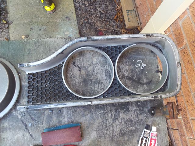

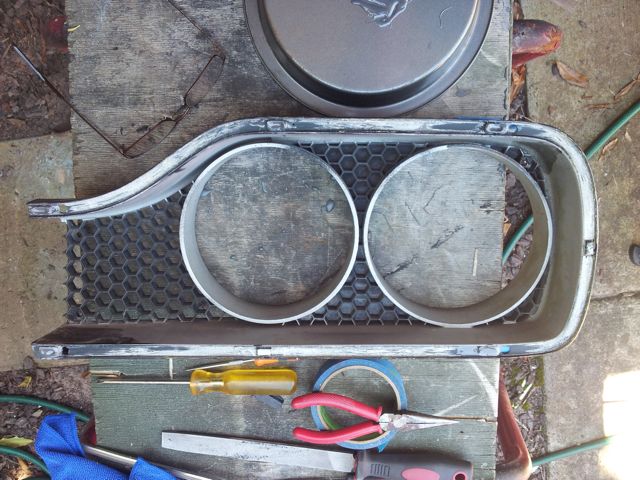

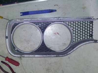

The molding on the L and R end grille pieces is different than the centre piece so I didn't feel that screws would work very well. You pretty much have to put something where the old clips had been. The centre grille molding is on the left of the pic and the headlight molding is on the right. I had some clips from an old holden of the same era that were about the same height but a little wider. I trimmed them down with the good ole dremel and carved an angle into 'em so that the molding would lock onto them.

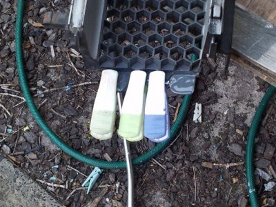

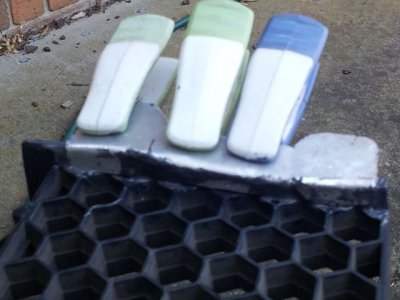

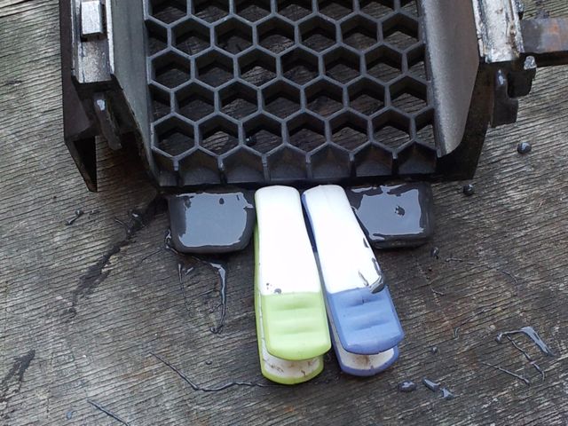

I roughed up the areas as best I could to help with the bonding and then got out the JB weld again. At the moment I'm waiting for everything to firm up enough so that I can scrape out the JB from the sides of the clips before it hardens otherwise I don't think that I'll be able to get a file in to put the finishing touches for fitting.
This one was the worst of the headlight grilles, and needed 5 clips repaired. Not really sure how well this will work so I'll wait till it all dries and see how the molding fits on before I try the other one. To be honest I'm not overly confident that they'll be strong enough but I'll soon find out. Will post the results soon. :icon_scratch:
