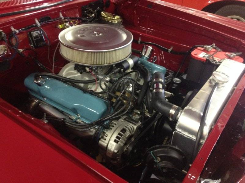

For the last 10 years I’ve been running a .030 over 383 with an Eagle 3.9” stroke crank, Eagle 6.760” H-beam rods, J&E #258035 forged pistons, with 84cc Edelbrock heads in my 65 Belvedere. Couldn’t be happier, revs quick, runs like a raped ape.
