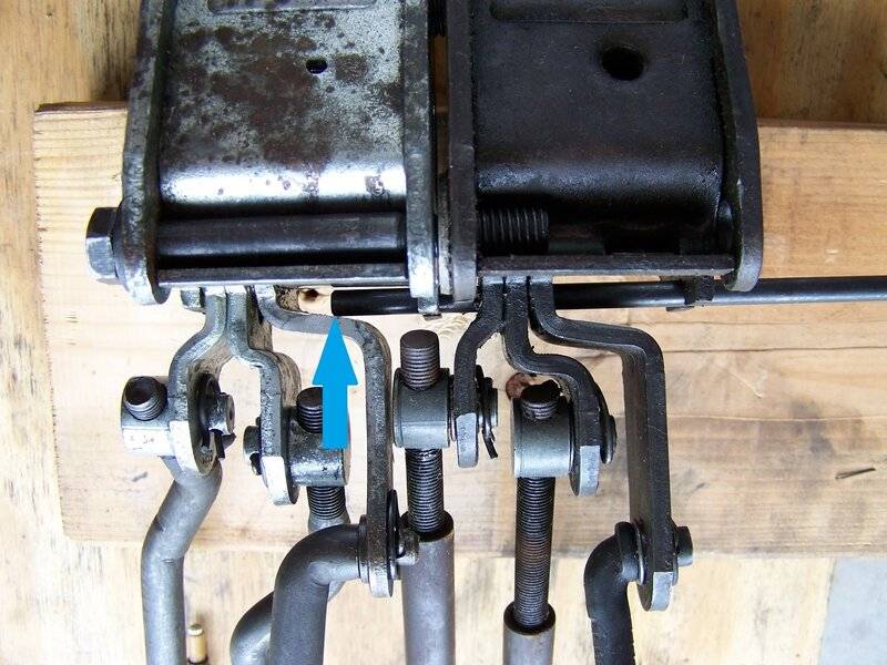

Looking for this tool to align shifter.Thanks.
I was also wondering if that tool is still available.
The reverse lever on my factor shifter #6353 does not have an alignment hole.
Just the 1/2 and 3/4 levers are drilled.
The picture shows a aftermarket Hurst Competition Plus shifter on the right, which the reverse lever is drilled. The one on the left is the factory Hurst shifter #6353, which the reverse levers were not drilled.
The picture shows a aftermarket Hurst Competition Plus shifter on the right, which the reverse lever is drilled. The one on the left is a factory Hurst shifter. which the reverse levers were not drilled.
Yes.This is what I have as well.No hole in the reverse to put anything through all three to line them up. Thanks.

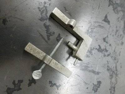

Somehow you have a pic of my tool on my work bench :poke:. I do use it, but agree with the others that it surely isn't necessary. I have seen them come up on ebay before. C-3951 if you need the #.

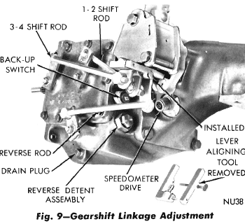

Someone sent me this pic on a post I had last month on how to align the shifter arms. Im trying to find one.Thanks.
I see. It works just as well if you pull all 3 levers back so they are flush with the notch in the shifter housing. Then you don't have to worry about the missing hole in the one lever.
