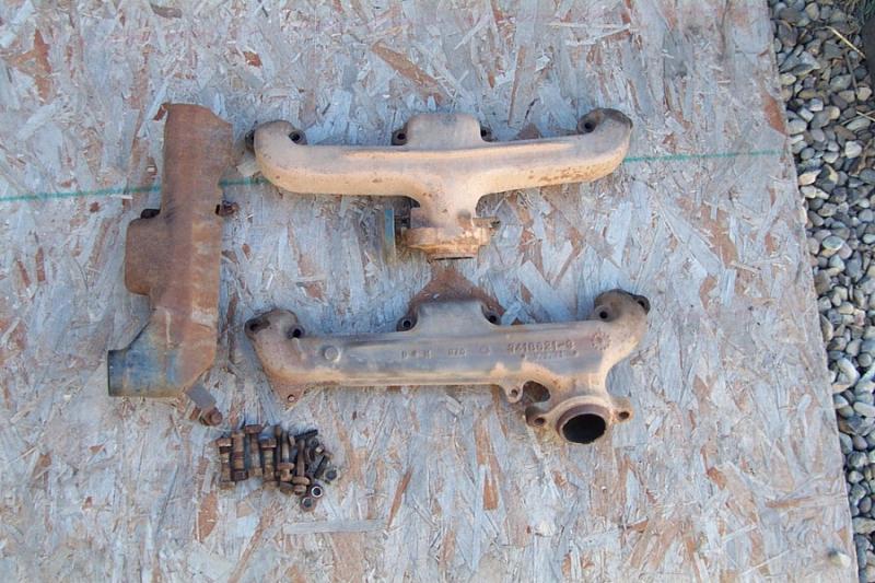

The easiest and cheapest factory ones to find will be the correct 71-4 B/E 3418621/623. The 623 also fits 71-3 A-body.
I may have some 623 but think I'm out of the 621
Thanks Mark I have seen a bunch of those, but I hear the hp flows much better. I have seen a local ad for a pair from a 68? for $400. I figures a good set of headers would be around the same $$ and won't worry about getting my tubes flatend....LOL
