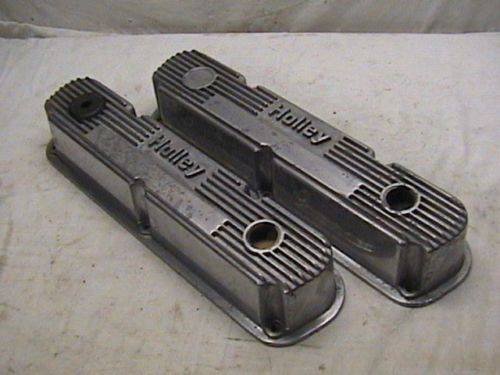

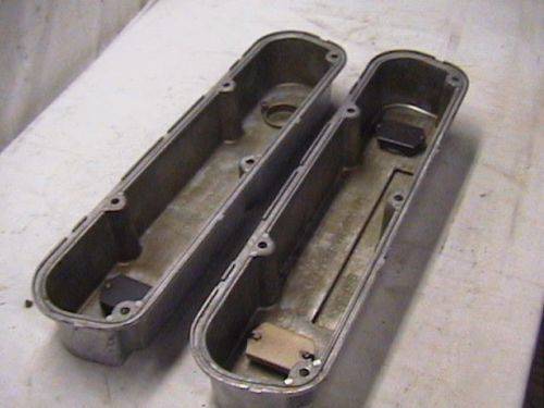

Like previously stated, need to knock out the blanks and install your pcv valve / breather. I found these old Holley valve cover pics as an example. This person installed baffles in every opening. You wouldn't do that over the oil fill.

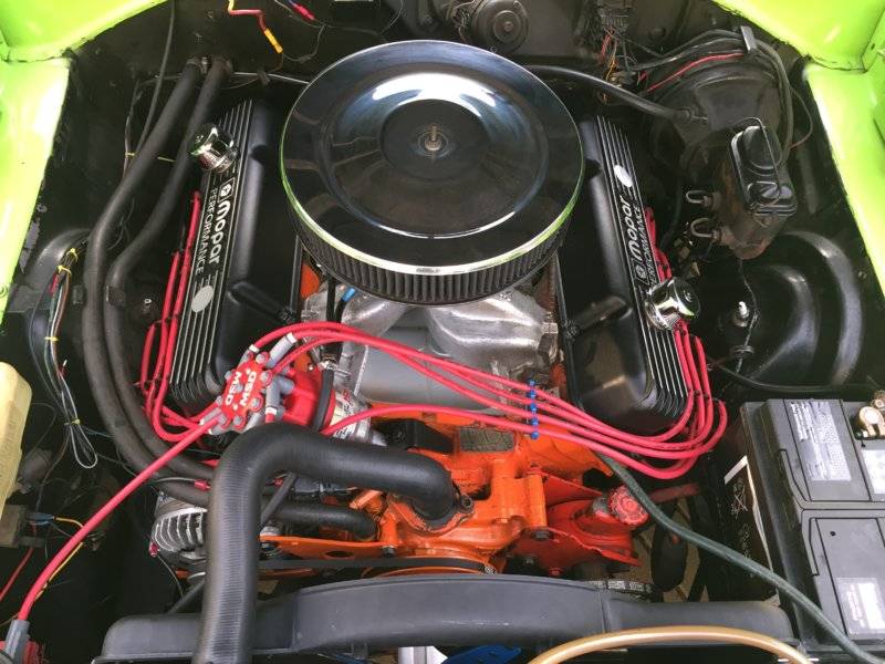

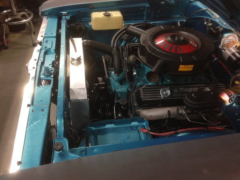

I hope you're using headers. I couldn't install mine with hp manifolds.
I "test fitted" the HP manifolds and the fit but the right side manifold is just a gnats *** away from the valve cover. Likely to get hot.
Need to decide whether or not to change valve covers.
When I had the MP V/C's on the GTX with HP manifolds, they were fine. Just make sure the gasket isnt sticking out and touching the manifold
For some reason my right manifold is angled tight to the chrome cover. No room for the nice new MP covers i picked up.

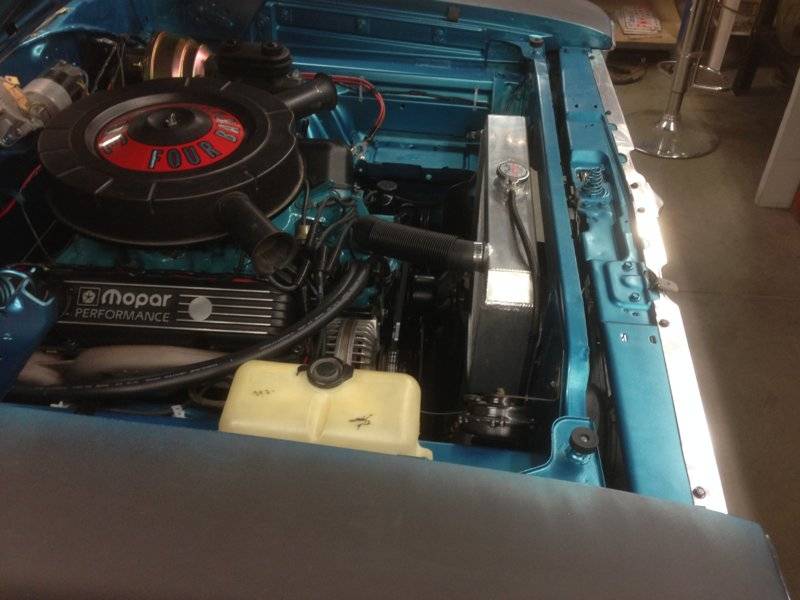

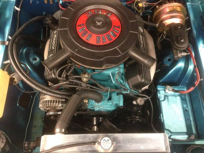

On the picture i have to screw in type breathers, but after i changed the setup for better crankcase vent.

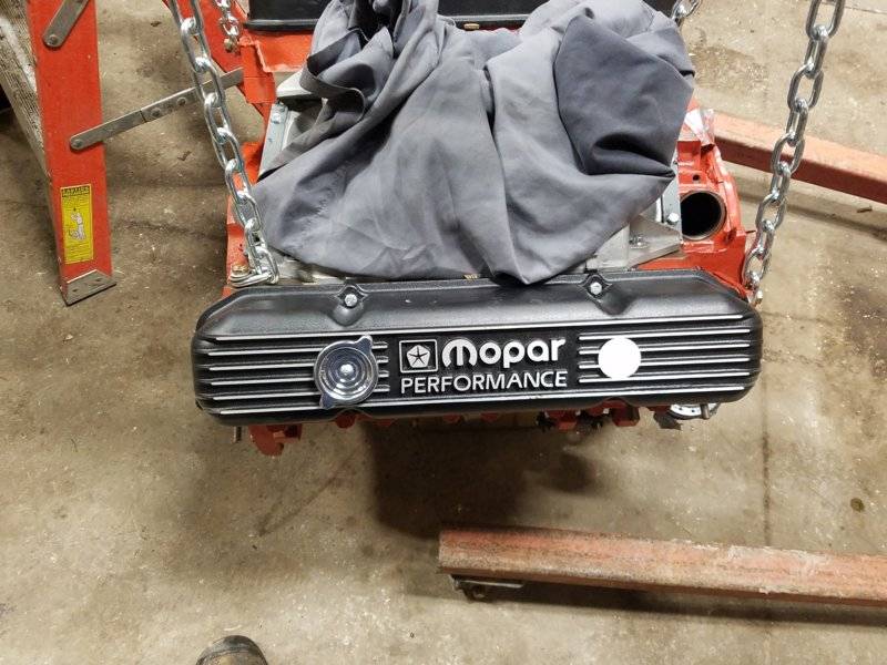

I installed a filler cap on the driver side (front) and knocked out the blank on the rear side and installed a vent valve there, so all air is vented from passenger side in and sucked out on the driver side.
I put this set on my 440 yesterday.
First of all, I had a heck of a time getting the two bottom bolts on each cover in. They wanted to get too close to the cover and couldn't get a socket or wrench on them. Has anybody else had trouble.
Also, there's no place for a breather, how's the motor supposed to vent, do I need to remove one of them and drill a hole?

Typical Mopar move for discontinuing one of the items needed for the install. You will have to figure out what to do for the grommets. For sure you need to get a baffle on the back sides of the holes you have, especially the PCV one, otherwise you will suck the oil out of the engine and end up with your personal "Holiday Fogger" when its running.
My rocker covers were supplied with a baffle plate in each cover.
It was originally installed under the screw in type holes where i put my filler plug.
After i removed the blank for the PCV valve i moved the baffle plate over to the PCV location as the baffle can be installed on either side.

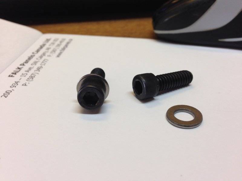

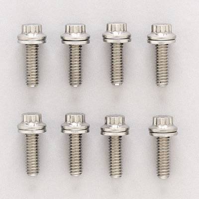

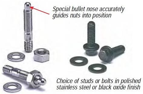

You can use studs, bolts with the small heads, or allen-head bolts and a washer as mentioned above. Here are a few photos from ARP.
