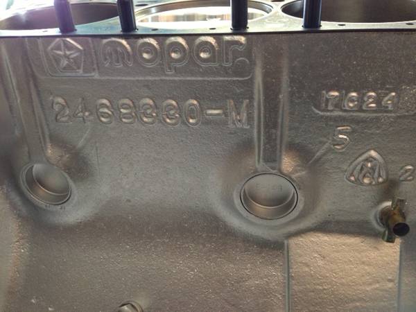

Update, seller sent me some pics of the block - it had a tag on it with p/n 4532568 which supersedes to P5153944

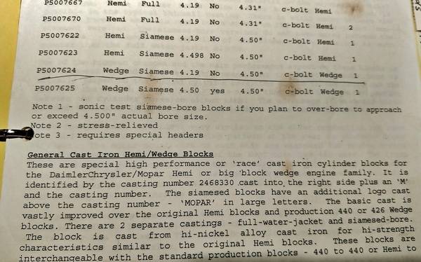

I have a 1997 Mopar Performance catalog. None of those numbers are in it from your update. The number P5249346 is shown as a 2 bolt main Siamesed Bores.It is rough bored to 4.20 stock deck approved for NHRA Super Stock.

So the "MOPAR" logo above the casting numbers means siamesed Bore, not full water bores, interesting.
