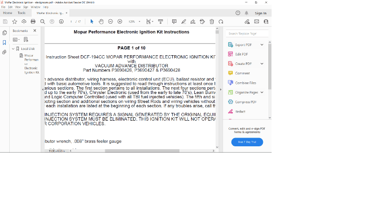

Here's a copy of the original instructions from Direct Connection back in the day.....
  • Direct Connection Electronic Ignition Conversion Installation I.pdf
Newest most bestest latest but still the same thing version.......
  • Mopar Electronic Ignition System Instructions.pdf
