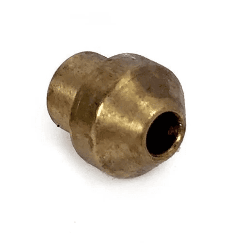

I did look inside and saw something like that yes. It looks like I solved that problem. Maybe it was not going in straight. I took the line out, held it straight and tightened the nut. Its not moving in and out anymore and its not leaking.Maybe something like this is missing in the masterView attachment 1875815
