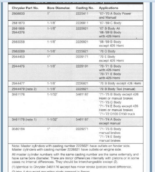

Master bore sizes, sorry hard to read.

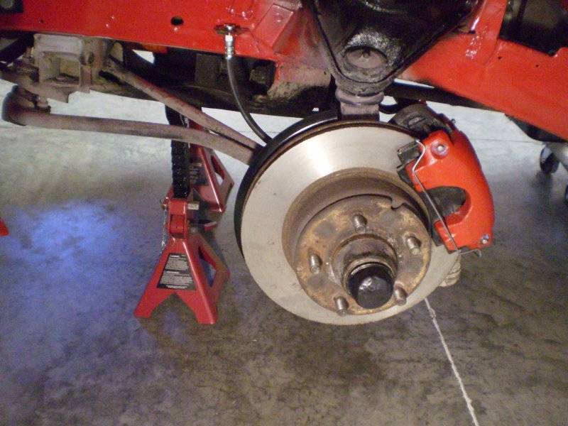

Here is my set-up on my 1964 Polara. I got the parts off a 1970 RoadRunner.

Parts catalogs have been rewritten with tons of substitute part numbers who knows if they want to sell you a 1 1/8 M/C when OE was 1"....be 100% sure to avoid the CPP brand chinesium brake boosters...
