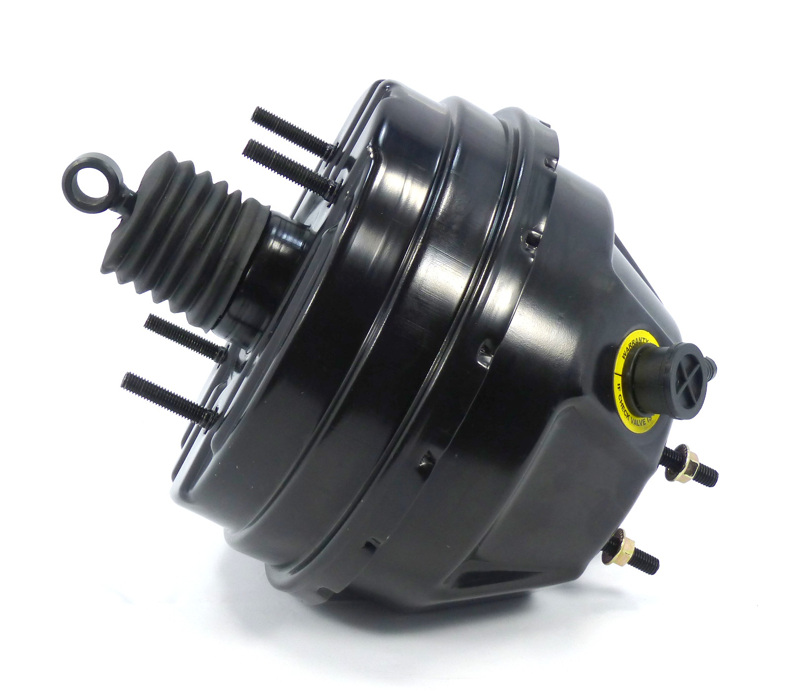

Next question... Booster? Discs need a lot of pressure so at the very least small bore M/C

My choice would be a Bendix Dual Diaphragm Booster & a 1" bore M/C... This style booster
I have no experience with this style Chinese booster & while skeptical Kern bought one & it's part of what got his brakes working right finally...
