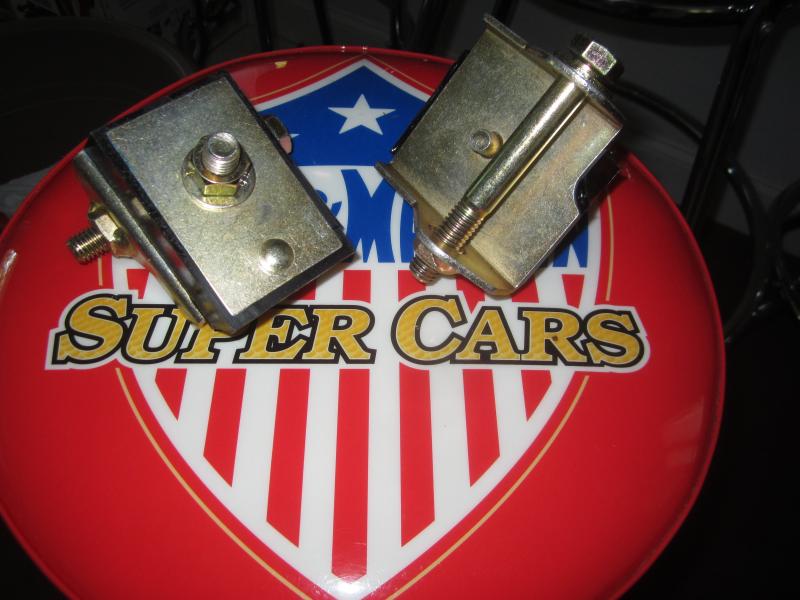

Schumacher interlockers.
I just replaced my set of worn rubber mounts. I first installed a set of Shumacher Poly Loc mounts. They are a quality made product, the problem I had with them is the amount of vibration they transferred into the chassis of my car. I kept them in the car for a 10 mile drive and replaced them with a set of Mitymounts. These are a rubber reinforced set, similar to the Poly Locs, but with rubber instead of polyurethane. After installation, no vibrations like the Poly Locs had created. If you have a high output engine and like your burnouts and hard launches, go with the Schumacher mounts, otherwise I would recommend the Mitymounts. PS, if you decide to go with the Schumacher mounts they are out of stock right now, but I have a lightly used set I am looking to sell. PM me if interested.....
