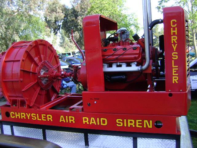

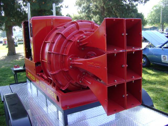

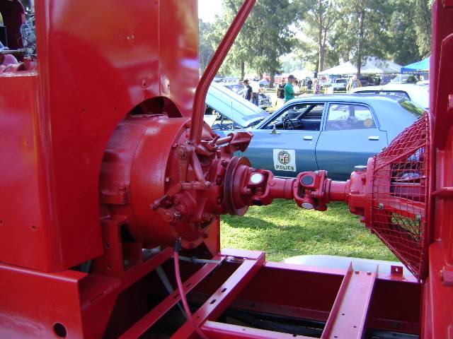

There are many, many applications for these engines, and always have been. There used to be a Generac, yes Generac generator that used a V-6 from a Sebring, IIRC. They used to make a Hemi powered siren.... What mounts did these use lol?? Just depends on whats shaking, and what the engineers think at the given time.
