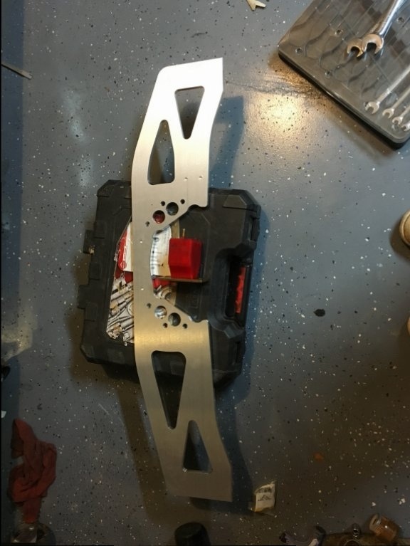

Well I went ahead and bought an AR engineering 3/8" plate. It is profiled with triangles cut outs. I bought a 1/8" spacer for the crank and will use my 1/4" milled water pump.. To keep everything lined up.
Awesome!
Michael Doty makes a great low mount alternator kit. DMI is, I think, the name of the company...
I lost his info.
Looks nice only complaint is it's got a couple scratch/dings and the back is covered in the material info.

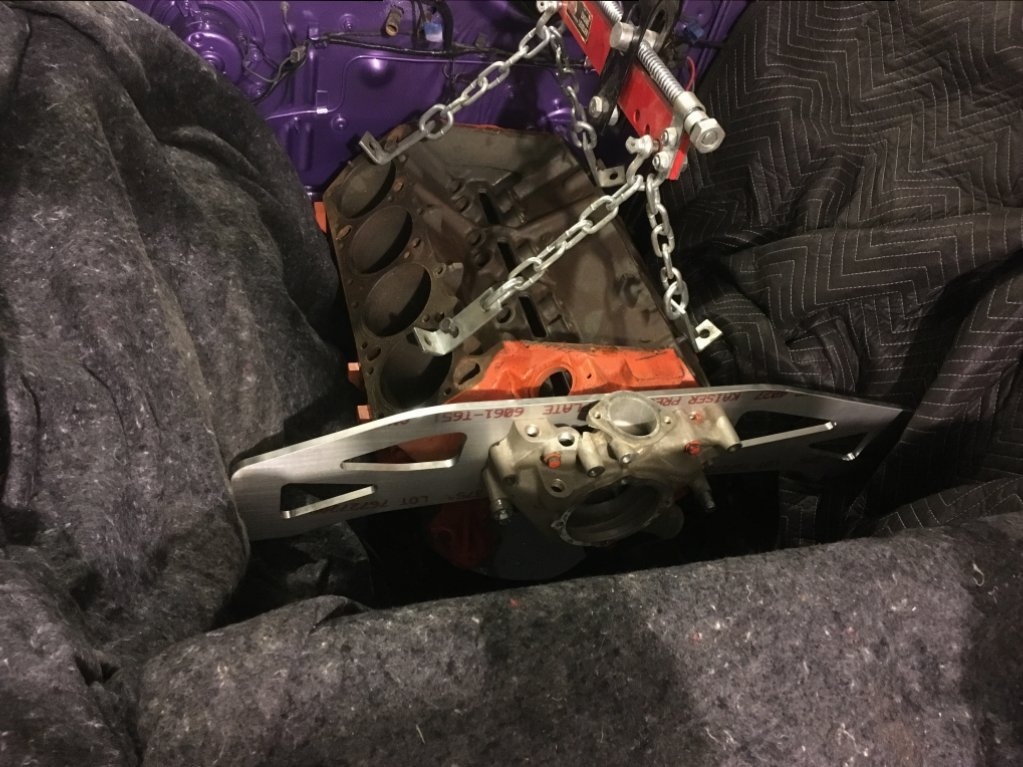

I think I'm doing this right? I put a bare block in using the motor mounts and then installed the plate. I don't have the tranny in but kept it parallel to the fenders.
I'm in the middle of the same thing right now. What I did was put the trans in with the mount to get a location of where the motor should be, bolted up the belhousing to the engine and marked where my mounts should be. With these plates it does a good job putting the engine in the right spot left to right, but without having the trans where it should be, you might be setting yourself up for failure.
Thats kinda what I figured out after I got the engine in there. I don't want to screw it up now that I'm this far along. I'm going to get the tranny in there and I think i'm going to put the actual motor in there just to be safe after reading your post.
